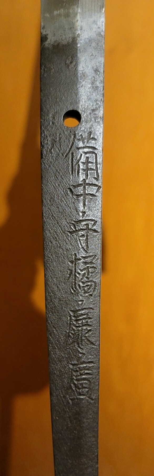

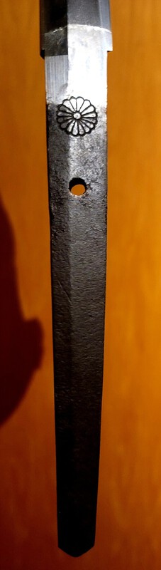

This falls bit off my interest as I am into early swords,  I don't have too much study material on these newer swords as they are not my focus. However I got intrested in this and took a look, and I am not exactly sure of the result. Someone more skilled in Japanese can make corrections.
Here is history part of the Jūyō 42 katana entry - and my rough translation.
備中守康広は, 富田五郎左衛門といい, 紀州石堂派を代表する刀工で, のちに紀州から大坂に移り, 大坂石堂派の始祖となっている.
作風は, 御家芸ともいうべき備前伝で映りの立った鍛えに, 丁子乱れを得意としている.
銘文は, 初期には (於紀州康広), 或は (紀伊国康広) などときり, また (紀伊国當一康広) と當一を冠するものもある.
備中守を受領してからは, 表裏に銘をきり分けたり, この作に見られるように裏に菊紋を刻している
Bitchū no Kami Yasuhiro was Tomita Gorōzaemon, swordsmith from Kishū Ishidō school. He later moved from Kishū to Ōsaka and founded Ōsaka Ishidō school.
He is very skilled in Bizen style chōji midare and utsuri.
Early signature styles were (於紀州康広) and (紀伊国康広) [This next part is relevant for the sword in question but I can't quite understand it], there is also style of signature (紀伊国當一康広).
After receiving the title Bitchū no Kami, signature is now on both sides and Kikumon is engraved on to the back as seen in this work.
For the mei, the early inscriptions are Oite Kishū Yasuhiro, or Kii-no-kuni Yasuhiro, and sometimes including the prefix "Tōichi" (Kii-no-kuni Tōichi Yasuhiro).
