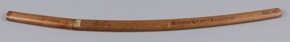

Catalogue number 2379, previously discussed mismatched saya and blade:

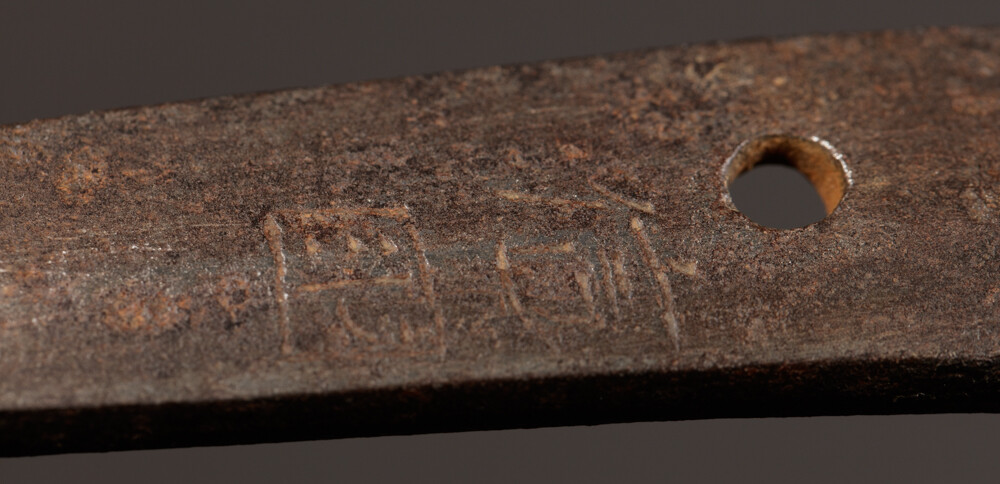

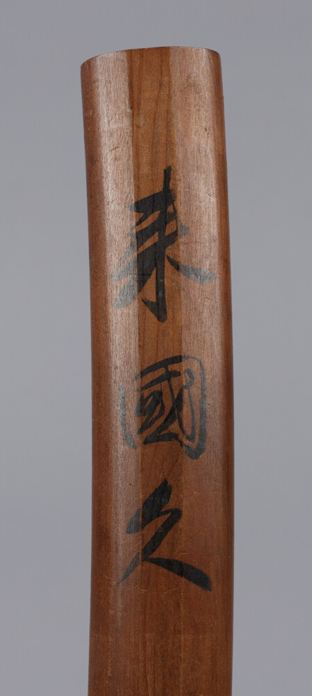

2380 reads 来國久 Rai Kunihisa
We're questioning how genuine it is. Any ideas on age etc? Thanks
On 6/18/2021 at 3:37 AM, Tom Darling said:
Hi Eve,  the Rai Kunihisa is not good.
Hi Tom,
Thanks for the info. Sorry to be a pain but can I please ask for more details? Like how you can tell? We're generalists trying our best to get this right and there's only so much help from reading articles on the net - we just don't have the experience.

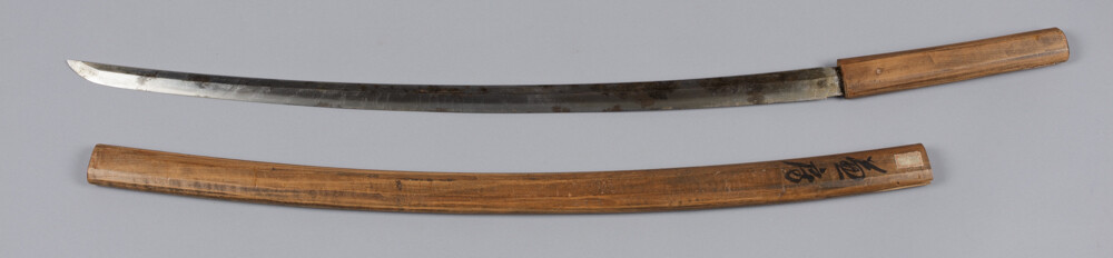

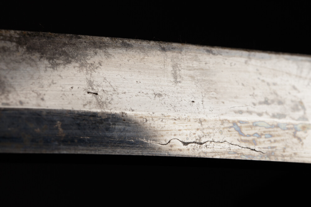

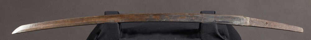

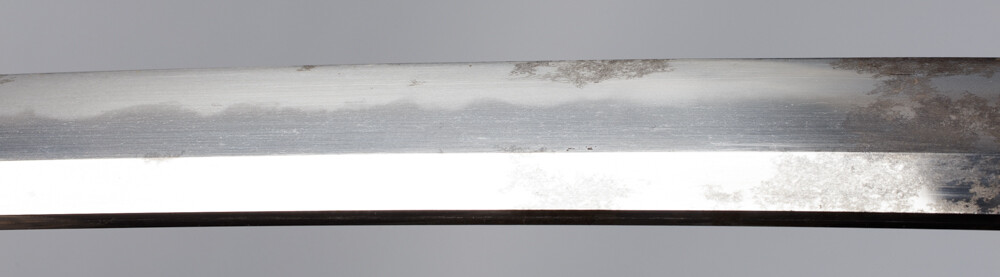

Eve et al -
Different Tom here - proper judgement of a blade needs to be done in hand - that being said there are lots of folks that will try to tell you what you have from photographs - it really is an exercise in futility - but  there are some things that can be said with certainty based on your photos.
So here I go out on the limb. Based on what we can see - and I preface all of these comments with this - your first blade is signed Nobukuni but it is badly executed most likely a later addition most likely gimei - the shape and finish of the nakago are wrong for the smith and his time period - what we see of hamon and hada are not good - if it has hamon it looks to be saiha to my eye - combined with the deep curve you may be looking at a re-tempered blade.
The next blade 2380 is signed Rai Kunihisa - the signature is badly cut, is in the wrong spot on the tang and is no match for this smith - the shape and finish of the tang are wrong - I would say the shape also suggests later manufacture -  the hamon we can see looks like it was enhanced by some kind of acid application and I suspect is not a good match for Rai work.

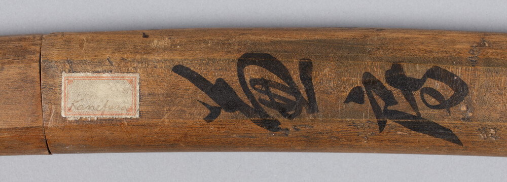

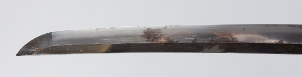

2381 holds the most hope - the saya says Kanefusa but it is of course osuriage mumei - to my knowledge in its pristine shape this would have been an exceptionally long blade for this smith given his timeframe - the hada and hamon suggest that this blade can be polished and may make a fine restoration - barring any flaws we cannot see in the photos at hand - the hamon that we can see does not have the signature look of Kanefusa work but if this were an early work the trademark pattern may not have taken hold yet and this could be a piece inspired by earlier artists in his lineage.
Whats curious is that they have all found their way into shirasaya but are in the worst possible state of preservation - they look more like they were sitting out in the sun, dirt and the dust rather than being stored away after a proper polish - would be interested to learn how they came to be this way.
What you have is not garbage but not treasure either - if there is hope for these they need to be under the nose of someone with the knowledge to see what they were and what they can become...
my humble opinion only,
-t

I really appreciate your insight on these. We had deduced that the Rai Kunihisa was likely gimei. We have exactly one Japanese lady who lives in town so that gave us a start in our research. The photos I have put up do show the blade in the worst possible light too.

2381 - Interesting! Because of the plain nakago we had kind of guessed that it wasn't too interesting or old - shows  how much we have to learn! Do you think it was made recently or is older?
The shape of the blade and the condition of the nakago suggest earlier manufacture - now was it made in the mid-1500s the time of Kanefusa? or was it made in the Edo period and then altered to appear older? To answer that you need hands on examination - me feeling is it is older and this is the one you should be considering to restore...
