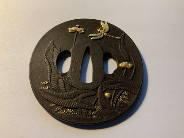

Caracal Posted March 20, 2021 Report Posted March 20, 2021 Here is my nice Tsuba by Masayoshi Masayoshi with the theme of dragonflies. The dragonfly in Japanese is tombo (蜻蛉) and in the Muromachi period kachimushi was its name (勝 虫). These characters for literally mean Victory Bug and gives us insight into how the bushi of the time admired the dragonfly. Bushi had observed the nature of the dragonfly to attack, and always move forward to the prey. 3 Quote
Caracal Posted March 20, 2021 Author Report Posted March 20, 2021 My Tsuba by Masayoshi Can you help me, my question is which school can it be .... // Robert Quote
vajo Posted March 20, 2021 Report Posted March 20, 2021 There was some Masayoshi. I don't know which of them. The iron looks very grainy. Quote
Soshin Posted March 21, 2021 Report Posted March 21, 2021 Hello Robert, The iron does look grainy in appearance, but overall, it is a nice tsuba. I have always liked the design and symbolism of dragon flies in Japanese art. I have 22 artists in my references that used name Masayoshi with the Kanji "正義". Of the 22 artists seven of the artists used a cipher (kaō 花押) in addition to their signatures. Since you tsuba does not have a cipher on it along with the signature those artists can be eliminated bring the total to 15 different possible artists assuming the artist that made your tsuba is recorded or if we are dealing with a false signature (gimei 偽銘) as sometimes the cipher is left off of the signature intentionally. Sorry about not having any more helpful free information. I would send it for formal written appraisal (shinsa 審査) in Japan to get more information. Quote

Caracal Posted March 30, 2021 Author Report Posted March 30, 2021 Thank you all for your help with my NBTHK certificate and what a school it can be. It is sad that i could not get a more detailed opinion regarding school from NBTHK, there are a lot of Masayoshi ..... One thought might it be the Aizu Shoami school? Is there anyone else who can possibly give me more clues in the search? // Robert Quote
Soshin Posted March 31, 2021 Report Posted March 31, 2021 Hello Robert, Coming back to this late because I have been busy with other more pressing matters. I can confirm as others have said there is no information on the appraisal paper about Masayoshi being part of an any organized School or less organized group of artists for that matter. This may imply that Masayoshi was an independent artist. There were many of these type of artists during the Edo Period. The NBTHK paper just discusses the design, techniques used, the signature, and that the tsuba is authentic and worthy of preservation. Examining examples of the Aizu Shōami School and reading the one book I know of about that school’s work I do not think your tsuba was produced by this School, but the school's work is remarkably diverse, and it might be a possibility. Quote
Tanto54 Posted March 31, 2021 Report Posted March 31, 2021 Dear Robert, Based on @MauroP's excellent work, your guy is probably Haynes 04846.0, Family Name: Sekihara; Original Name: Koryusai; He worked in Aizu in Iwashiro Province from around 1800 -1850. He worked in the style of Aizu Shoami from the School of Masamitsu (Haynes 04186) 1 Quote
