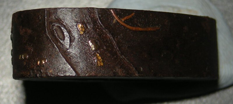

Can anyone tell me if they recognise the style of this work at all.
It is in Iron with Mixed metal carvings inlaid and overlaid.
It is not signed but looks well done.
I would appreciate any ideas you have.
Many thanks
Shan

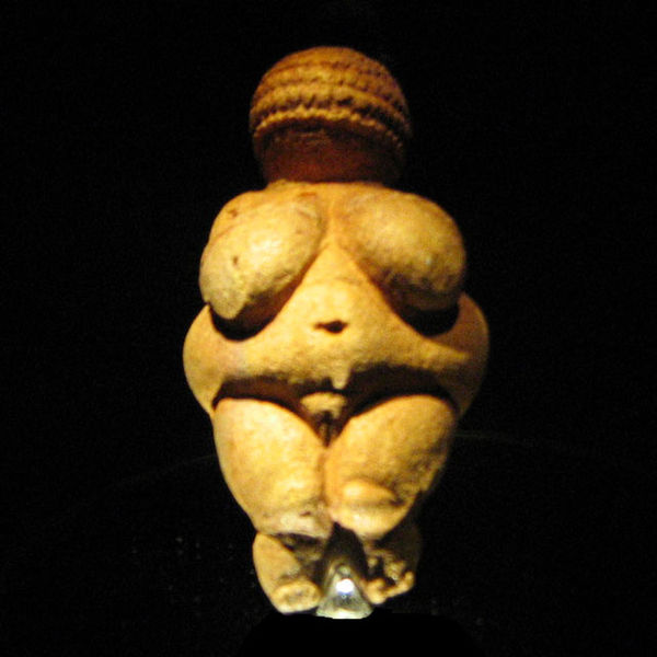

I may agree with you to a point on butterflies...but I think I could show you some by later artists ( both Edo and Meiji ) that are quite beautiful. With most work though, we're talking about stylistic conventions that were common at a particular time. The degree of skill in the work can be objectively judged, as you agree, and the matter of whether you personally like it is yours to make. Consider the Venus of Villendorf; as an accurate depiction of a woman it's not very accurate but it was not likely that it was intended to be...and yet it continues to enchant the modern eye and most probably in ways that the maker never imagined or intended either.

p.s. I only posted this reply so that I could sneakily work in a reference to this statuette and so be the first person to post a nude on the forum :badgrin: ...thought you'd appreciate that Milt ;)

Ford, that may enchant you, but i seriously doubt you'll share( willingly ) the same bed.

Hi Ford, I think that is an accurate depiction of a gravid woman. It is after all a fertility fetish. All the features of a fertile woman reproducing and producing milk. I think a few women may have had this figure after a few babes 20 centuries ago. :lol: John
Dear Shan
We seem to have rather lost the thread of your enquiry re the iron fushi-gashira. OK, so they are not special, but iron pairs are relatively uncommon, for obvious reasons, and yours also have an iron - rather than the more usual copper - tenjō. The brown, soft quality of the iron is reminiscent of Tetsugendō work, a school derived from the Chōshū artists, and this may even explain the presence of the nunome cherry blossom. They may, then, be late C18 Tetsugendō work, and I wouldn’t be too cast down by adverse comments about their quality - at $150 I reckon they were a fair purchase.
Yours, John L.
