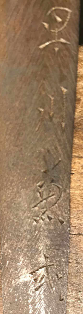

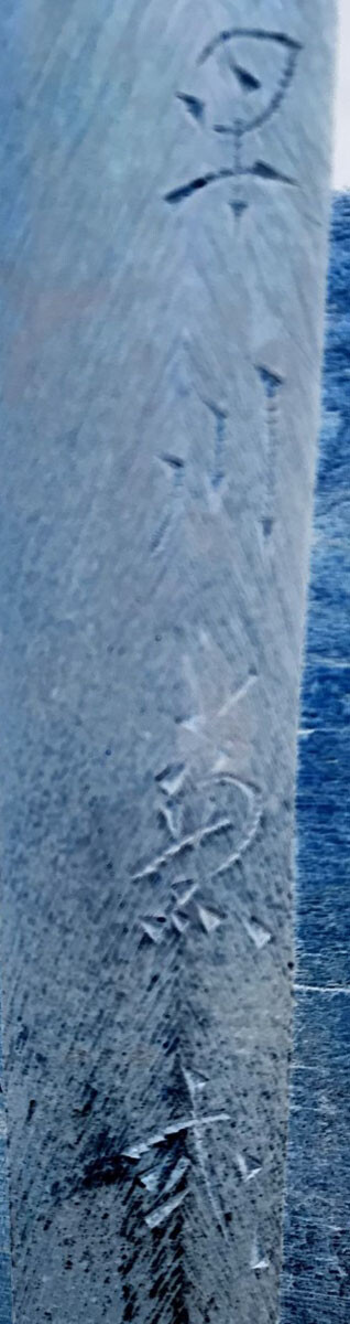

b.hennick Posted October 1, 2020 Report Posted October 1, 2020 Hello I was asked to help someone with a sword. It has a stamp that I think is the Seki stamp and is signed Kane ?? All help is appreciated. WWII blades is not my area of study. Quote
SteveM Posted October 1, 2020 Report Posted October 1, 2020 早川兼武 Hayakawa Kanetake This smith, I guess (not much information about him). He's not listed in either Jinsoo Kim's site, nor in Richard Stein's site. http://www.nipponto.co.jp/swords3/KY328042.htm 1 Quote
b.hennick Posted October 1, 2020 Author Report Posted October 1, 2020 Thanks Steve I found two smiths by that name who worked from 1926-1989. They were in Markus Sesko;s Swordsmiths of Japan Aki-Kuni. 1 Quote

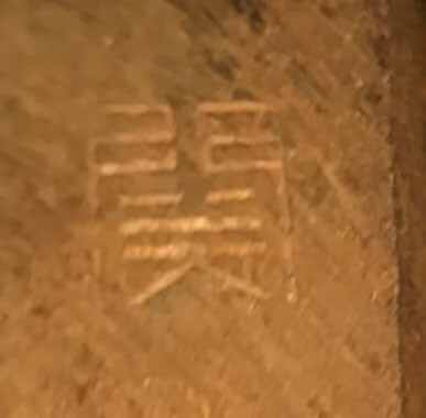

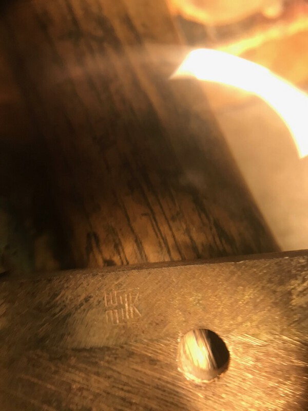

Bruce Pennington Posted October 2, 2020 Report Posted October 2, 2020 You're right on the Seki stamp, Barry. Can you show a picture of it in perspective of the nakago in size? It appears to be the large Seki. There were large ones and small ones, and little is known as to whether they mean different things. Some speculate that the larger one is of the Seki Swordsmith Guild and not an army inspection stamp, which is the small one. But I've never seen confirmation on that anywhere. To my understand, though, both are there at Army orders to indicate a blade was non-traditionally made. If the blade can be dated before 1938, which is when it is often stated (again no documentation) that the stamping was ordered, then the mark MAY not be saying "non-traditional" but simply approved by the Gild. Guys like that theory because, then, their blades may be considered nihonto, but I don't like it. Stamping started because the sword-world got tired of not knowing which swords were nihonto or showato Quote
b.hennick Posted October 2, 2020 Author Report Posted October 2, 2020 Here you are Bruce. This is the photo as I received it. Quote
Bruce Pennington Posted October 2, 2020 Report Posted October 2, 2020 Yes, the larger one. Thanks! Quote
