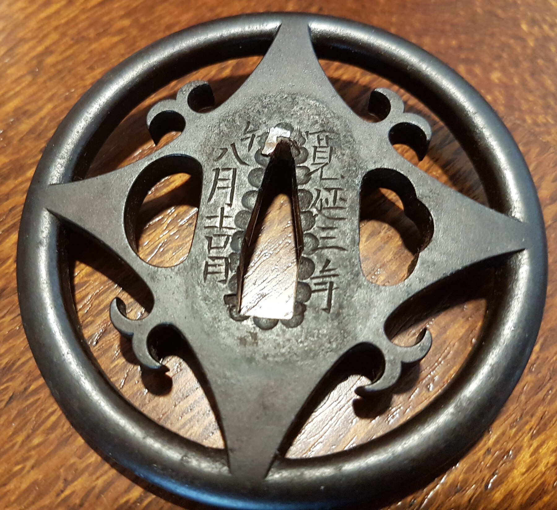

Isshu Posted September 25, 2020 Report Posted September 25, 2020 Hello all, Would someone be so kind as to translate the kanji on this tsuba please. Any additional information would also be greatly appreciated if possible. Thank you in advance John C. 2 Quote
Manuel Coden Posted September 25, 2020 Report Posted September 25, 2020 寛延三年八月吉日 Kan'en 3 (1751) August, a lucky day Quote

Bugyotsuji Posted September 25, 2020 Report Posted September 25, 2020 How does the other side look? Quote
Isshu Posted September 26, 2020 Author Report Posted September 26, 2020 Thanks for the replies. Attached is the reverse side. Regards John C. Quote
Bugyotsuji Posted September 26, 2020 Report Posted September 26, 2020 Thanks for that John. I'm not sure if I have ever seen a tsuba with a a date but no Mei. (?) Maybe I'm growing senile! Quote
Surfson Posted September 26, 2020 Report Posted September 26, 2020 I wonder if it once had a mei. Is the rough part at the seppadai lower than the rest of the plate? Quote
Manuel Coden Posted September 26, 2020 Report Posted September 26, 2020 It seems there was a mei and was removed Quote
Surfson Posted September 26, 2020 Report Posted September 26, 2020 That would be my thinking Manuel. Maybe John can tell us if the front of the tsuba is a bit carved out? If so, it would support the idea that it once had a mei. Quote
Isshu Posted September 26, 2020 Author Report Posted September 26, 2020 Having a closer look at the "mei" side of the tsuba there is a slight dip/concavity in the seppa-dai area. Any thoughts as to why a mei would be (possibly) removed from a tsuba? Thanks. John C. Quote
Manuel Coden Posted September 27, 2020 Report Posted September 27, 2020 Usually the only reason to remove a mei on a tsuba is because it's gimei Quote
