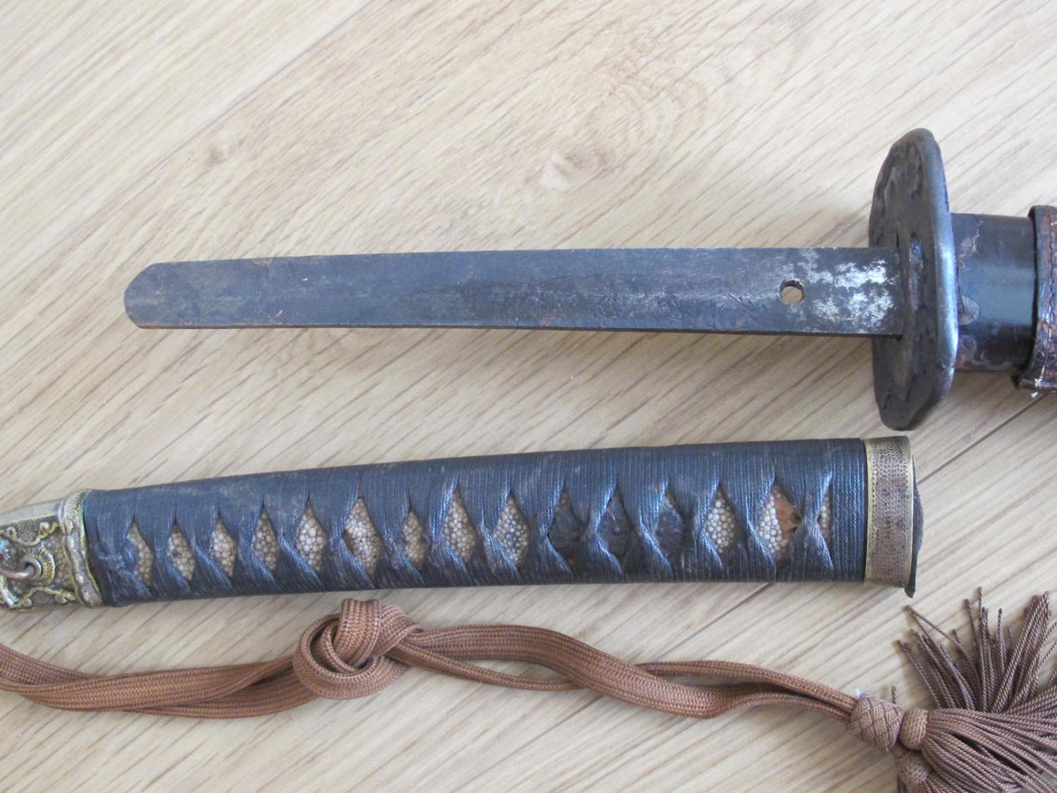

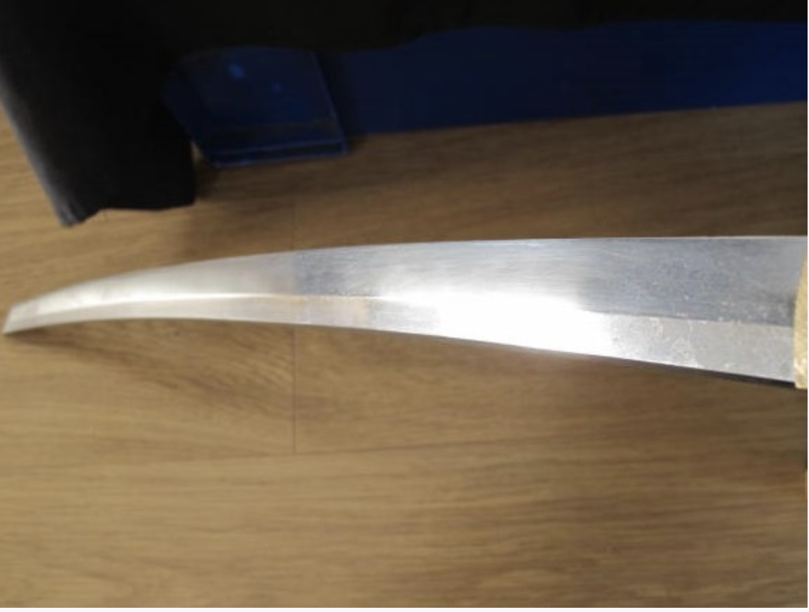

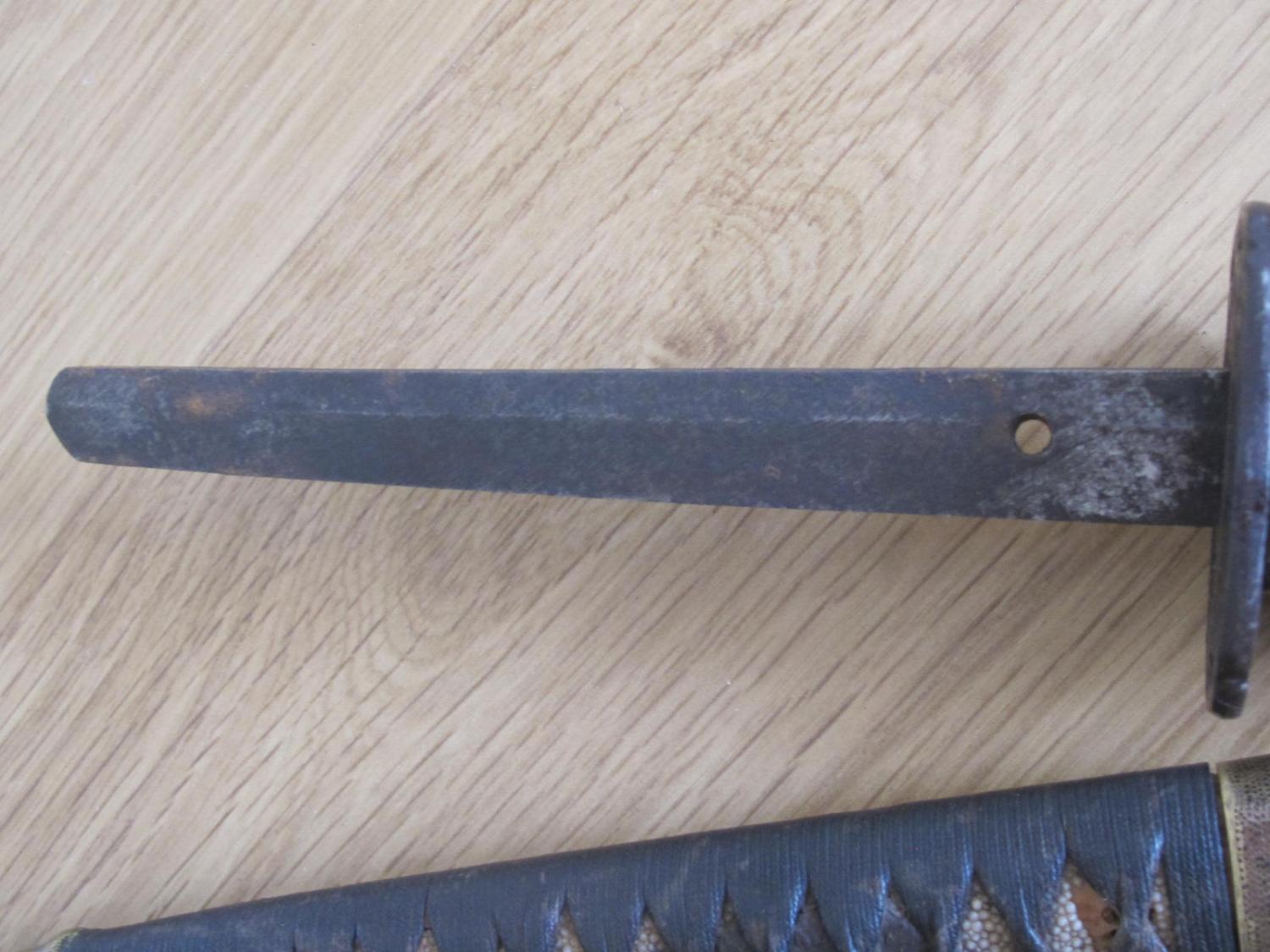

Hello, this is my first posting on this forum, my background has been in collecting edged weapons, German, British and US (fighting knives, daggers and swords). I have always wanted to move my collecting into WW2 Japanese but until recently have felt too nervous to purchase, most people I know have advised against it on account of the amount of good fakes out there. I have now stumbled on this forum so would be incredibly grateful if any one could help me authenticate my first purchase. I have located what I believe to be a model 35 Officers sword and I trust the chap who is selling it because I have never had any trouble in the past when purchasing German daggers from him.
Please see the photos attached, hope these are of good enough quality, if not I am sure the chap will be happy to send the sword prior to me purchasing so I can do better photography.

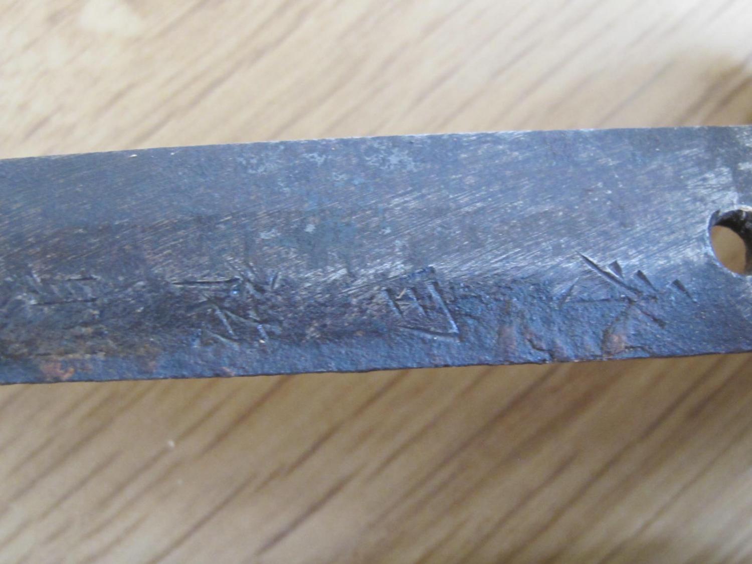

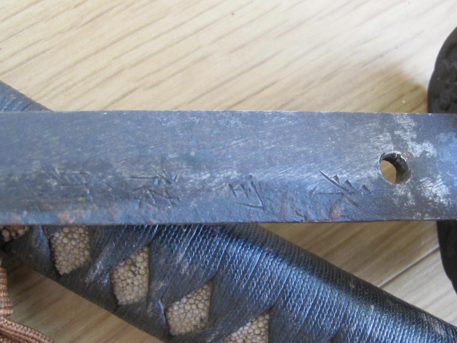

The photos are okay but leave a lot of mysteries. I believe the blade is real but is there a stamp or not? Would make the difference between a traditionally made blade or not. I’ll leave others give you the name of the swordsmiths.

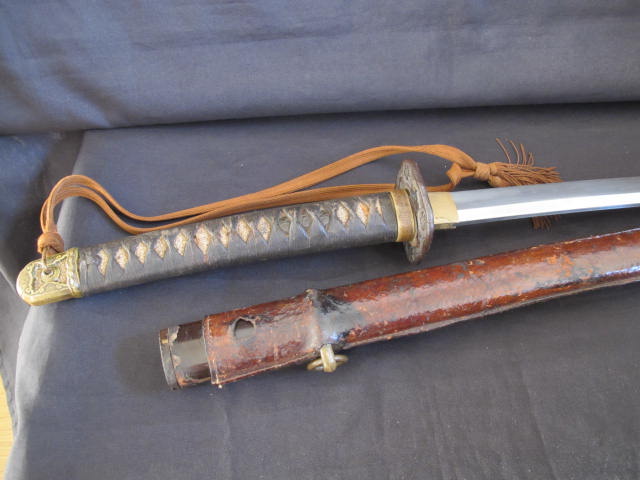

what bothers me are some of the fittings. They look like an assortment of several types. By the way, your sword is a type 98 and I wonder whether it is not rather a civilian sword refitted for army service. Actually it’s more than likely.

I agree with the above, except for the second paragraph (as I know absolutely nothing about this era's produce. I did want to say good job on not buying a fake, perhaps with your background that's a given but it's nice to see a different first-buy story. And welcome to the forum!
Also if you have the sword in your possession already we would ask for a photo of the whole sword without other things in the photo to show the sugars or form of the sword. One on the kissaki or tip and perhaps some close ups on the blade.

Welcome to NMB.  This is a real Japanese sword but that's about all we can tell from these photographs.  The tang, nakago, would suggest that it is a Showato, sword made for WWII.  It may or may not have a small stamp on it somewhere.  The fittings are far from standard and the blade is out of polish.  To summarise this is not a good example of the type and it shouldn't be much money.  If you buy it you will not be able to learn a lot from it and will have trouble selling it on.  Just for comparison here is one in standard mounts.
If you are prepared to give us an indication of what is being asked for the sword then we might be able to be a bit clearer but if you are looking at WWII military swords this is not a great example to start with.
Don't give up!  Keep an eye on the For Sale section here and I am sure one or two of our UK members will tip you the wink if they come across anything good.

As to this gunto, If that 795 is USD, it's an Ok price. Don't know the UK market. I don't see anything wrong with the mounts. The tsuba is thinner than I've ever seen. The all-brown tassel likely indicates this gunto was carried by a Gunzuko officer (the civilians working for the Army. They had uniforms and rank). But at that price you could get a gunto in better condition, though some guys like the worn, used, battle-proven look like this one.

Steve, I would pass on that one and keep a close look in the sale section. This sword isn’t really a great example.  You can find much better at a similar price, even in Europe.
