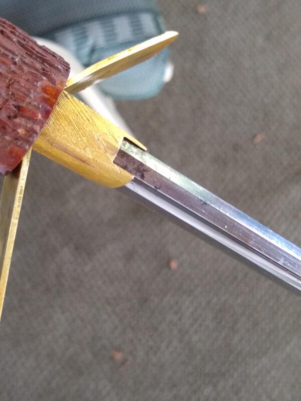

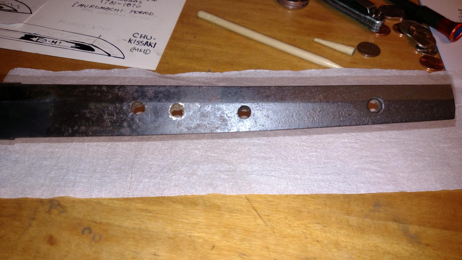

A gentleman came to me at the local show to ask if I could find out if this hidden cane sword was "authentic".   A couple of things concern me about it, namely the tang may have been drilled instead of punched for the holes and I can not find (admittedly in my limited references) any reference to a spring loaded "tsuba" for hidden swords.  The fact that there are multiple peg/pin holes makes me wonder why so many would be needed if it wasn't an earlier blade that was remounted.
There are no markings that I can find and I can't see any file marks on the tang.

Have seen that style of folding "tsuba" before, and yes..it is genuine. Meiji period mounts, but in this case the multiple ana may be a good thing, as the usual shizuekomi blades are not good. But this may be an earlier and better blade remounted later. Blade doesn't look bad. Worth checking out. But undoubtedly genuine.
Thanks!
Another thing puzzles me, there's copper wire used in at least a couple of places to secure the tsuka that is covered by what looks like bark.
