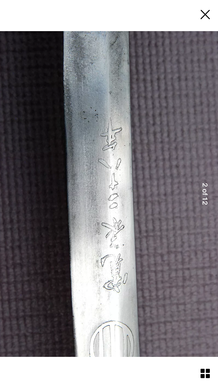

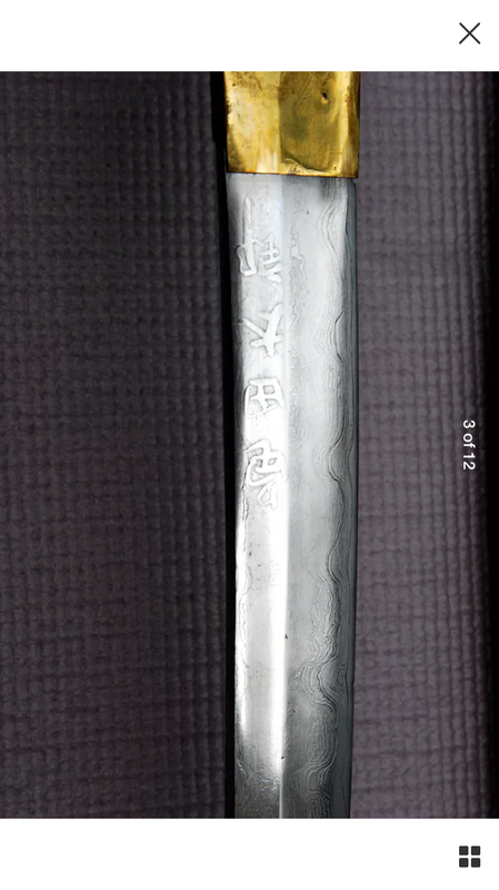

markme777 Posted October 4, 2018 Report Posted October 4, 2018 Hi, could someone translate these inscriptions please? Quote
Ray Singer Posted October 4, 2018 Report Posted October 4, 2018 Appears to be a Chinese fake sword. Quote
markme777 Posted October 4, 2018 Author Report Posted October 4, 2018 Thanks, that's good to know! Quote
markme777 Posted October 9, 2018 Author Report Posted October 9, 2018 Can you tell me what you see that tells you they are Chinese fakes. I’m just learning about Japanese swords. Quote
SAS Posted October 9, 2018 Report Posted October 9, 2018 Inscription says "Made in great Chinese rice field last week" Quote
Ray Singer Posted October 9, 2018 Report Posted October 9, 2018 There is nothing in the photos which resemble a Japanese sword. Please see below for information which will help to distinguish fakes like this from authentic items. http://jssus.org/nkp/fake_japanese_swords.html Quote
SteveM Posted October 9, 2018 Report Posted October 9, 2018 Also Rarely are personal names inscribed on the actual blade. I hesitate to say "never" because I haven't seen everything that is out there, but in my experience I have yet to see a personal name inscribed on the actual sword. There may be the rare instance where a soldier scratches his name onto his arsenal blade, but it would be unusual. Artists will inscribe their names and other info on the nakago part, not on the blade. The name on your sword is not an artist name. It says 亀田太郎 (Kameda Tarō). Seems to be a totally random name . Rarely are dates inscribed on to the actual blade. I feel this is even a greater giveaway than the name. The date on yours says Kan'ei 28. Take a look at wikipedia for more info on the Japanese calendar system https://en.wikipedia.org/wiki/List_of_Japanese_era_names Kan'ei in the Japanese era system only had 24 years. Your sword says "Kan'ei 28" The "engraving" style on your swords is nothing like the actual carving technique that swordsmiths and associated artisans use on swords. Yours looks to be a kind of machine engraving using commercially available fonts. Hope this is useful for you. 1 Quote
