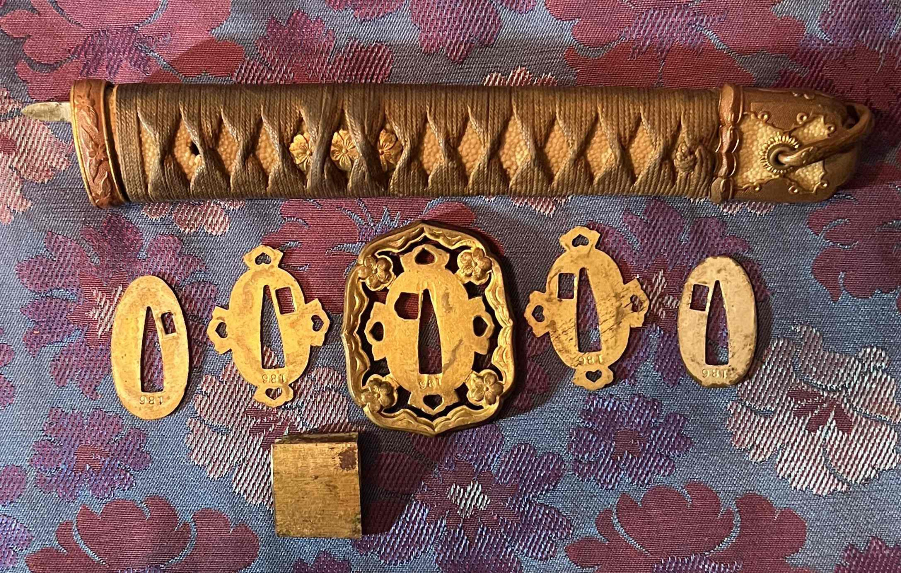

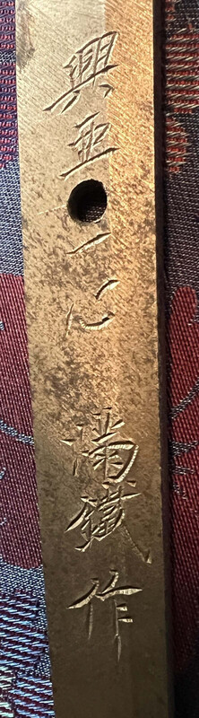

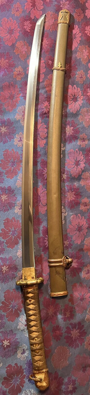

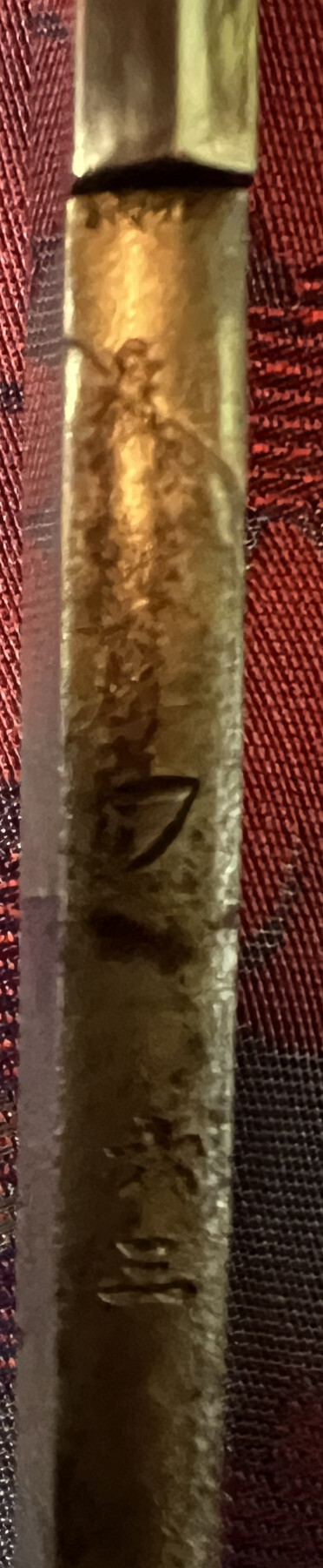

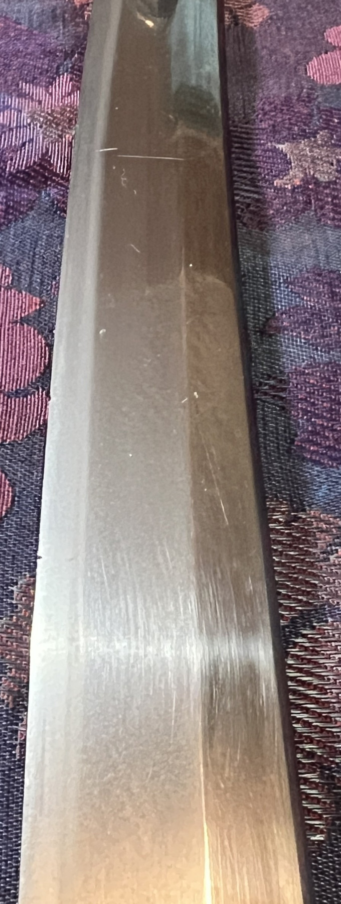

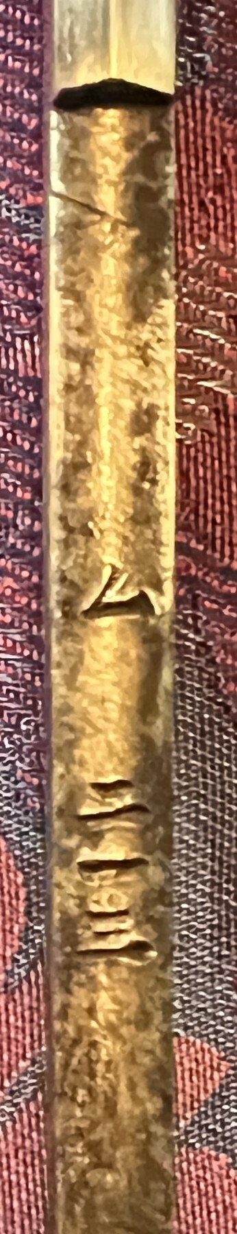

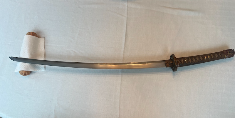

Conway Posted April 28, 2025 Report Posted April 28, 2025 Posting this recent acquisition. It's dated Spring 1939 with katakana "ro" 口 233. It was hard to get a good picture of the mune due to it being a little rusty. Based on Bruce's Iroha chart, I believe this would be from the second series. Please correct me if that is incorrect. The sword has early features such as the center chuso release, thick pierced tsuba, copper rain pattern habaki, and hands clasped sarute. The tsuka also has metal shims for added durability. Conway 1 Quote
Bruce Pennington Posted April 29, 2025 Author Report Posted April 29, 2025 Nice one, Conway! I bet it's heavy! As to it's place in the series, it's hard to say exactly. '39 was the year of overlap as they finished out the English lettering N-Z (we only have examples of N, O, V, and W) and began using IROHOA. All the Alpha/numerics for '39 were "Spring" and the IROHA started with Spring, so either they finished the Alpha/numberics before staring IROHA or they ran the two numbering system simultaneiously. 1939 -- -- -- -- -- N-423春 N-574春 N-597春 O-4春 -- V-18春 V-33春 W-23春 W-38春 W-82春 -- None春 I イ(イ) i い Ro ロ Ha ハ Alpha Numeric Missing Kanji 1939 I イ RO ロ HA ハ NI ニ HO ホ I 132-S I 169-S I 376-S I 466-S RO 69-S RO 75-S RO 233S RO 270S RO 381S RO 446S HA 24-A HA 35-A NI 53-A NI 57-A NI 190-A NI 375-A NI 422-A NI 539-A Ni 657-A NI 679-W Ni 733-A HO 113-W HO 122-W HO 123-W HO 125-W HO 168-W HO 171-W HO 213-W NoNmr-W 1 1 Quote

PNSSHOGUN Posted May 7, 2025 Report Posted May 7, 2025 Conway, does your sword have Iriyama Gata Nakagojiri? Quote
Conway Posted May 7, 2025 Report Posted May 7, 2025 John, For some reason, the pics I posted above do not display completely unless you double click to open them in another tab. I did not recognize this as a feature of the early Mantetsu until after I read your comment. 1 Quote
PNSSHOGUN Posted May 7, 2025 Report Posted May 7, 2025 This is the first Koa Isshin I can recall seeing with this type of Nakagojiri. Good find, the early Koa Isshin have something a little special about them one way or the other. 1 Quote

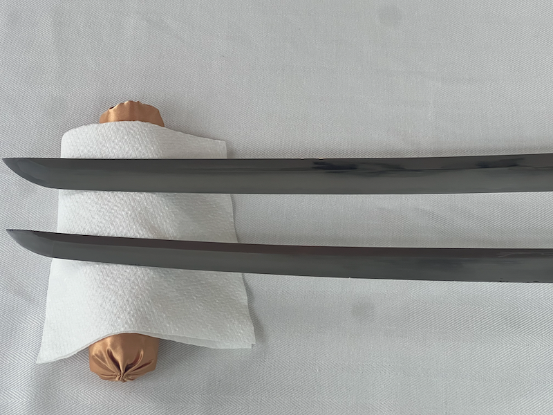

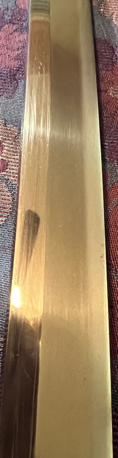

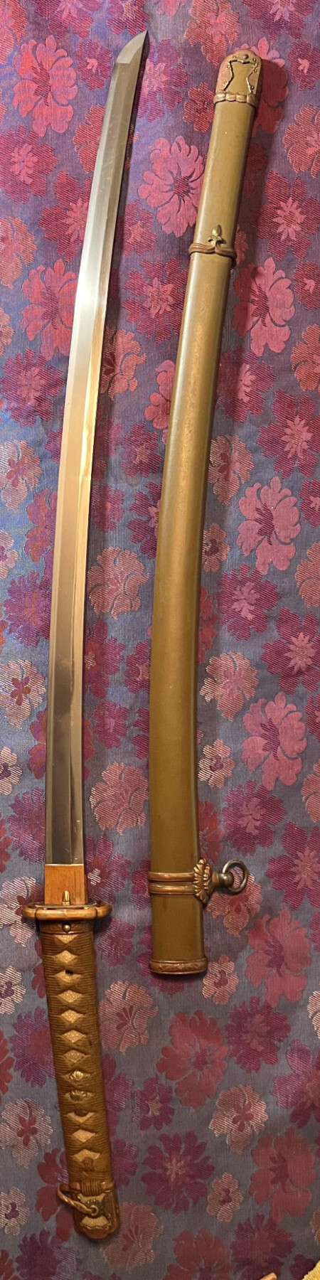

Conway Posted May 8, 2025 Report Posted May 8, 2025 Here's a few pics of the blade with a comparison to a late war in rinji mounts. 39' on the bottom. 1 Quote
Bruce Pennington Posted May 8, 2025 Author Report Posted May 8, 2025 I only have full photos of one 1937, and it has this same shape. Looks like the other '38s went to the rounded shape after this one. 1 Quote

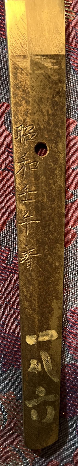

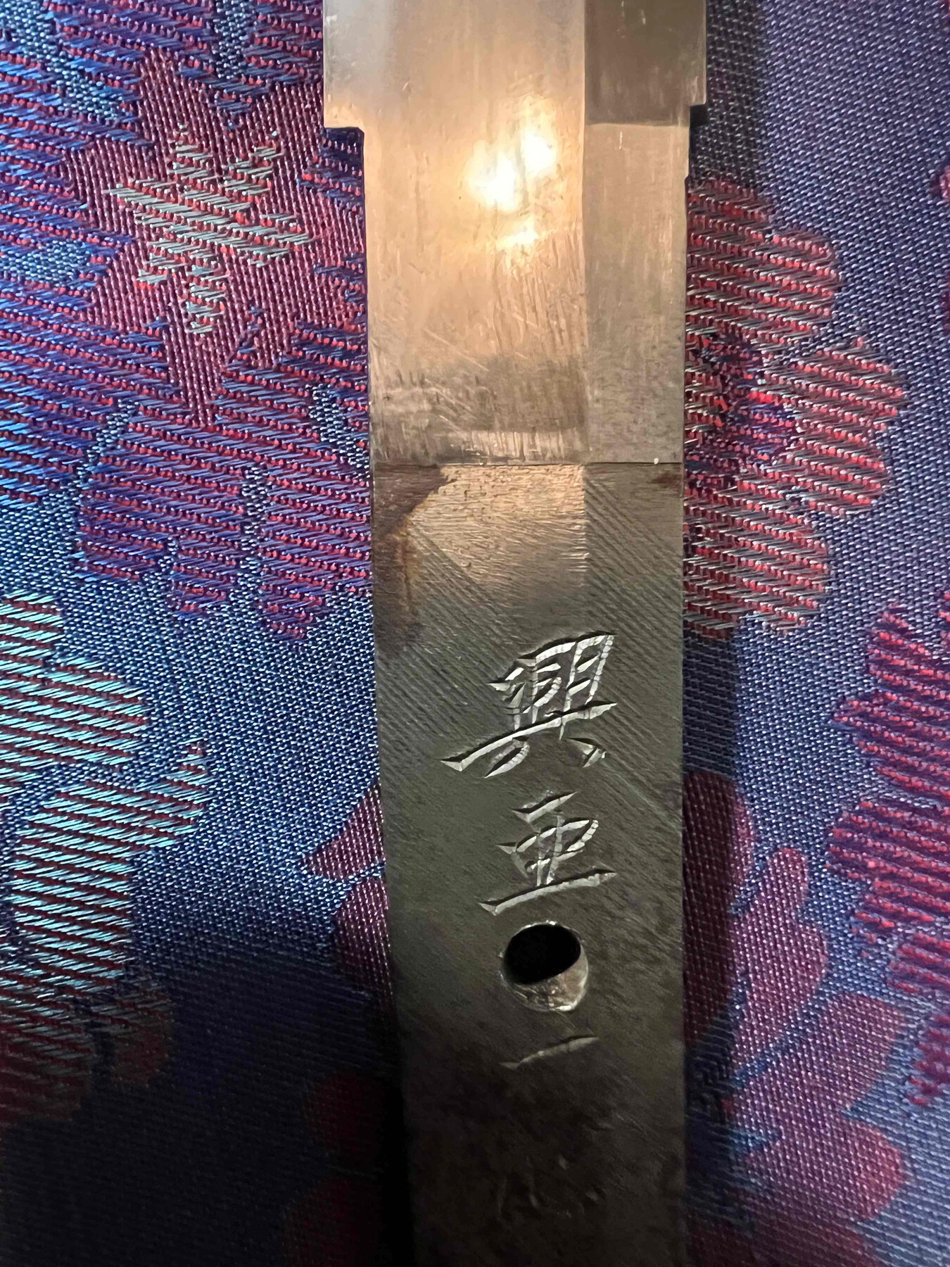

Dogditcher Posted May 25, 2025 Report Posted May 25, 2025 Was Informed this was Spring of 42 Enjoy 2 Quote

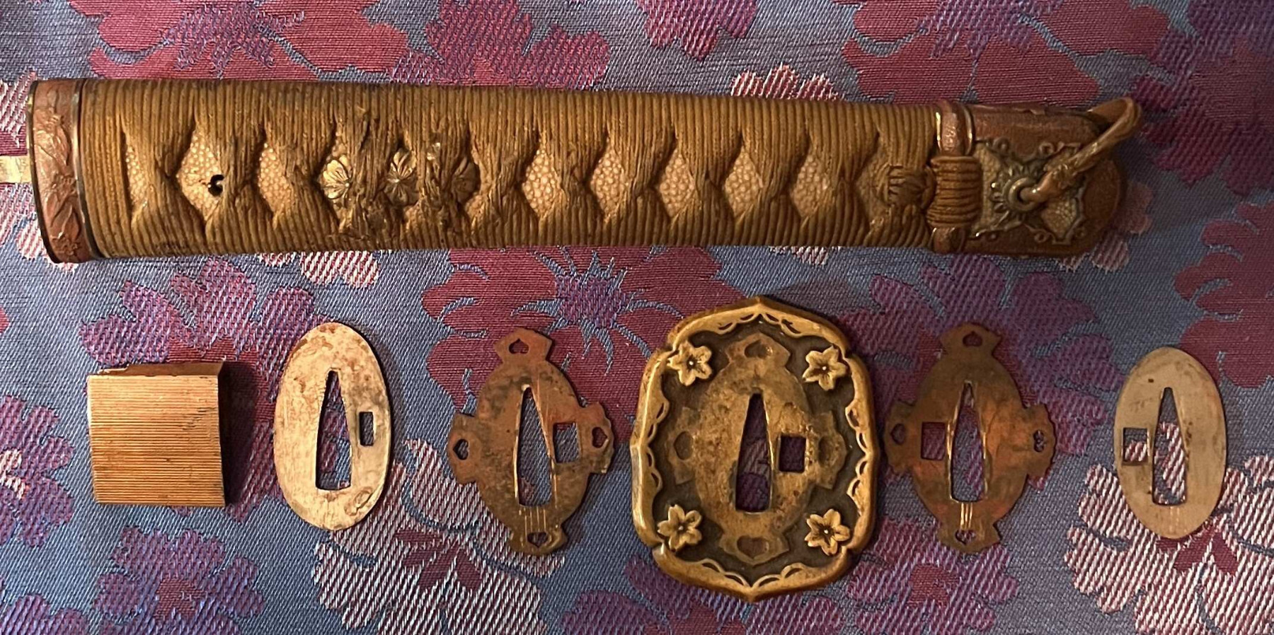

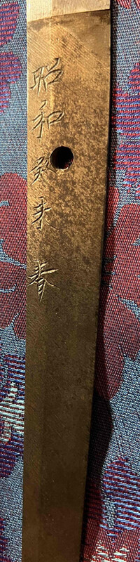

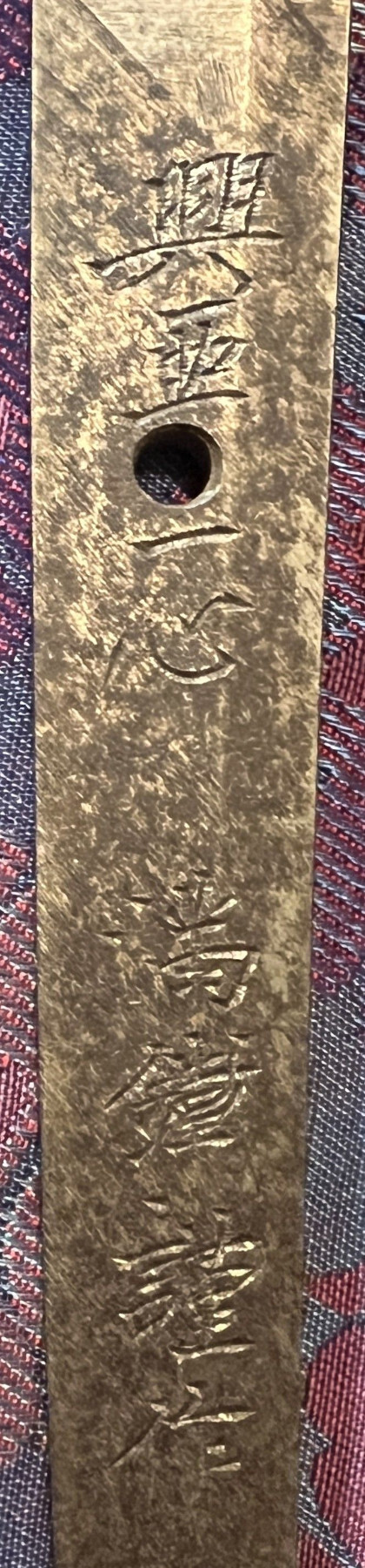

Dogditcher Posted May 25, 2025 Report Posted May 25, 2025 Was Informed this was Spring of 43 Enjoy 2 1 Quote
Bruce Pennington Posted May 27, 2025 Author Report Posted May 27, 2025 On 5/25/2025 at 4:21 PM, Dogditcher said: Spring of 43 Thanks for posting these, Steve! Any chance there is a small stamp above the Koa Isshin mei? Quote
Dogditcher Posted May 28, 2025 Report Posted May 28, 2025 On 5/27/2025 at 12:28 PM, Bruce Pennington said: Thanks for posting these, Steve! Any chance there is a small stamp above the Koa Isshin mei? Not that i can see 1 1 Quote

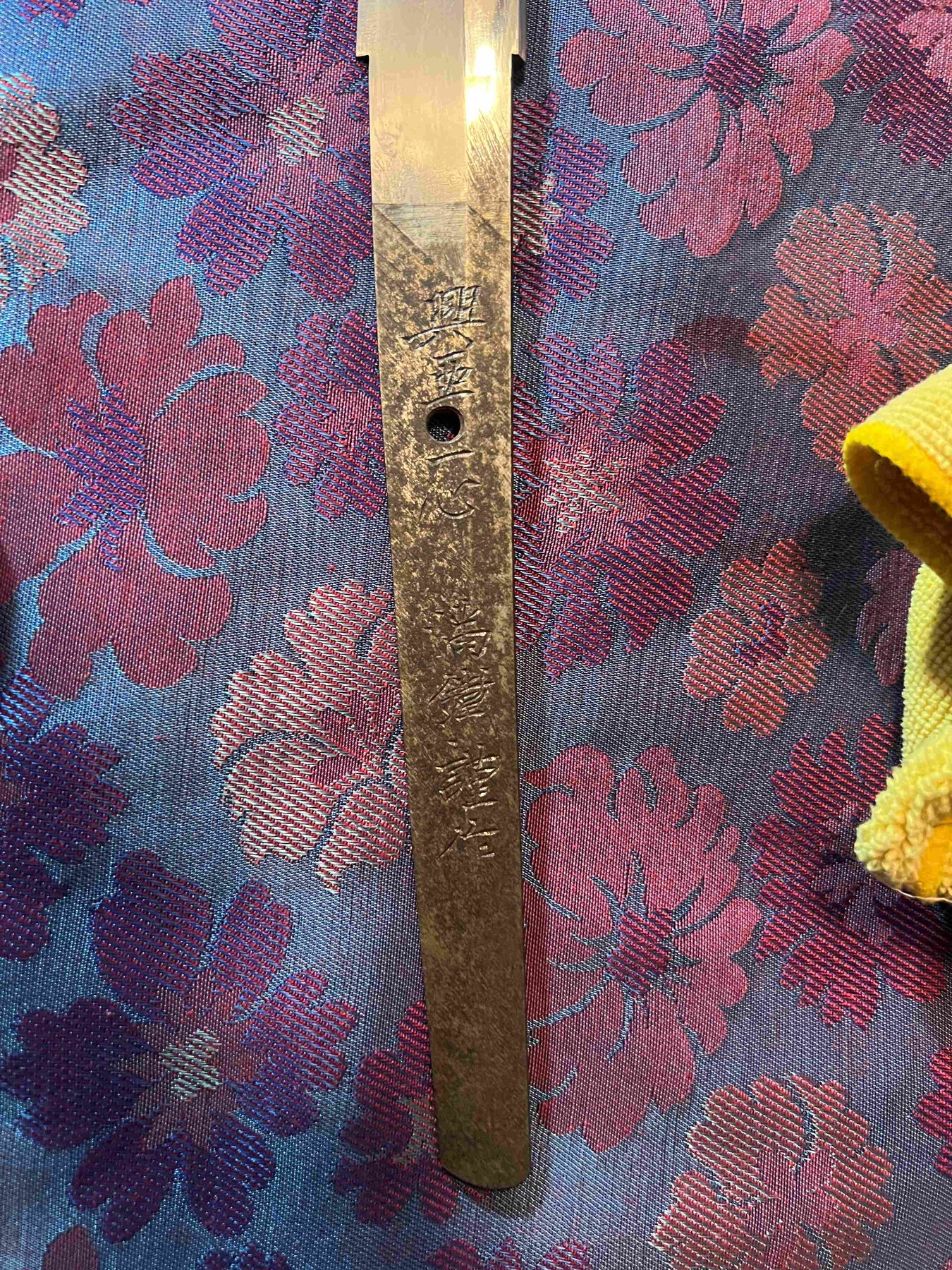

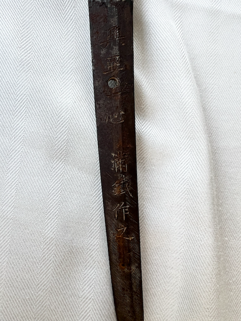

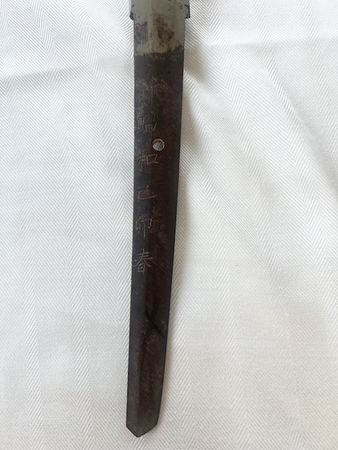

Rawa Posted January 8 Report Posted January 8 1 hour ago, Bruce Pennington said: Marcin, No, don't have that one. Any chance of posting a photo of the date and one overall of the gunto? I don't have a FB account, so it won't let me see the link. Here you go 1 Quote
Rawa Posted January 8 Report Posted January 8 (edited) I found this shorter one https://m.olx.pl/d/oferta/miecz-wakizashi-katana-z-okresu-ii-wojny-swiatowej-CID4042-ID17lRNQ.html more photos https://www.catawiki.com/pl/l/97934141-katana-japonia Edited January 8 by Rawa 2 Quote
Bruce Pennington Posted January 8 Author Report Posted January 8 15 hours ago, Rawa said: I found this shorter one https://m.olx.pl/d/oferta/miecz-wakizashi-katana-z-okresu-ii-wojny-swiatowej-CID4042-ID17lRNQ.html more photos https://www.catawiki.com/pl/l/97934141-katana-japonia Marcin, Great find! At 21.5" it is a waki, and clearly made that way. That is now the 4th Mantetsu waki I have on file. Interestingly, they are all close together (not literally in a row, but close): 1939 O4 Spring 1940 O166 Autumn 1940 Wa33 Autumn 1940 Wa 73 Autumn @Kiipu @BANGBANGSAN Photos from the links, for when they go dead Quote
Kiipu Posted January 8 Report Posted January 8 3 hours ago, Bruce Pennington said: 1939 O4 Spring This one started out as a katana and was later shortened to a wakizashi 脇差. 1 Quote
Kiipu Posted January 8 Report Posted January 8 Polish to English Translation OPIS OSTRZA [BLADE DESCRIPTION]: Sygnatura [Signature]: Koa Isshin Mantetsu saku kore 興亜一心 鍛錬作之 Data [Date]: Showa koshin Aki 1940r. Jesień [1940, Autumn] 昭和庚辰秋 Nagasa: 54,5 cm [21.45 inches] Motohaba: 28 mm [1.10”] Kasane: 7 mm [0.27”] Hamon: Suguha Hada: Nashiji Nakago: ubu, 1 mekugiana Sori: 8 mm [0.31”] Ostrze: konstrukcja Shinogi zukura, grzbiet iori mune. Chu kissaki. Blade: Shinogi zukuri construction, iori mune spine. Chu kissaki tip. Typ miecza: Wakizashi w oprawie katany Sword type: Wakizashi in a katana mounting. Czas powstania: 1940 wiosna. Świetnie zachowane ostrze z okresu drugiej wojny światowej. Klinga doskonale odkuta I zahartowana, posiada doskonale proporcje. Klasyczne ostrze w typie miecza wojskowego gunto wykonane w fabryce kolejowej w Mandżurii w Chinach ze stali mandżurskiej (mantetsu). Z tych powodów wymyka się terminowi “nihonto” mimo, że jest wykonana zgodnie ze sztuka. Sygnatura Koa Isshin nie wskazuje na konkretnego kowala, ponieważ wszystkie ostrza z tej wytwórni byly tak sygnowane. Datowana metoda zodiakalną, tu Koshin (lub Kanoe) tatsu – rok smoka, wskazuje na rok 1940. Aki – wiosna. Na mune nakago widnieje sygnatura montażowa Sai 166 [オ一六六] Made in 1940, spring. A well-preserved blade from the Second World War. The blade is perfectly forged and tempered, and has excellent proportions. This classic gunto-style military sword blade was crafted at a railway factory in Manchuria, China, from Manchurian steel (mantetsu). For these reasons, it defies the term "nihonto," even though it is crafted in accordance with the art. The Koa Isshin signature does not indicate a specific smith, as all blades from this factory were marked in this manner. Dating using the zodiac method, here Koshin (or Kanoe) tatsu – the year of the dragon, indicates 1940. Aki – Spring [Autumn]. The mune nakago bears the assembly mark Sai 166 [オ一六六]*. * It is actually the katakana character オ O and not the kanji character 才 Sai. 1 1 Quote
Rawa Posted January 8 Report Posted January 8 3 hours ago, Kiipu said: Polish to English Translation OPIS OSTRZA [BLADE DESCRIPTION]: Sygnatura [Signature]: Koa Isshin Mantetsu saku kore Data [Date]: Showa koshin Aki 1940r. Jesień [1940, Autumn] 興亜一心 鍛錬作之 昭和庚辰秋 Nagasa: 54,5 cm Motohaba: 28 mm Kasane: 7 mm Hamon: Suguha Hada: Nashiji Nakago: ubu, 1 mekugiana Sori: 8 mm Ostrze: konstrukcja Shinogi zukura, grzbiet iori mune. Chu kissaki. Blade: Shinogi zukuri construction, iori mune spine. Chu kissaki tip. Typ miecza: Wakizashi w oprawie katany Sword type: Wakizashi in a katana mounting. Czas powstania: 1940 wiosna. Świetnie zachowane ostrze z okresu drugiej wojny światowej. Klinga doskonale odkuta I zahartowana, posiada doskonale proporcje. Klasyczne ostrze w typie miecza wojskowego gunto wykonane w fabryce kolejowej w Mandżurii w Chinach ze stali mandżurskiej (mantetsu). Z tych powodów wymyka się terminowi “nihonto” mimo, że jest wykonana zgodnie ze sztuka. Sygnatura Koa Isshin nie wskazuje na konkretnego kowala, ponieważ wszystkie ostrza z tej wytwórni byly tak sygnowane. Datowana metoda zodiakalną, tu Koshin (lub Kanoe) tatsu – rok smoka, wskazuje na rok 1940. Aki – wiosna. Na mune nakago widnieje sygnatura montażowa Sai 166 Made in 1940, spring. A well-preserved blade from the Second World War. The blade is perfectly forged and tempered, and has excellent proportions. This classic gunto-style military sword blade was crafted at a railway factory in Manchuria, China, from Manchurian steel (mantetsu). For these reasons, it defies the term "nihonto," even though it is crafted in accordance with the art. The Koa Isshin signature does not indicate a specific smith, as all blades from this factory were marked in this manner. Dating using the zodiac method, here Koshin (or Kanoe) tatsu – the year of the dragon, indicates 1940. Aki – spring. The mune nakago bears the assembly mark Sai 166. * Kiipu the Menace: This is a translating error. The translator mistook the Katakana 片仮名 character O オ for the kanji 漢字 character Sai 才. Fine translation 1 Quote
Bruce Pennington Posted January 8 Author Report Posted January 8 3 hours ago, Kiipu said: Aki – spring. The mune nakago bears the assembly mark Sai 166. * Kiipu the Menace: This is a translating error. The translator mistook the Katakana 片仮名 character O オ for the kanji 漢字 character Sai 才. They also got the "spring" wrong, though they had it right, "autumn" at the top. 1 Quote
