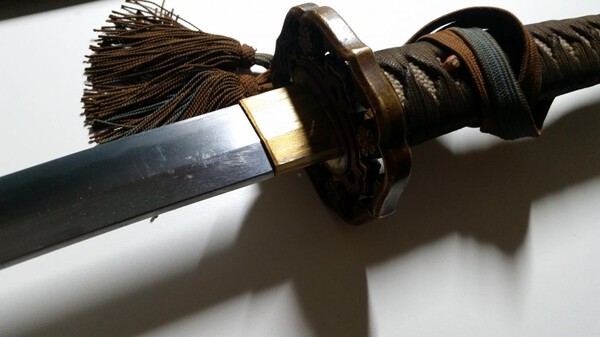

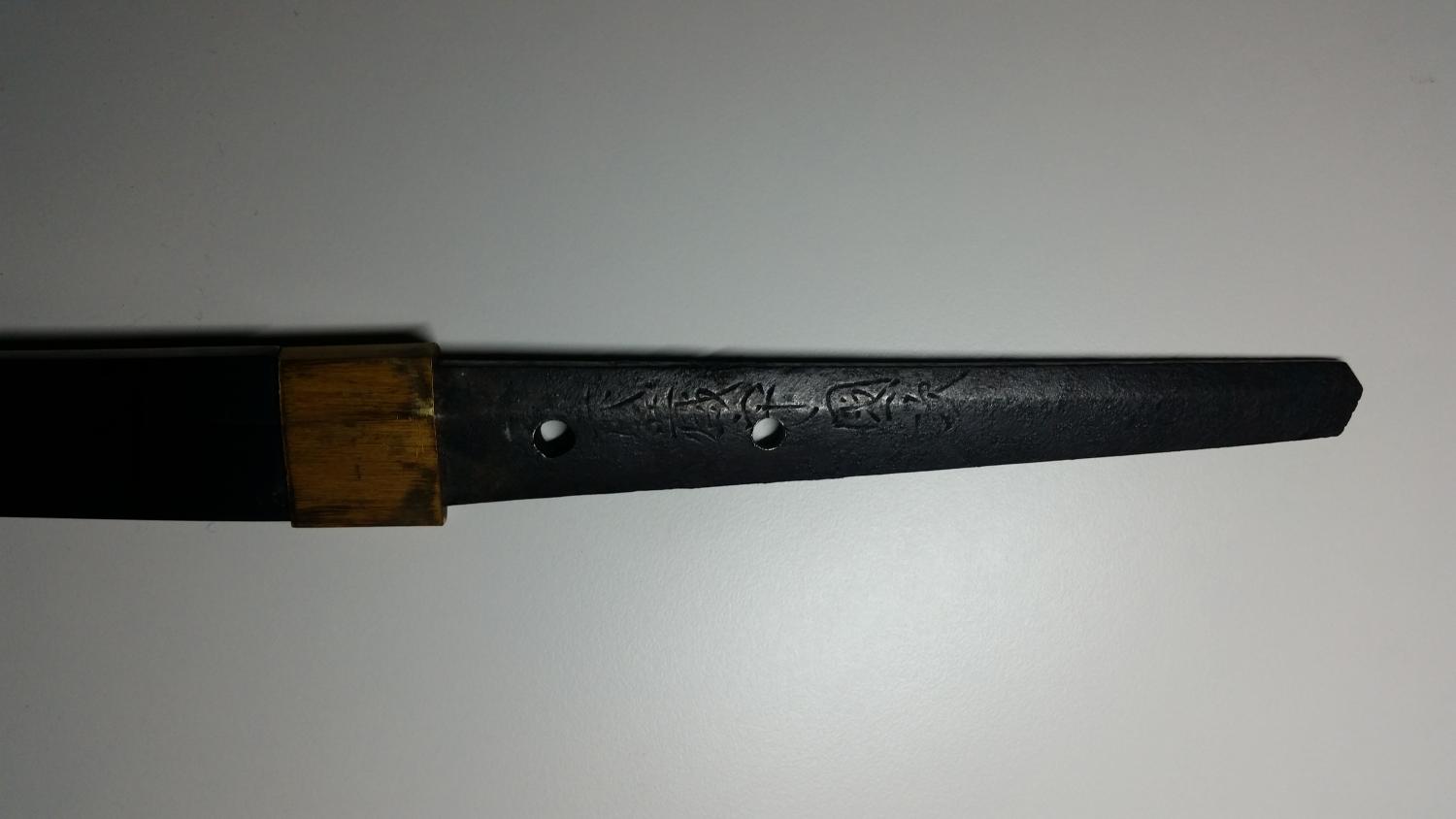

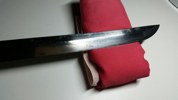

gustaf Posted October 31, 2017 Report Posted October 31, 2017 I’m not certain what I have here. It came via estate auction in reasonably good shape. Blade is clear with no nicks or openings. Just some aging. Signature appears to be old and I am stumped on the translation. Total blade length is 19” which makes is a Wakizashi? What is it and would it be worth restoring? Quote
Bencld Posted November 1, 2017 Report Posted November 1, 2017 Hi there. something something kami kuni sada. Someone will be able to fill in the rest for you. Chris D. Quote
gustaf Posted November 1, 2017 Author Report Posted November 1, 2017 Amazing. Thank you for a lightning quick reply. Quote
PNSSHOGUN Posted November 1, 2017 Report Posted November 1, 2017 Kunisuke the First & Second are well regarded smiths. I have a Katana By Kunitsugu who was the pupil of Kunisuke I and teacher of Kunisuke II. Quote
Bencld Posted November 1, 2017 Report Posted November 1, 2017 Carl. Apologies for leading you down the garden path but I thought I would give it a shot just on memory. Alas it is not as good as I thought. Quote
ROKUJURO Posted November 1, 2017 Report Posted November 1, 2017 Carl,blade length is about 14" so it is indeed a HIRA-ZUKURI WAKIZASHI. The photos are not good (well focused) enough to say much about the condition of the blade. What you call "Just some aging" is in fact considerable corrosion, especially on the YAKIBA. At one time, somebody tried to remove the rust with sandpaper. If the MEI is authentic, it is an early EDO period blade with a good potential for a polish. Please compare with the many samples of the KUNISUKE smiths that are available online. 1 Quote
