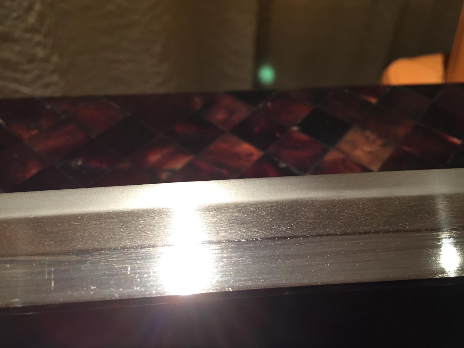

Guest Rayhan Posted October 1, 2017 Report Posted October 1, 2017 Hi Members Asking help again on a sword I cannot locate in literature or online, sorry guys if it is a case of not looking in the right places. Mei: Shinkoku (Star Stamped) There is definitely a Hamon and tight hada but, opinions and help please? Rayhan 1 Quote
vajo Posted October 1, 2017 Report Posted October 1, 2017 Very nice sword in my opinion. First impression was Yasukunito. Quote
Stephen Posted October 1, 2017 Report Posted October 1, 2017 (edited) Kiyokuni edit to add KIYOKUNI (神国)→ SHINKOKU (神国), Shōwa (昭和, 1926-1989), Nagano and your first reading Edited October 1, 2017 by Stephen 1 Quote
vajo Posted October 1, 2017 Report Posted October 1, 2017 Thanks Steven. 櫻井 神國 (Sakurai Kiyokuni) 中上作 (CHUJO SAKU) Quote
