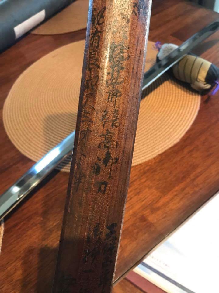

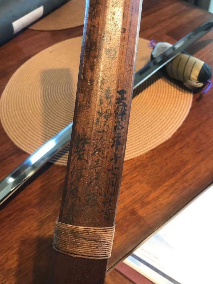

Davidarmy Posted May 9, 2017 Report Posted May 9, 2017 Requesting some help with this sayagaki....thanks in advance D. Easley Quote
Davidarmy Posted May 10, 2017 Author Report Posted May 10, 2017 Going to give a headache for sure Quote

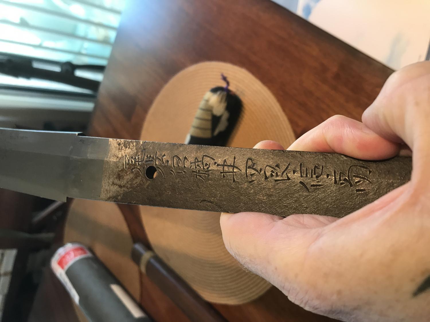

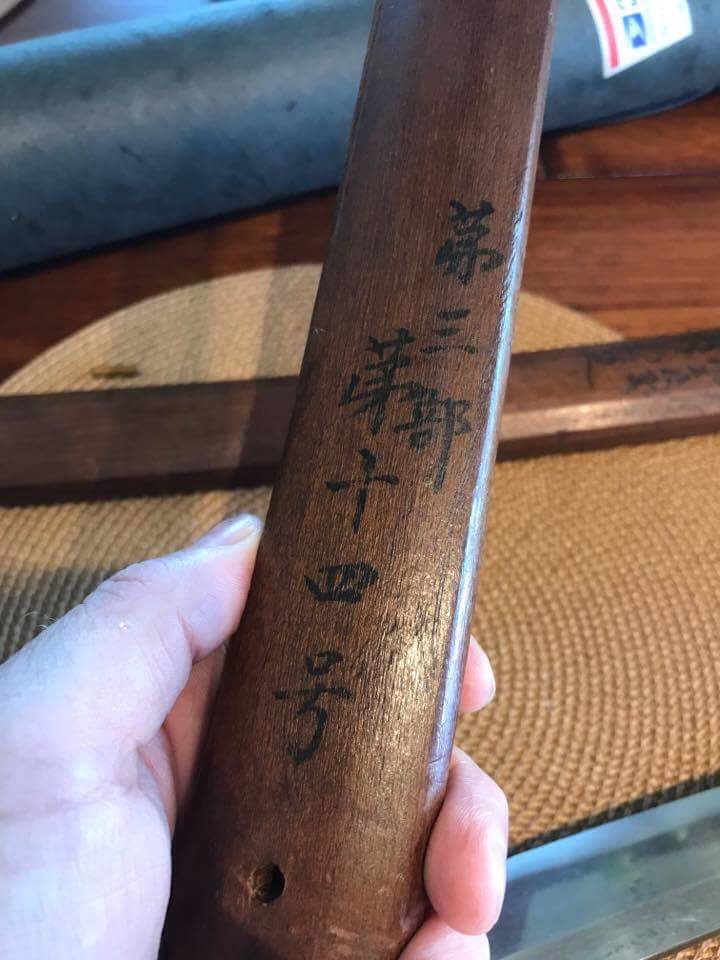

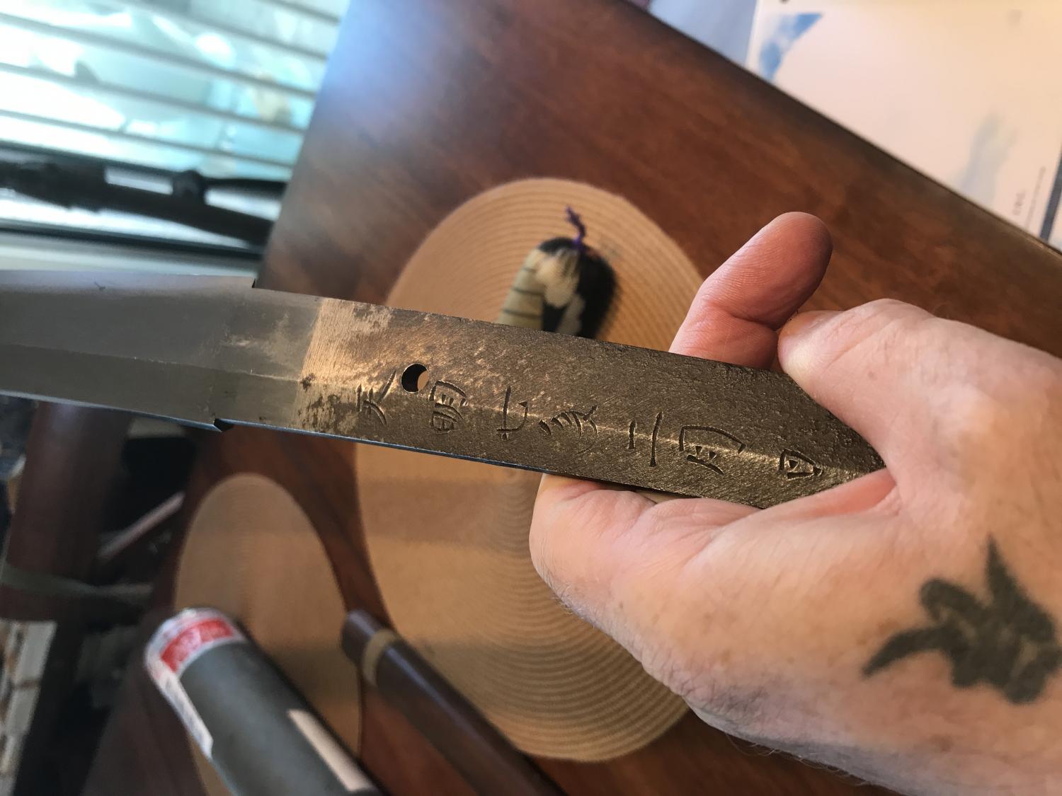

SteveM Posted May 10, 2017 Report Posted May 10, 2017 Hello, Some indecipherable elements on there, and these might be remedied by a better angle and lighting (careful of the flash). What I can make out is not particularly illuminating: 弟三部第十四号 Third section, #14 天保六年囗九月三日 Tenpō 6 (1835) September 3rd The section immediately after this is Illegible (far right bit is Illegible) 尾張住橘井四郎信髙御刀 Owari-jū Kitsui Shirō Nobutaka sword 銘有長貮尺三寸半(生?) With mei, and length of 2-shaku, 3-sun (half? ubu?) 天保五年囗七月 Tenpō 5 (1834) July (Illegible after this) The crucial bits are the parts after the dates that are illegible (to me). I reckon they are names and possibly titles, showing ownership or transfer of ownership. The sword itself is dated Tenmei 7 (1787) with a very handsomely cut mei. The 住 on the sword looks unusual. I don't know if I have read this wrong or if this is just a stylistic rendering of that kanji. The parts in blue above are the parts that I am unsure about. They might be clarified with a different angle, less flash, or maybe a closer shot. 2 Quote
