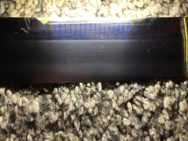

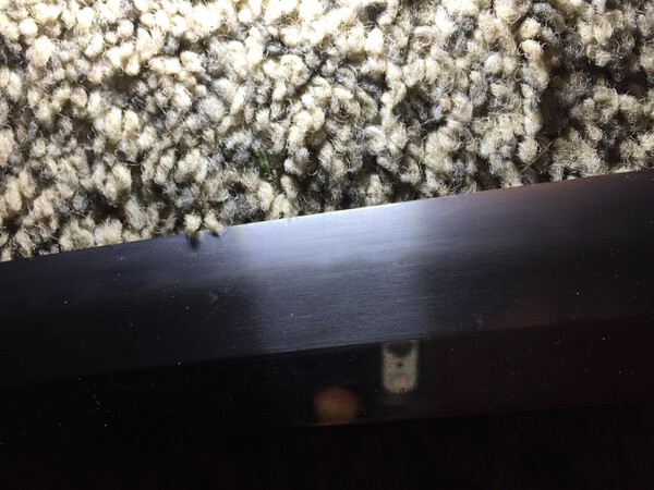

Lazervulture Posted April 2, 2017 Author Report Posted April 2, 2017 Thanks guys, after looking closer it definitely seems to be a kaneaki. Can anyone take a look at these pictures and tell if this looks like a hada or just a trick of the light? I can't tell. Quote
SwordGuyJoe Posted April 2, 2017 Report Posted April 2, 2017 I don't see hada there. Looks like a non-traditional sword to me. Quote
