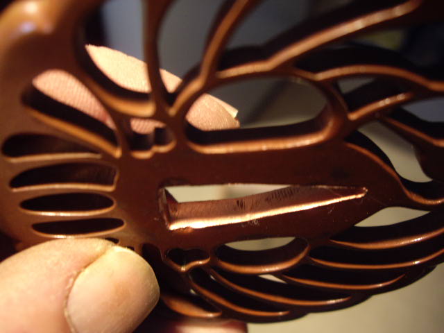

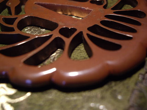

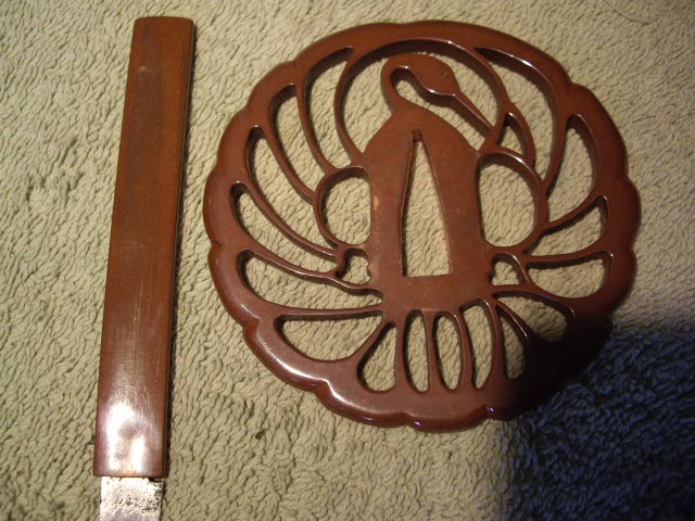

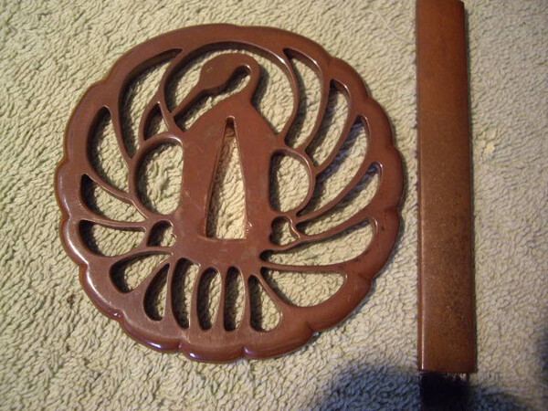

Hope to get your opinions on this tsuba although you would probably need it in hand to give a fair opinion.
I bought it on a sword from ninhonto.com. The tsuba is described as copper in the shape of a crane, lacquered brown. I've also shown kozuka which is also lacquered.
Many thanks
Pete

I agree modern work, and IMHO not lacquered, but a nice patina.  Also has been filed "recently" - see fresh metal inside nakago ana.
BaZZa.
Nothing for me to add. :-) Modern work, quite tidy but probably not lacquered merely patinated very cleanly. If it was lacquered you'd see the layers on the edge of the nakago-ana where there is fresh filing, as Barry points out.
I wonder if it might simply have been spray painted though....a bit of automotive repair work to match the other patinated metal fittings. The colour does look very 'plastic'
