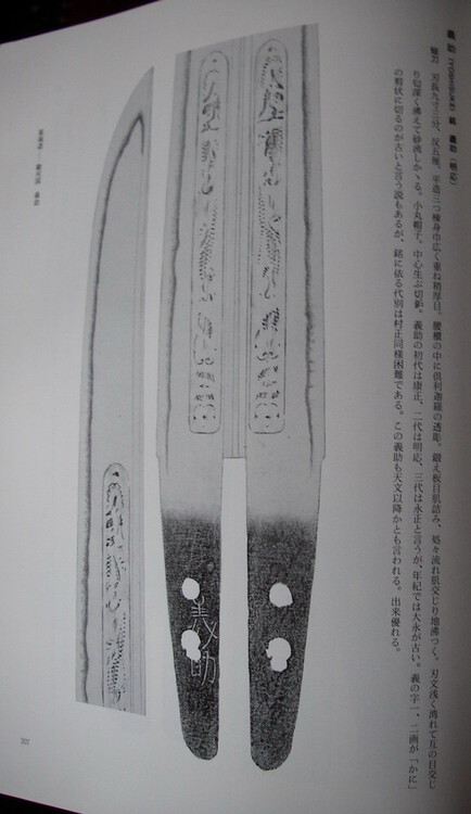

Jean Posted August 17, 2007 Report Posted August 17, 2007 Hi Martin, Another one from the Nihonto Zuikan, Perhaps Koichi shall be able to give you a feed back on the Japanese text Sorry but there is an ana on the mei Quote

Nobody Posted August 18, 2007 Report Posted August 18, 2007 The following excerpt could be one conclusion for this issue. The partial translation is for the page of the Nihonto Zuikan posted by Jean. Yoshisuke, Meio (明応: 1492-) : ............ Although there is a theory saying that the first and second strokes of the character “義†were chiseled as they looked like claws of a crab by older generations, it is difficult to distinguish a specific generation by its mei as well as Muramasa. This Yoshisuke is also said that this might be made after Tenbun (天文; 1532-). 1 Quote

Martin Posted August 18, 2007 Author Report Posted August 18, 2007 Thanks Koichi-San and Ludolf-San :D the excerpt you posted about the "crab-claws" is very interesting. But once again: not a rule... I think there is nothing more certain in Nihonto than exceptions :D So maybe the Mei on my Tanto is from a more peaceful era as the claws are not that aggressively shown :lol: What do you think about the workmanship (Jitetsu, Hamon, length, Sugata). Does maybe this allow a certain attribution? This looks very much like Soshu to me. cheers, Quote
Jean Posted August 19, 2007 Report Posted August 19, 2007 Thanks a lot Koichi for the translation, it is very interesting. A lot of schools (Mino, Enju, Bizen ....) had swordsmiths working under the same name and are (even if signed) seldom kanteied to a specific smith in the lineage (Sukesada, Kanefusa ...). This is a sunobi tanto indicating perhaps post 1550 ans it has a Soshu flavour (Mitsumune) Quote
JakeNYC Posted November 22, 2021 Report Posted November 22, 2021 On 8/18/2007 at 5:33 AM, Nobody said: The following excerpt could be one conclusion for this issue. The partial translation is for the page of the Nihonto Zuikan posted by Jean. Yoshisuke, Meio (明応: 1492-) : ............ Although there is a theory saying that the first and second strokes of the character “義†were chiseled as they looked like claws of a crab by older generations, it is difficult to distinguish a specific generation by its mei as well as Muramasa. This Yoshisuke is also said that this might be made after Tenbun (天文; 1532-). Whose theory? Do we have a source for that? Makes total sense, just checking. Quote
Nobody Posted November 22, 2021 Report Posted November 22, 2021 1 hour ago, JakeNYC said: Whose theory? Do we have a source for that? Makes total sense, just checking. That is not stated explicitly on the posted page from Nihonto Zuikan. 1 Quote
