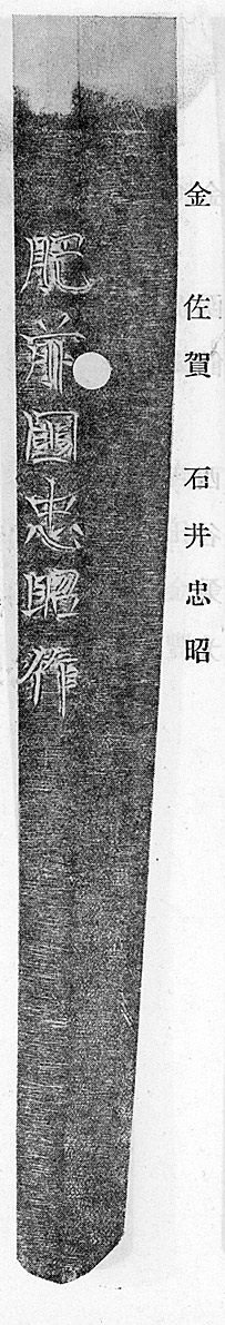

k morita Posted July 27, 2014 Report Posted July 27, 2014 Hi, This is an oshigata of Ishii Tadaaki(石 井 忠 昭) sword, on sword exhibition in 1941. Quote
patrick7813 Posted July 28, 2014 Author Report Posted July 28, 2014 Chris: Thank you for the hint. It's taken me down many rabbit holes without any success so far. Morita san: Thank you for the oshigata. I placed it beside the mei on my sword and they both match exactly. So there's no (little) question they're swords of the same smith. Do you have any historical information about this Ishii Tadaaaki that you could share? Quote
Stephen Posted July 28, 2014 Report Posted July 28, 2014 Pat don't want to be a DDowner the kanji match but not the way their cut, doesn't look the same to me, just my 2cent Quote
patrick7813 Posted July 28, 2014 Author Report Posted July 28, 2014 Hi Stephen I'd be the first to admit that my lesser trained/experienced eyes wouldn't likely see something that you would. I'm having difficulty placing this Tadaaki. Other than a Tsuneyasu who initially signed as Tadaaki (but with a different Aki kanji), I’m having no luck. I'm beginning to think George may be on the right track in that we have a sword without any detailed recorded information relative to the smith. Cheers, Quote
Stephen Posted July 28, 2014 Report Posted July 28, 2014 Pat ...it doesn't mean im right.. still a fine looking sword. Quote
cabowen Posted July 28, 2014 Report Posted July 28, 2014 I have no doubt this is indeed Ishii Tadaaki, the same as posted by Morita san. There are many WWII era smiths who are mostly question marks. Little to no info commonly available. This was the reason I spent untold hours digging up period literature, interviewing surviving smiths, etc., in my efforts to research smiths from the period who worked in Tokyo. As I mentioned above, we need someone to do the same with Hizen.... Quote
Stephen Posted July 28, 2014 Report Posted July 28, 2014 There ya go Pat, always wait for a better eye. Good going Quote

k morita Posted July 28, 2014 Report Posted July 28, 2014 Hi, One more other Oshigata, signd "Hizen no kuni, Ishii Tadaaki " . (His family name(Ishii/石井) is carved clearly on the tang.) This oshigata from sword-exhibition in 1940. Quote
