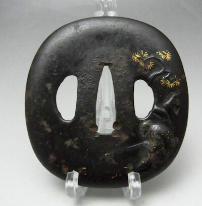

i seen this a fig it would give me more than a few hours of doing something other than being in front of a TV or PC. Please have at it! Past restore? Low quality? What part of a mei do you see and what who does that connect with? asking alot arent i LOL.

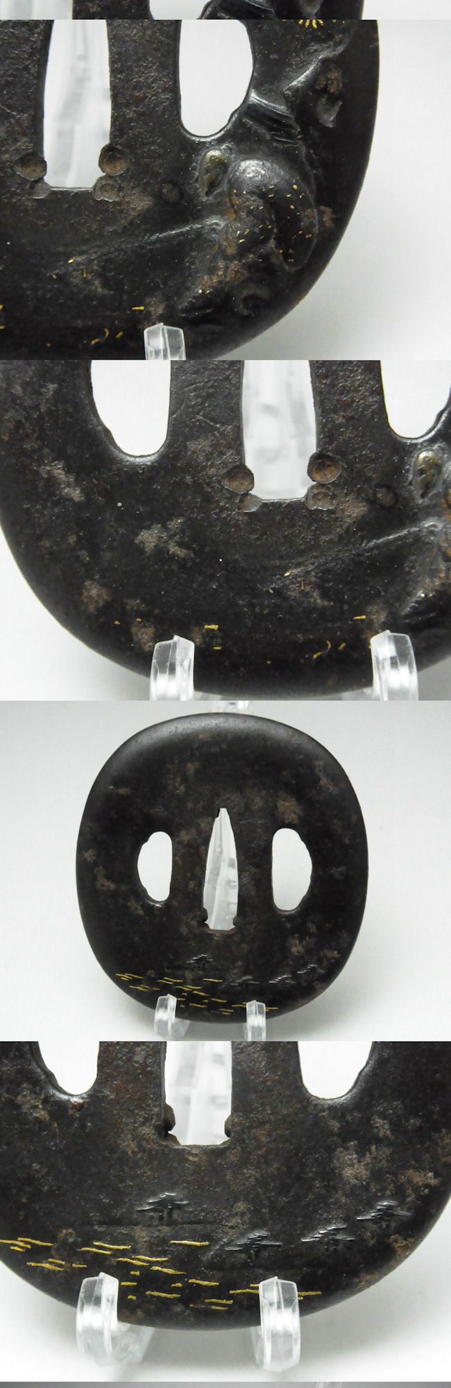

I think it's a pretty fair purchase. Needs a little care but all in all a decently made piece in reasonable condition, certainly enough there to enjoy and appreciate I think.
Yeah..whilst it is nothing to submit to shinsa, it is much better than the usual sub-$200 stuff we see. Think you did ok on it.
Definitely a mei there, but can't make it out.

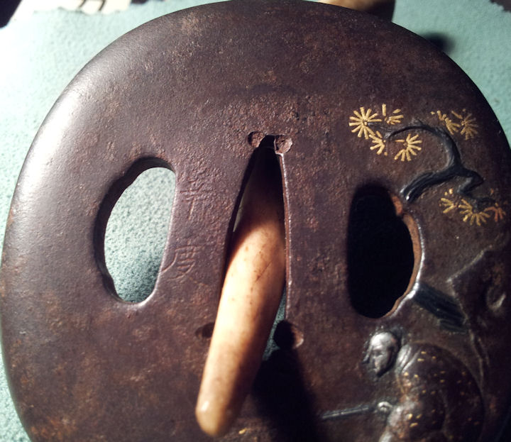

yea Ed from what I remember it was great fun, alas cancer treatment and lack of a bonei has left me with just thoughts of saving this tsuba. any one care to draw on what school it is so I can do some digging while I wait for it.
after some work ive reveled a bit. im thinking Yuki for top kanji and not sure of bottom by stroke count it could be NORI, TADA ,MICHI
Does this come together?
or am i out in left field?post-21-1419691539154_thumb.jpgpost-21-14196915394788_thumb.jpg

Even Ford said it is an ok tsuba. Nice one to me too..but I have no idea of school. Call it Shoami. But you did well at a good price. That should be enough ;)

Brian that was ol dad trying to be sharp as in witty, must be rather dull as a butter knife, has any one seen a hiro like that with legs crossed? that's why I didn't go with it
David what do you read the mei as?
Hi Stephen,
The mei is hard to read but I think it might say: Yukiyasu (幸安). He is in the Haynes Index but just not a lot of information about this artist that did work in the Shoami style. Here is the information.
