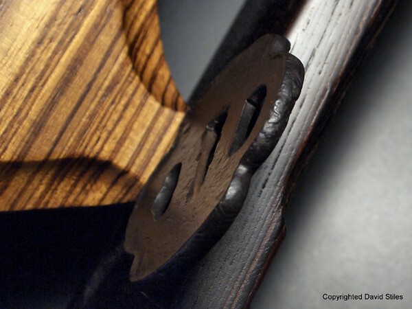

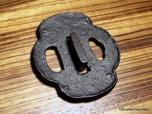

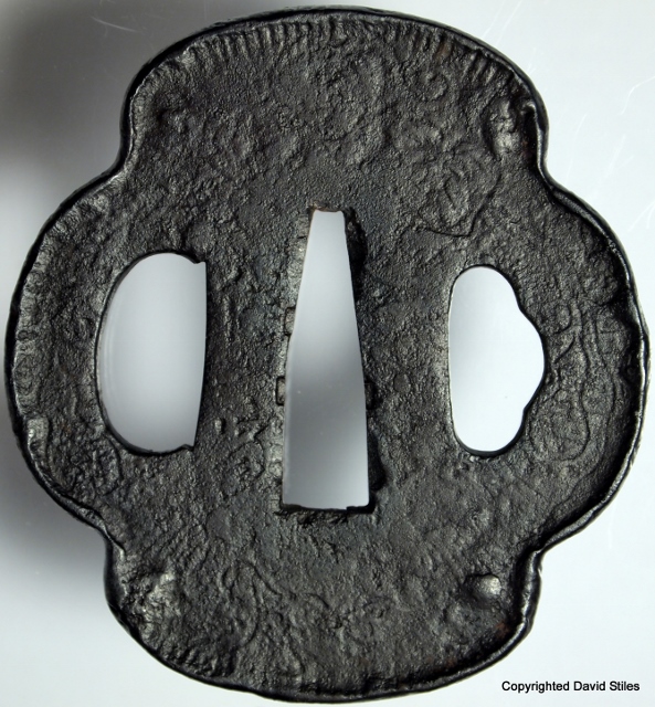

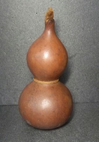

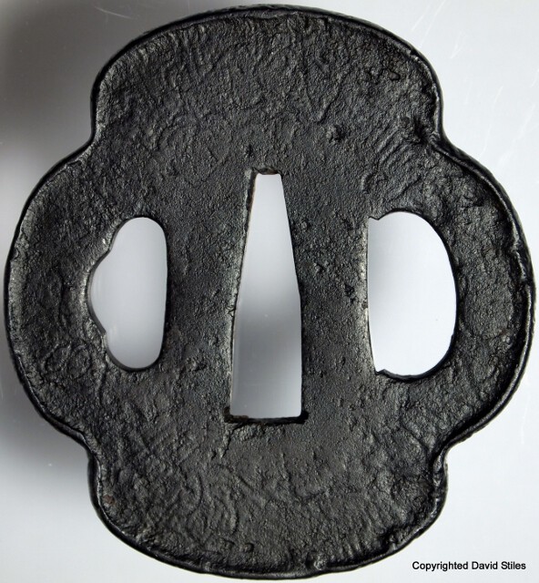

Soshin Posted August 2, 2014 Author Report Posted August 2, 2014 Hi Everyone, I was able to do some nice photos of the Nobuie tsuba this morning. Here are two photos once I update my website I will have many more all at higher resolution for everyone to see. The design done in very fine line carving (kebori 毛彫) is of a Japanese gourds along a finely carved arabesque pattern of vines and leaves. The gourd in Japanese is hyōtan an example is provided below. There is also a very nice (amida-yasurime 阿弥陀鑢目) filemark pattern very finely done overtop of the major design. The raised and turned up rim (uchikaeshi-mimi 打返耳) has a nice kikkō pattern along with the many iron bones. The second photo a rim view I think is the best view of signature which isn't very clear in my opinion. The signature was judged once as shoshin in 1969 by the NBTHK while is the collection of Mr. Saitō which is just fine for me needless to say I am not going to resubmitting this tsuba as I collect tosogu and not papers with Japanese written on it. The surface of the tsuba along with the rim display many large tekkotsu and a ceramic glaze like glossiness to the iron which is extraordinarily making me think yakita-shitate was applied to the surface. The measurements of this tsuba is 6.7 cm high by 6.2 cm wide. The approximate thickness at the seppa-dai is 2.5 mm and the rim thickness is 5.0 mm. The iron feels great in hand and is comparable to other early Nobuie examples I have examined in hand at a NBTHK lecture in 2011. P.S. This tsuba marks a milestone for me which I will use as a chance to branch off an explore other areas of tosogu besides old iron tsuba. Quote
Brian Posted August 2, 2014 Report Posted August 2, 2014 Congrats David, I think that is a beautiful tsuba. Definitely a step up. Brian Quote
Steve Waszak Posted August 2, 2014 Report Posted August 2, 2014 Nice guard, David. These wide-mei Nobuiye are a fascinating subset of Nobuiye tsuba. In the Haynes catalogue #7, tsuba #37, in particular, appears to be similar to yours in several ways (details of metal work, mei, sugata, etc...). I trust you've seen the wide-mei Nobuiye in Haynes' Gai So Shi as well? It seems there may have been more than one craftsman who made these (based on variances in the mei, anyway), but they aren't very commonly encountered. I hope you'll provide more photos, including of the ura. Good acquisition, David. Cheers, Steve Quote

Soshin Posted August 3, 2014 Author Report Posted August 3, 2014 Hi Chris, The kebori on my tsuba and Henry's is characteristic of all early Nobuie tsuba that have this type of line carving. It is generally shallow and very fine in width compared to kebori used later by other schools. Here is a good example of what I am talking about: http://blog.goo.ne.jp/tsuba_001/e/eabffb891e71dfa60a977206d088d10d. Hi Steve, I found this Nobuie tsuba while search the internet using Google. I think it has a wide signature: http://yakiba.com/Tsuba_Nobuie.htm. Quote
