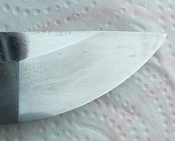

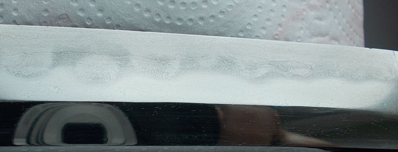

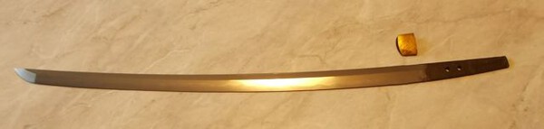

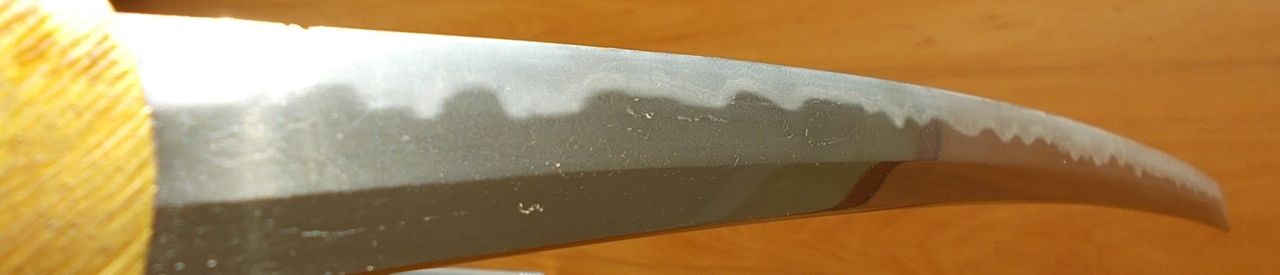

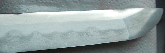

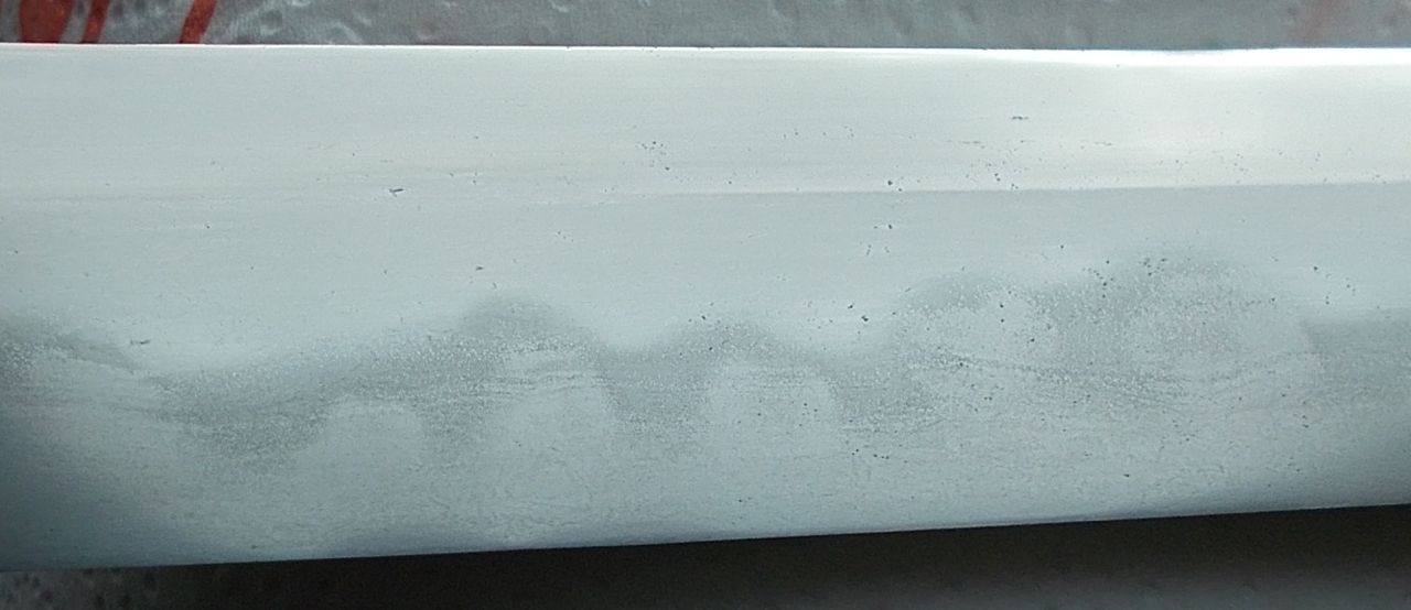

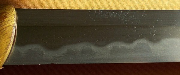

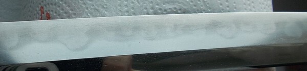

OK, gents, a friend has recenty acquired this sword. It is gimei, I won't tell you the fake signature, nor will I give any description of what I see in the pics (I don't have the sword in hand). I don't want to influence your judgement :)
Measurements:
nagasa 52.0 cm
motohaba 2.8 cm
sakihaba 2.0 cm
motogasane 0.6 cm
sakigasane 0.4 cm
sori 1.3 cm
Pictures are attached.
What is your opinion on this one, please?
Thank you for your time :bowdown:
Don't know, but it might well be... I don't think my friend will decide to sell before he has the members' opinion. He has mine, whatever it is worth...
Mariusz,
What the heck, I'll take a plunge and get a whack on the head :(
Gimei or not, it looks like a well-made sword. The hamachi suggests that the sword is not suriage. The hamon doesn't run all the way down to the nakago as one would expect of suriage swords. I would guess the gimei is of a famous Bizen smith in the Nambokucho jidai.
I am also guessing this sword is a shinto piece, probably Bizento. Smith? No idea.
Regards,
Hoanh
I'm guessing it's a rude and desperate gimei of something in line of masamune-muramasa-magoroku.
Of the blade i'm mostly thinking of end of Muromachi era Bizen (Bishu), one of the better-than-kazu-uchi-mono-quality.
Also thinking that it might be slight suriage. And if the pictures are not playing with me, the hamon ends before hamachi. Saiha?

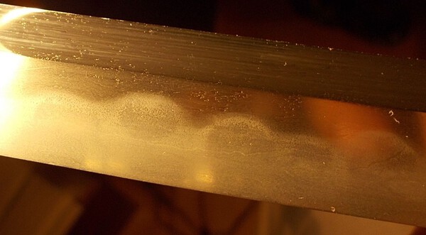

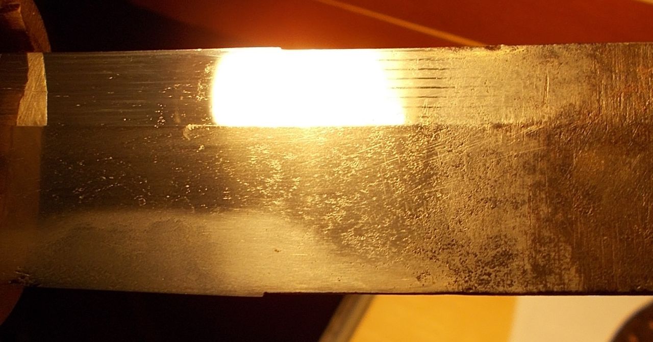

no visibilty of jihada or the shinogi ji makes it extremely difficult to judge/ guess. Guessing based on what can be seen:
Period Shinto
Possible school Hizen Masahiro based on the thunder cloud look choji and amount of nie
Could also fall in to a mid edo satsuma work with the long lines of nie running through the hamon
Probably way off but it is another possibilty
regards
Paul

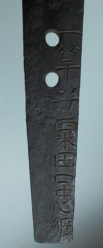

The hada is indeed invisible, says the owner. And here is the fake signature. Someone has apparently thought that this blades looks like Awataguchi Tadatsuna...
It's a well cut mei...
Lots of nie there...I always think this looks like it was sprayed on with a toothbrush :lol:
Shape looks a little awkward to me for some reason, but lots of actvity and things to look at. Overall, a nice sword. The boshi would suggest a Koto? but the rest resembles early Shinto to me.
Brian
Signature is fake, so this is no wonder Peter :-)
SHinto or shinshinto, anyone wants to make a speculation about the school? Pretty flamboyant hamon, with kinsuji, sunagashi and ara-nie, not too harmonious...
Maybe Hizen Yukihiro or Masahiro as above. The nie are really nice and delicate in the hamon but the jihada is not in keeping. I think too it does not look suriage and koto is ruled out.
