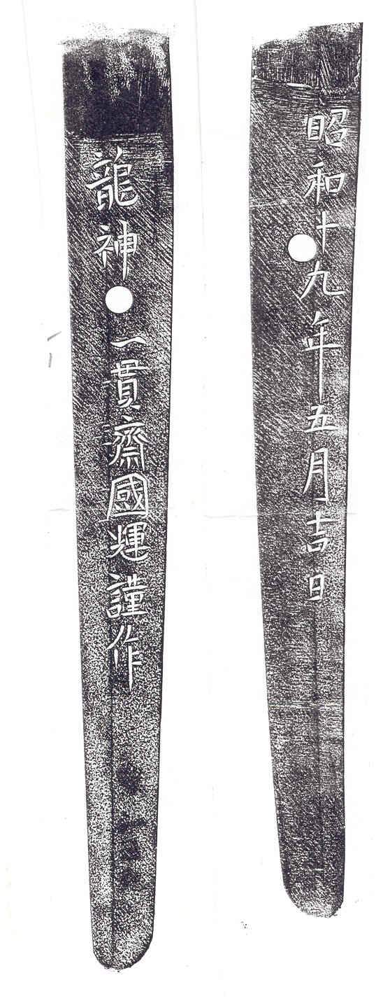

EdO Posted November 13, 2013 Report Posted November 13, 2013 thanks for that photo mr. Chan A Yasuhiro made in may 1945; that must really be one of the last ones he made during the war. Ed S Quote

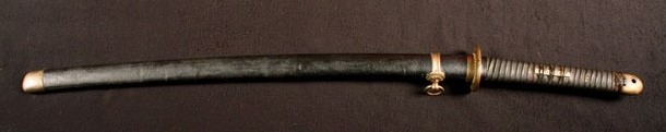

george trotter Posted November 14, 2013 Author Report Posted November 14, 2013 This is very interesting feedback...thank you all...Brian, I have never seen showato in the higher quality mounts, but many here have seen more Type 3s than me I am sure... I would really like to see that aoi art auction info on the Yasuhiro with black ishime saya and silver plated fittings ....I have a feeling that it was maybe a private order after leaving the Yasukuni, and while it may not answer this query, it would be interesting to see a pic of the mounts. I know this is of no real artistic importance in the great scheme of nihonto...but it is a historical point worth clarifying IMHO. Let's keep on searching... Regards, Quote

george trotter Posted November 14, 2013 Author Report Posted November 14, 2013 Quick question. Why is a Type 3 mount regarded as higher quality as a 98 mount ? Or did I read wrong ? KM The highest quality Type 3, with ishime lacquer on wood saya, with lacquered ito and high quality iron fittings are on a par with the same level of quality in Type 98. But the lowest level of Type 3, with crude iron saya, cheap ito and iron fittings are IMHO far below the lower level of Type 98. Also, Brian, I saw a "showato" in high end Type 3 mounts listed on Aoi-Art today, but when you look, it is clearly nihonto with the mei and most of the date crudely ground off...so, I guess it is still no...we don't find showato in high end Type 3. Regards, Geo. Quote
EdO Posted November 14, 2013 Report Posted November 14, 2013 Here Is a example of a higher quality or earlier type3 blade is by Ikkansai Kuniteru (student of Yasuhiro) Ed S 1 Quote
george trotter Posted November 17, 2013 Author Report Posted November 17, 2013 Ed san, that is very nice...almooost Yasukunito in Type 3, but not quite. I know this is off topic but your Type 3 mounts are very similar to this one of mine...even to the black ishime saya, plain kojiri (no blossom) and standard military issue fuchi My blade is by an unknown Tokyo smith, (is yours Tokyo?) so it may be that there was at least one special order Type 3 fittings mounting shop who did this style of work in Tokyo....both maybe came from the same mounter? Maybe we are getting closer also to answering the OP...I hope interested members keep searching.... I'd be interested in seeing more/knowing more about your Kuniteru Ed, but maybe it is too off-topic for members (members must be sick of seeing pics of this Type 3 of mine again), but as this is a significant step in the study of Type 3 mounts IMHO, I'd like to continue. However, please feel free to contact me by PM Ed. Thanks, nice sword/mounts. Quote
EdO Posted November 17, 2013 Report Posted November 17, 2013 Hi George, yes think it's Tokyo made the mei is completely written the same way as the Kunimori (Yasuhiro) mei. Ed S 1 Quote
george trotter Posted November 17, 2013 Author Report Posted November 17, 2013 That mei looks very familiar for sure Ed...is Kuniteru a name used by Yasuhiro? like his Kunimori? I couldn't find a link of that mei Kuniteru in my Ikkansai lists of smith lines. I must say also that the kojiri on your saya is identical (in the fancy outline across the top) to the kojiri on my Type 3. Very interesting also that your blade is dated 1944, same as mine....same mounting shop? Regards, Quote
EdO Posted November 17, 2013 Report Posted November 17, 2013 Hi George, no it was a student of Yasuhiro there is a slight variation in the mei if you look carefully. I found that another blade of Kuniteru was sold in Japan a couple of years ago and they had the info on him; before that I wasn't also not able to find anything about him but because of the mei I already suspected that there had to be a connection between this two. and yes there is a chance that it was the same maker of the koshirae. Ed S 1 Quote
cabowen Posted November 17, 2013 Report Posted November 17, 2013 Rare mei. I don't think I have seen another. Must have worked with Miyaguchi at the Okura Tanrenjo. Probably also made of yotetsu like the Kunimori mei Miyaguchi blades. 1 Quote

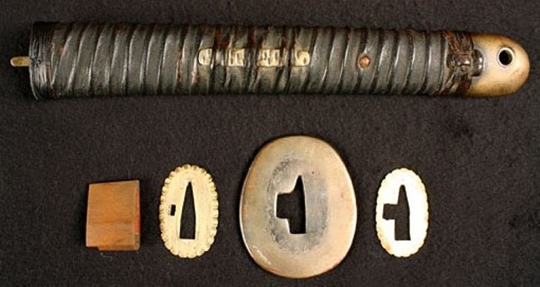

george trotter Posted November 17, 2013 Author Report Posted November 17, 2013 Yes, rare I think...I immediately went to your Ikkansai line list Chris, but no, he wasn't there...or in my other references...but I am sure I have seen this mei before somewhere, or maybe my old brain is thinking Kuniteru for Kunimori. Have you seen these gangimaki style tsuka on Type 3 koshirae before Chris? Regards, Quote
cabowen Posted November 17, 2013 Report Posted November 17, 2013 Yes, I think I have seen it before but have never paid much attention to gunto koshirae, I am afraid... Quote
