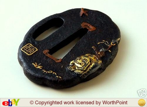

Ludolf Richter Posted March 19, 2013 Report Posted March 19, 2013 My friend owns a Tsuba which has a seal,I read as Tôu.I have a lot of examples in my database with Yasuchika (and generations) signing with "Tôu" (starting when he became a lay priest).The difference with the above Tsuba is the upper end of the character on the right side:horizontal stroke versus trident.According to Haynes there may have been an artist with Go Tôu,working in the 1st quarter of th 19th Century:No info and pics available. Has anybody seen a Tsuba with the above Tôu?Ludolf Quote
christianmalterre Posted March 19, 2013 Report Posted March 19, 2013 Dear Ludolf are you shure this Tsuba shall be Yasuchika? I just wonder as it´s whole stylism and execution does not make me feel to be an Yasuchika workmanship? Of course-i am not a Kinko-Guy-such speaking i can be very wrong of course! At least-it does not match anyways to all those Yasuchika i do have depicted in various of mine books...? (may this seal ben regarded as an purely aesthetic element rather?) This Elephant equally,does remember me rather taken from the woodwork of "Ko-Kinkoised" or "Gotoised" than comming from this very school of Yasuchika´s stylism...? just mine feeling... The Kinko-Front does but certainly know better... Christian Quote
John A Stuart Posted March 19, 2013 Report Posted March 19, 2013 I have not seen Yasuchika's seal rendered this way. This was sold via e-Bay without papers to support the provenance. The work does not seem typical, so, I am reticent to believe this has any connection to Yasuchika/Tou. This is a very thick tsuba. John Quote

John A Stuart Posted March 19, 2013 Report Posted March 19, 2013 That's likely, another Tou. BTW, to avoid confusion the tsuba I pictured is not the one the OP posted, but, very similar. John Quote

Ludolf Richter Posted March 19, 2013 Author Report Posted March 19, 2013 Thanks to all, I believe,John's Ebay-pic is very similar to my friend's one,only -as it looks for me-it is made of iron.There is no doubt about it for me,that the artist is not Yasuchika.Also the elephant is quite different from Yasuchika's one in my database:look at the pics.There is another elephant from the Nidai.Ludolf Quote
