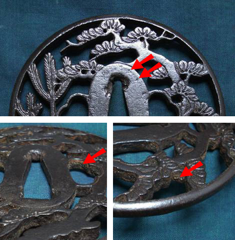

Just wondered if this piece is a Higo or just a reproduction/copy?
Dimensions are round (82x82) and 4.5-5.0 thickness (translated description shows both so perhpas the mimi is thicker or narrower than the seppa dai_
Thanks!

Yes, seems a common motif among the Higo group and the seller made reference to Nishigaki in the description. Though translated Japanese is hard to understand.

Do you mean it's literally been stepped on?
LOL -- sorry -- '80's terminology -- think 'Scarface' -- what I meant was that it's been worked on in some way. Look at the glossy patina -- it just looks off. This 京正阿弥 is Kyo Shoami, for what it is worth. Maybe Curran can chime in on this one? He knows this stuff like the back of his hand!

As to the tsuba and the seller- there is something funny about a lot of his pieces.
I don't know what he does, but he does (mystery XYZ) to many of them. They look lightly sandblasted and greyed somehow, then possibly
given a light wax coat applied. While some people, including shinsa judges, advocate use of light wax coating- I hate the stuff and will try to gently remove it if it won't damage the tsuba in any way.
Tsuba isn't Higo. I'd be inclined to pin it to a specific Shoami school.
Pete said Kyo Shoami, so it works for me.
Kyo shoami certainly fits based on what I read. Here is another one from same seller and a Higo from the boston mfa site (better version). Would we think this is kyo shoami as well?
Higo? Possibly Nishigaki?
Good match up with the design of the one in the Boston MFA. Major museum attributions are usually decent, but not infallible.
Looks right, but then again we have the problem of weird pitting in places and the applied grey w/ wax coat?
This guy's stuff is either real or would fool a lot of us who have been collecting a while, but the condition is something to ponder.
Tsuba might be fine underneath whatever was applied, or might not.
Yeah, the condition and surface treatment was a bit iffy. The 1st one sold for the buyout price and the 2nd one sold for less. I passed as I have my eye on a papered Akasaka at the moment.
Yes, does cause wonder. The seams can be checked with a probe to see if they are adhesions [crud] or excess metal. It can be hard to tell pitting from casting flaws without a physical exam. John
