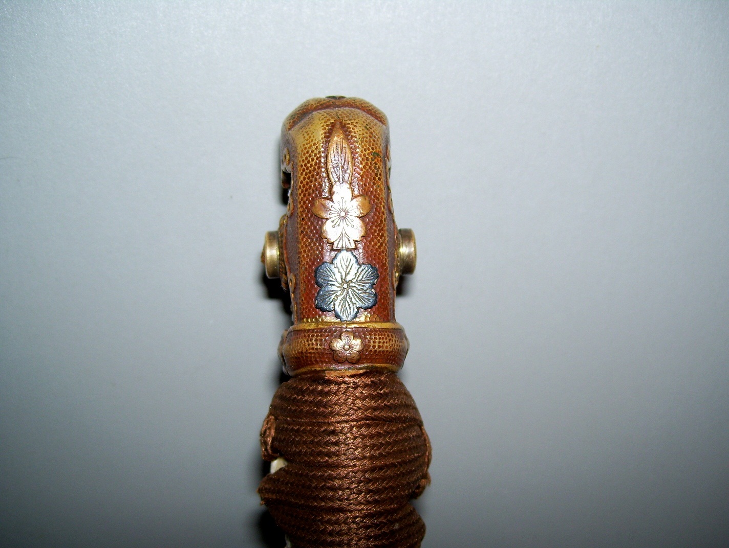

judorichard Posted November 13, 2012 Author Report Posted November 13, 2012 Here is a picture of a silver mon on the kabuto-gane. If anyone knows which family/clan it is please let me know. (It looks like a Jasmine but I'm not sure). Richard MS Quote

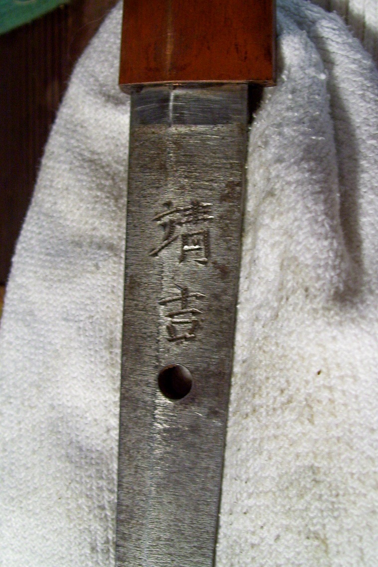

Brian Posted November 17, 2012 Report Posted November 17, 2012 Richard, In pic 4....maybe it is just the photo...but is there a slight step where the filemarks end? Asking, because it does look like the whole surface of the nakago might have been filed down to remove the old markings, and the new kanji look very fresh to me...even showing "pillows" around the kanji...especially the date. If these is no step, and a natural progression from the filemarks to the blade area, then this is just the pics giving a false impression. Brian Quote
judorichard Posted November 17, 2012 Author Report Posted November 17, 2012 Hi Brian, No, there is not a step. It is my poor photography. I will try to take better pictures this weekend. If you could recommend a good resource (website etc.) for help on photographing swords I would greatly appreciate it. My pictures really don't do this sword justice. I would like to post better pictures. Best regards, Richard. Quote
judorichard Posted December 3, 2012 Author Report Posted December 3, 2012 Brian, I have taken some better pictures that show the nakago in more detail. The mei can clearly be seen as can the yasuri-me. The yasuri-me are yoko yasuri. There is not a step where they end so I believe the mei is original. Let me know what you think. To date I have been unable to take good pictures of the sword blade which is a shame because it has a very attractive yakiba which I would classify as notare-midare although at first glance it appears to be sugu-ha. The simple advice of "search the board" (translation: stop being lazy! ) was correct and I found a useful thread but I found it a bit too technical for me :? . I'll have to do some more reading and perhaps take a photography course. It will therefore be a while before I can post good pictures worthy of the sword. Richard MS. Quote
