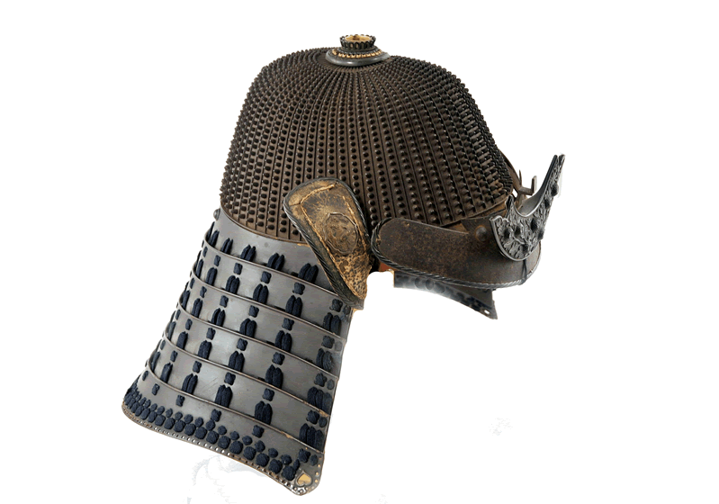

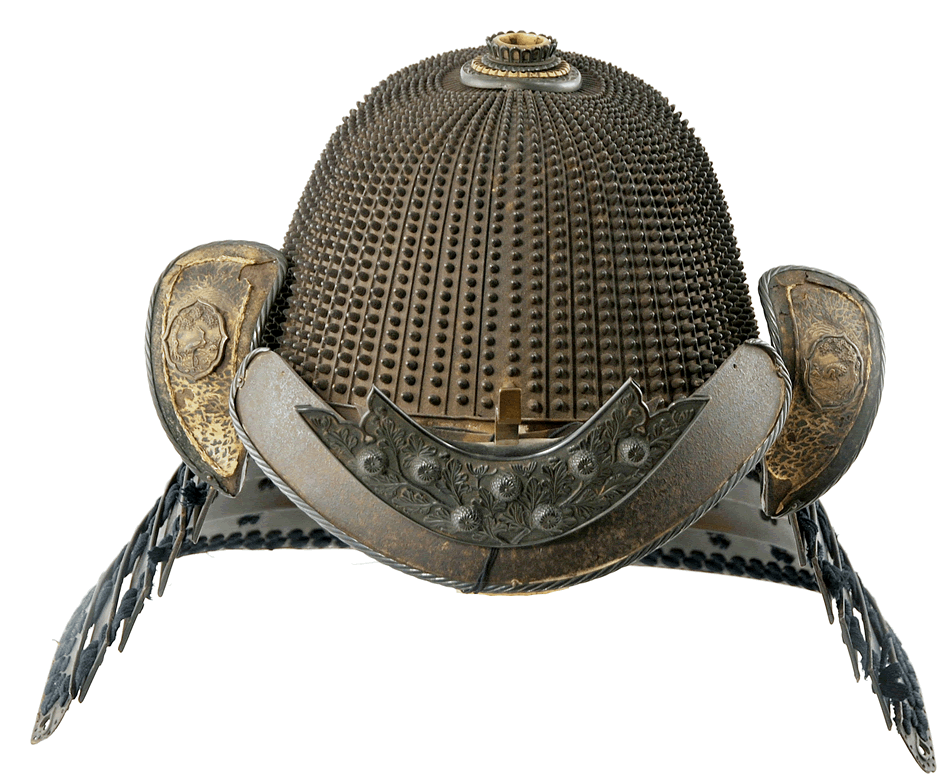

Kabuto any thoughts
Hinawaju
Wow, serious stuff!
Nagamichi is considered to be one of the best makers of koboshi kabuto during the edo period. Working dates are around 1700-1750. Unfortunately, he never datet his work.
I have a very similar one.
Guy, I too have an armour by Nagamichi with a very similar helmet to this. Mine too has the nawa fukurin in shakudo. Clearly he worked for very wealthy patrons, but I have never been able to identify the kamon on mine. The kuwagata dai on yours is superb.

Very nice hoshi kabuto Guy, congrats.

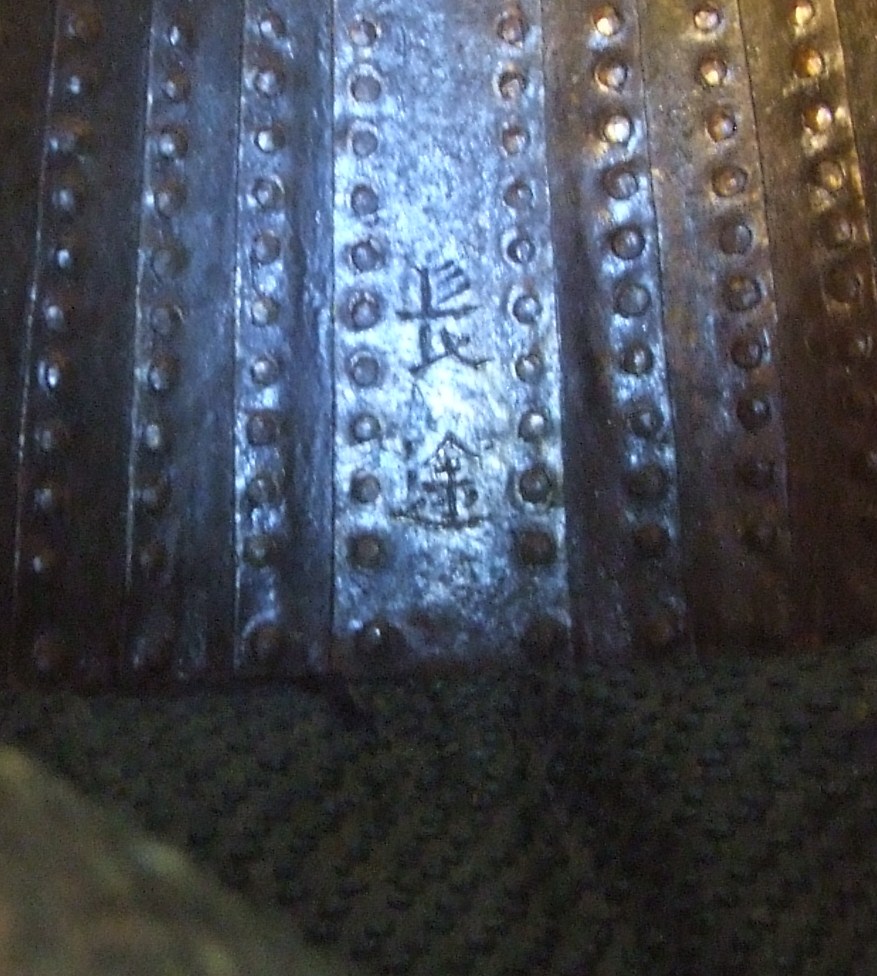

I see that you wrote Nagamichi with 長道, shouldn't it be 長途 ? or am I getting mixed up here.
Very nice Luc !!!

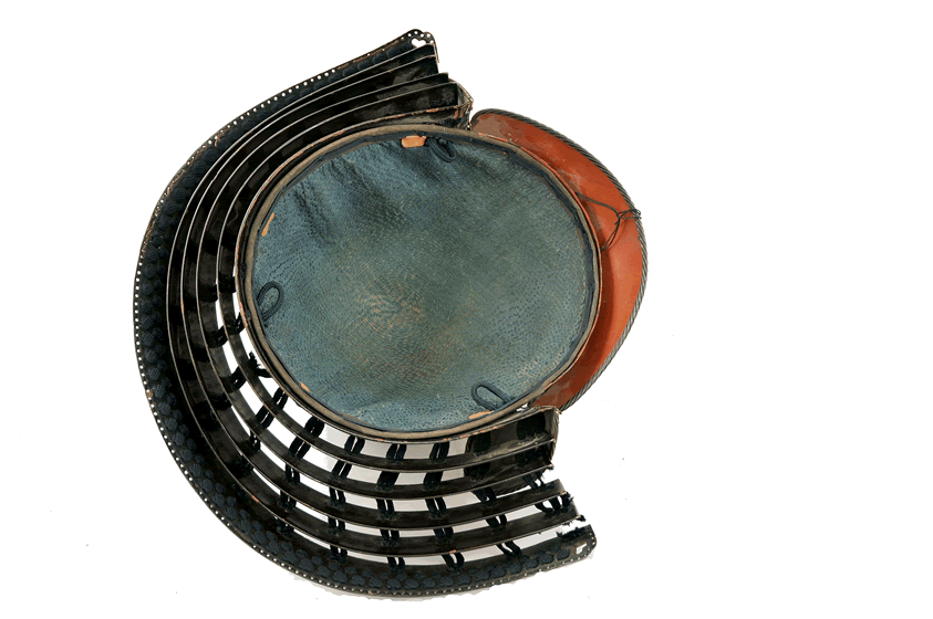

PS: Guy, is the signature on the back plate ? I didn't notice an opening in the liner to view the signature ....

Please allow me to say as an amateur however, that I really like your helmet, Guy, and now having seen Luc's excellent example of Nagamichi work this name looks as though it might stick in my poor brain. Congratulations. :clap:
thanks for the compliment gentlemen,

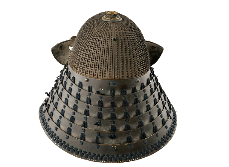

Paul, here some specific caracteristics of Nagamichi:
-the shape of the hachi is very elegant, but different from Saotome, the so called san-saku or Myochin. I recognise them all on their shape, even when they are remounted.
-perfect alignement of the koboshi, comparable with the best Saotome.
-always 3 rows of koboshi on the frontplate.
-boars eye on the maedate-dai
-fine dark patina
-no shiten no byo
-often with russet iron shikoro, invisibly laced.
There was an armor with Nagamichi for sale at Christies for sale in 2009 i think. They did not know it because the ukebari was closed.
someone I know bought it and had a look inside... perfectly signed Nagamichi...

Reading Orikasa San's article on this smith I understand that there could be more than one generation of this name, using both styles of signatures mentioned in this thread: 長道 and 長途
Do you share the same opinion Luc ?
Guy, do you have any means of checking the signature on your helmet to confirm which kanji was used in the signature ?
Thanks.
Paul.
