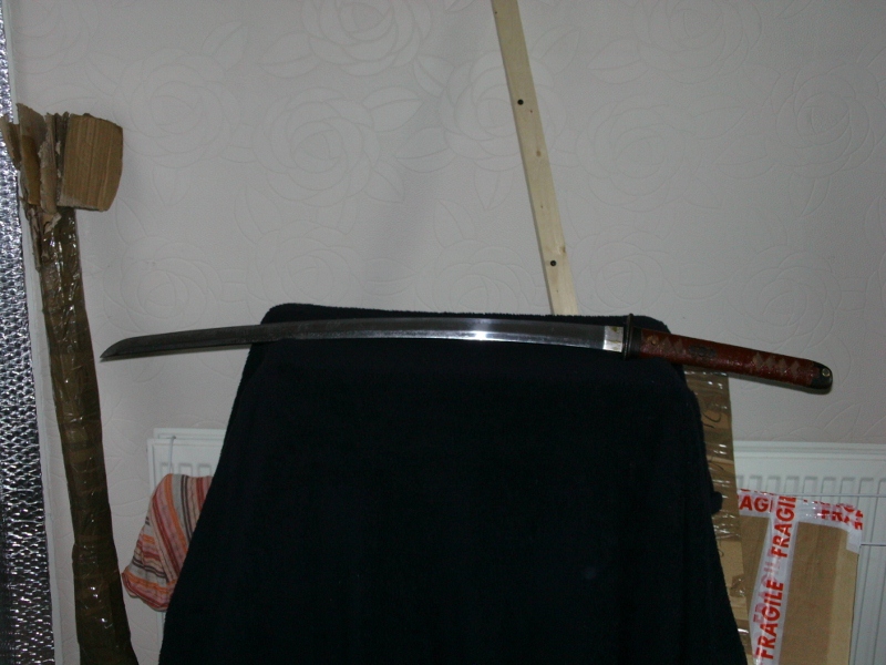

isidro305 Posted September 14, 2012 Report Posted September 14, 2012 this is a NOSHU JU KANETOSHI i have se is a god gendai smith and low showato 2 y have a question wend I have a question is the most inportante as I am new to be traditional made, the hamon always have to be white or can be like this thanks isidro: Quote
cabowen Posted September 14, 2012 Report Posted September 14, 2012 It's difficult to tell with certainty from pictures, especially only these two, but I would say there is a good chance it is traditionally made. Quote
isidro305 Posted September 14, 2012 Author Report Posted September 14, 2012 thanks I think it not traditional no star and has to have both seki and star isidro: Quote
chrisf Posted September 14, 2012 Report Posted September 14, 2012 You may have misread that information.A blade without any stamps may be a gendaito or non-traditionally made blade,the blade in question I believe to be a gendaito. Quote
David Flynn Posted September 14, 2012 Report Posted September 14, 2012 Star stamp means the this is a RJT (Rikugun Jumei Tosho) and the sword is an military commissioned Gendaito. The Seki stamp means, the sword has come through the Seki arsenal and is probably non tradionaly made. Lack of stamps, usually means a privately commissioned sword.. Quote
shingen Posted September 15, 2012 Report Posted September 15, 2012 Isidro, Could post a few more photo's of the blade? Quote

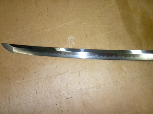

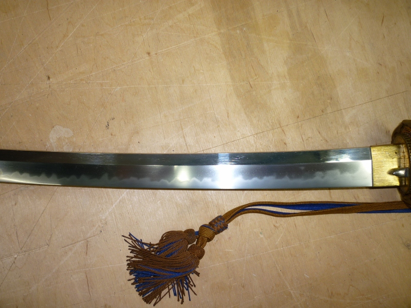

chrisf Posted September 15, 2012 Report Posted September 15, 2012 Two type 3 gunto sold by ebay seller 'tictocnmore',both appeared to be gendaito,one by Kanetoshi the other by Shoda Masafusa,$1277.77 for Kanetoshi,$1025 for Masafusa which to my mind is not a lot of money but as I live in the UK am barred from bidding on them thanks to the idiocy of ebay.uk. Quote
chrisf Posted September 15, 2012 Report Posted September 15, 2012 Meant to add that Kanetoshi mounted in metal saya,Masafusa in brown,rough finish lacquered wood. Thoughts anyone? Brian (bmoore) these are two of the swords that I made mention of in my response to your last Kanezane post. Quote
george trotter Posted September 16, 2012 Report Posted September 16, 2012 The blade by Kaneyoshi (rust free blade and tang in pics) looks promising. Here is a prime example of what Chris Bowen and I were discussing elsewhere in the last day or so (Seki and Yasukuni schools workmanship ratings)...here is a Seki work by Kaneyoshi that looks quite competent in the blade , but where the finish of the tang and the mei cutting is un-appealing. If only the Seki smiths had spent more time on the tang finishing and learn to write/cut mei elegantly they would probably have gained more recognition with gendaito collectors ( member Dave Flynn and I being some of the few? here who like them ). regards, Quote
Kai-Gunto Posted September 16, 2012 Report Posted September 16, 2012 The blade by Kaneyoshi (rust free blade and tang in pics) looks promising. Here is a prime example of what Chris Bowen and I were discussing elsewhere in the last day or so (Seki and Yasukuni schools workmanship ratings)...here is a Seki work by Kaneyoshi that looks quite competent in the blade , but where the finish of the tang and the mei cutting is un-appealing. If only the Seki smiths had spent more time on the tang finishing and learn to write/cut mei elegantly they would probably have gained more recognition with gendaito collectors ( member Dave Flynn and I being some of the few? here who like them ).regards, The blade dosnt look like its rust free? Quote
george trotter Posted September 16, 2012 Report Posted September 16, 2012 Hi Thomas, There are pics of two blades/nakagos. The rusty nakago is signed Masafusa...it belongs to the blade pics with the small black rust spots. The secoind nakago is signed Kanetoshi...it belongs to the pics of the clean blade . It is this clean blade/nakago I was commenting on. Regards, Quote
k morita Posted September 16, 2012 Report Posted September 16, 2012 Hi George san, The Masafusa blade is Shoda(family name) Masafusa.荘田 正房 Quote
george trotter Posted September 16, 2012 Report Posted September 16, 2012 Hi Kiyoshi san, thank you...Masafus was a good maker. I think the Kaneyoshi (Noshu ju Kanetoshi) is maybe Shoka Kaneyoshi, chuge saku in Tosho Banzuke 1941 ( I think not Murayama or Mori)...I think this Shoka Kanetoshi became Rikugun Jumei Tosho. regards, Quote
chrisf Posted September 16, 2012 Report Posted September 16, 2012 Thomas/gunto,apologies but my fault for posting in wrong order but I think there are caps at bottom saying which is which. George I read your discussion with CAB on the merits of two different schools of gendaitosho and can see the merit in both sides,in the case of these two blades however,I have to say that I much prefer the Masafusa with a softer more organic looking hamon,I find that of the Kanetoshi in comparison a bit 'stilted' and contrived but just as well we don't all like the same thing! Despite the 'downers' ebay has and has had some decent looking gendaito to view. Quote

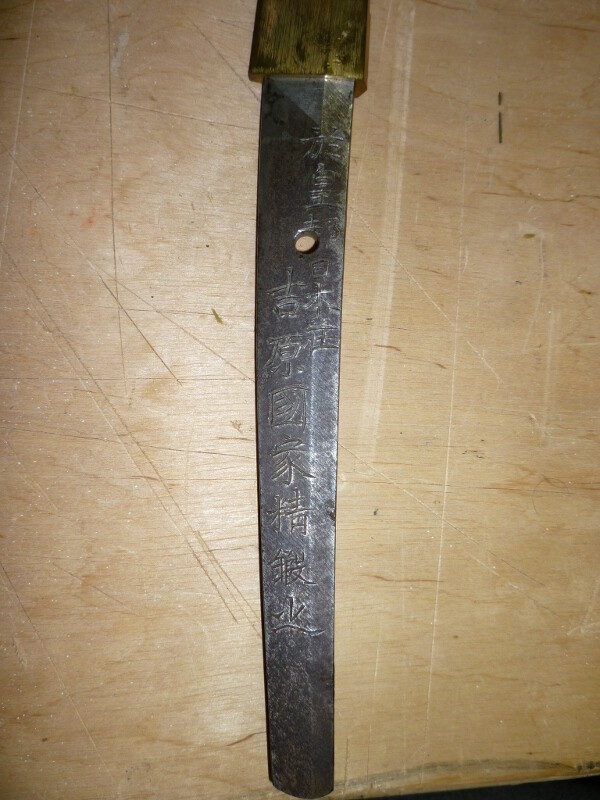

cabowen Posted September 17, 2012 Report Posted September 17, 2012 Hamon sounds interesting but no, not something specific to the Kurihara school.... Please post more info on the Kuniie please! I have always been fond of his work. Quote

george trotter Posted September 18, 2012 Report Posted September 18, 2012 Hi Chris, Nice Kuniie...lucky find. While saying never say never (or always) with nihonto, I think your comment is pretty fair. My star stamped blades are essentially gunto in sugata, but with the tosho's "school characteristics" being visible, ie the sugata conform to the RJT scheme rules for Army acceptance. I have two blades with non-gunto sugata and these are both private order blades. Having said this, I am not put off by gunto sugata as that is a part of the history/era characteristic. A legitimate kantei point IMHO. One army smith I have noticed who nevertheless always seems to produce a fine sugata is Hara Okimitsu of Shimane...judging from the few I have had in hand. regards, Quote

chrisf Posted September 18, 2012 Report Posted September 18, 2012 Again,I agree with you George,I have no problem with the normal gunto sugata it was just really nice to find a sword with good shape,that said the Masatsugu is quite pleasing.I've only had one Hara Okimitsu in hand,provincial saleroom and whipped off the tsuka and then slowly drew the blade,excitement building until I reached the bloody great fukure! Have taken umpteen pics trying to get Masatsugu hamon and failed miserably but here's a look anyway... Quote

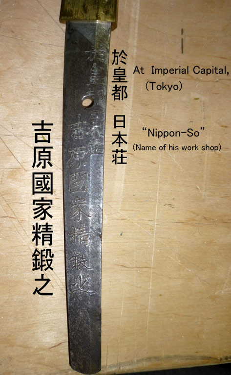

k morita Posted September 19, 2012 Report Posted September 19, 2012 Here is a pic of Kuniie himself. Quote
george trotter Posted September 19, 2012 Report Posted September 19, 2012 Yes, nice sword indeed. It looks like my favourite battlefield length, about 62 cm? Nice pic and translation Kiyoshi san. I love the gendaito and its history! regards, Quote
