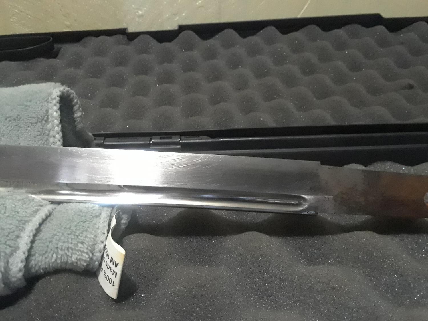

ChrisW Posted October 11, 2018 Author Report Posted October 11, 2018 Sorry for the wait, all! Here are a few pictures of the suspected Kyu Gunto blade, as far as I can tell, it matches the profile to a T. I think I also did a decent job of capturing the hamon. The blade is mumei with no markings of any kind that I can detect.
PNSSHOGUN Posted October 11, 2018 Report Posted October 11, 2018 Hi Chris, yes that is a machine made combat sword for the Kyu Gunto, I have one in Field Grade mounts. I don't know how lucky you will be finding the right mounts, one thing to look for the is the relative lack of Sori in the Saya.

PNSSHOGUN Posted October 12, 2018 Report Posted October 12, 2018 Machine made swords of this era were usually drawn from a single billet and either through hardened or oil tempered using some variation of the Murata-To process. I have no idea who or exactly how these were made but they do have a tempered edge and mine at least is very well made, especially compared to machine made swords made during WW2. Traditionally hand forged blades that are very similar to these swords exist as well but they have a real Hamon and Hada. If you take the sword out into good sunlight you will see there is no discernible activity in the Hamon or steel, as the Hamon is etched on.
