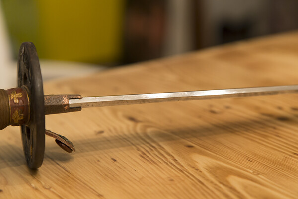

I recently was lucky enough to acquire what I thought was a basic Japanese Gunto from WW2 (Maybe a Type 98 I thought). The swords scabbard has seen better days and is in rough shape. The swords Tsuka shows signs of use and appears to be typical WW2. The Tsuba looks much older than the sword and is obviously not a typical commissioned guard. The actual blade seems to be in good condition (few spots but no serious issues, chips or dents) as well as it's been sitting in a box in a basement since it was brought back from WW2. After a couple days of having the sword I became more curious as to it's origins since the tsuba looked 100 years older than the rest of the sword. I thought maybe this was an older family blade and tsuba that was re-purposed for the Japanese military. I researched how to ID the sword and came to the conclusion I would have to remove the handle which was nerve wrecking but was really easy to do. My wife laughs at me but I always wear think rubber gloves when holding the sword.
Anyways, I took some snapshots of the mei and researched the kanji online. After a bit of research I got lucky and found a similar sword which bare similar kanji which led to me finding more and more and more... examples. Basically I have, I think, a pretty typical but not rare Yokoyamo Sukesada. From what I have researched (and I know basically nothing on these topics) this region, Sukesada, produced a large quantity of swords many years ago. However, all of the similar swords I have seen online have a kanji for a clan (all being "Fujiwara"). My sword has a straight line of kanji with no clan marking. I think it reads "bi zen kuni yoko yama ko zuke dai jo suke sada". I took photos of the one side of tang. I was 95% sure I did not see any markings on the opposite side of the tang so I took no pictures (now I am questioning if there were markings on that side since I am not 100% sure). I also checked the tsuba for any markings but did not see any.
Any information anyone might have as to the age or any other details of the blade and tsuba would be much appreciated. I took these photos with an iPhone (Sorry for the quality) but will snap more photos with my dslr if anyone would like more photos.

Hi Chris,
Good work; nice sword.  You have the mei correct.  Kozuke Daijo Sukesada would date around 1860; the tsuba is most likely older than that.  This is important enough a name that forgery of signature is a possibility but at 1st glance I see no red flags.
It would help to see more and better pictures of the blade; the work must support the signature.
Make sure you're up on care & etiquette:  http://www.nbthk-ab.org/Etiquette.htm
Congrats,  Grey

Grey & Nihonto Members,
As you requested Grey I took a few photos of the blade. I am looking forward to what your conclusions are!
Once again, thanks for your time,
Chris U.
Hi Chris,
this smith and his signatures has been discussed here plenty times. You should find good information and pictures here and hundreds on google. What I can say though is that that the signature in many aspects does not match the "famous" Shinto Kozuke Daijo. There is neither Fujiwara nor Osafune in the mei, the mei is just on one side and the general style especially the Sada kanji does not match.
But as others have said before, this was a smith who was faked by a lot of contemporary forgers.
Now there is a later smith mentioned in Hawley who worked around 1750. If he exists at all(I could find no confirmed reference mei), he might be a match for your blade.
Grey, you probably meant 1680, not 1860.
Best, Martin

Hi Chris,
Hard to judge age just from the pictures; not always easy even with the blade in hand.  If the signature is gimei it could have been applied anytime after Kozuke Daijo Sukesada became extablished; there have been signature forgers nearly as long as there have been signed blades.  While it is possible that the blade predates the time of Sukesada (the forger chose an earlier blade on which to practice his art) most like the blade is later.  If I had to guess, if we're sure the signature is wrong, I'd say the blade dates to Shinshinto time (late 18th or 19th century).
See how many signatures of Kozuke Daijo you can find online, print them out, and compare yours to them.  When you find one online see what the poster has to say about hamon, hada, length, curvature, and other aspects of the true Sukesada's; how do they compare?  You're at the front end of a fascinating study (Nihonto) if you choose to pursue it.  Have fun.

Hi Chris,
There were established schools of forging work but also a lot of free lancing in the forged signature business.  It is my understanding that either of the 2 NTHK organizations in shinsa, if they decide the signature is bogus, will give their thoughts on who or which group actually made the sword when they fail it.
But, if the sword was well enough made to get an interesting attribution from a shinsa panel it probably would have been signed with a real signature.  Odds are you'll get something like "Mid Edo Period" or "Late Muromachi Mino" or something else that doesn't really tell you much and it will have cost you the shinsa entry fee.  If you can get to a sword show there will be lots of more knowledgable collectors to give you their opinions and it won't cost anything.  You'll probably learn more this way also.
