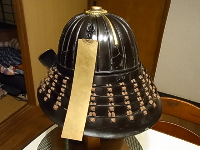

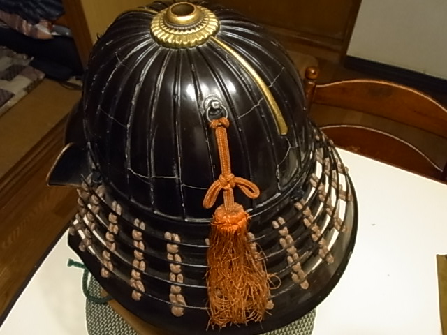

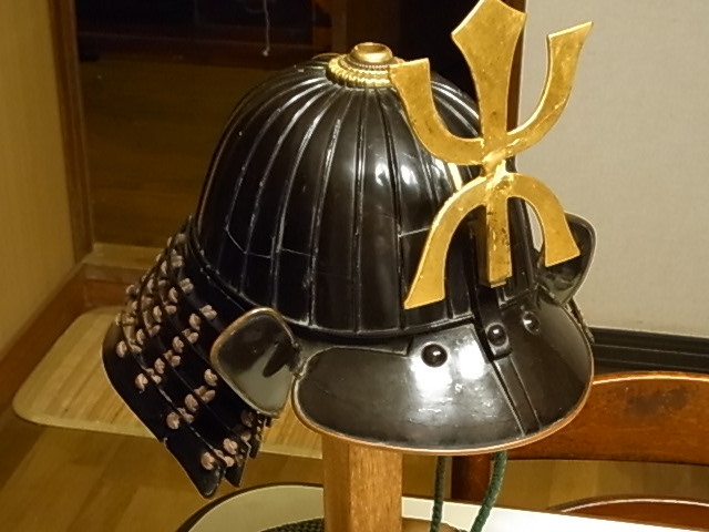

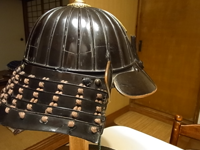

Justin Grant Posted July 2, 2012 Report Posted July 2, 2012 With the expert help of many including Ian, Moriyama Sama, Thomas, John, and Uwe, the Mei was translated in the Translation Section, so I thought I would post some photos. This is not a high end item, but a good example of a late custom kabuto. I don't have a date on the menpo, it is not a matched set. The maedate is a modern piece, just added for flair. The shikoro are leather faced. The mabizashi is doubled over the stock zunari peak. The bowl is gold urushi on the inside. It also has a hanger (forget name for it) on the back for an agamaki bow. The bowl is sabiji. Once I figure out where the maker worked and what school, I'll be jazzed! Thanks Justin PS, these are the sellers photos. Quote
estcrh Posted July 2, 2012 Report Posted July 2, 2012 Any sign as to if this was the original finish or if the whole kabuto was previously lacquered. Here is a link to the Wikipedia commons Category:Kabuto (individual parts) http://commons.wikimedia.org/wiki/Category:Kabuto_(individual_parts) Kasa jirushi no kan, A ring at the back of a Japanese helmet (Kabuto) designed to carry a small identification flag, but on later helmets an agemaki bow was tied to the kasa jirushi no kan.) Quote
Bugyotsuji Posted July 2, 2012 Report Posted July 2, 2012 Recently I bought a Kabuto, so it was interesting to see what you have there Justin. Congratulations. Nice link, Eric. There was a last-legs molting/moulting bow and tassel tied to my Kasajirushi-no-kan, which I was advised to whip off and substitute with a real Kasa-jirushi, (quite similar to a Kata-jirushi or a Yari-jirushi). The Kabuto seems to be based on an older Zunari bowl, but it has been covered in 24 tsuji, with black lacquer and topped with a Hachimanza. It also has a Mabisashi a little like yours, Justin. Shikoro and odoshi-ito in good condition. No Mei, sadly. I have replaced the Ukibari (not Uke-, I believe) and the Shinobi-no-o as I plan to use this kabuto on display days and alternate to lessen damage to the Namban toppai. Quote
Justin Grant Posted July 2, 2012 Author Report Posted July 2, 2012 Eric- No indication that it was ever anything more than Sabiji. The red urushi is still on the inside of the mabizashi, and the gold is still very present in the bowl. There are no signs of urushi under the shikoro, and the odoshi looks original, so I don't think it was removed and then the lacquer removed and then re-laced. Piers, would love to see you new find. Quote
uwe Posted July 2, 2012 Report Posted July 2, 2012 Hi Justin, interesting kabuto! Looks a bit like a late copy of that hineno-bachi, published in J.C. Carbonnier`s book, page 52/53. Congrats Uwe Quote

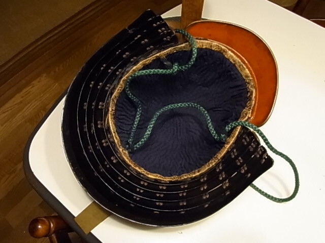

Justin Grant Posted July 2, 2012 Author Report Posted July 2, 2012 Piers, Did you make your own liner? I need one for my kabuto. Pointers welcome! It is hard to see the Zunari in your kabuto. The transformation is unreal. Quote
IanB Posted July 2, 2012 Report Posted July 2, 2012 Justin, Making an ukebari (that is how I have always spelt it) isn't difficult, just infinitely tedious. Cut two squares of linen / hemp and if you have some, a similar square of red silk chirimen crepe for the inner surface. They need to be considerably bigger than the diameter of the bowl, say about 2' a side. Stack the two hemp pieces at 45 degrees to each other and then add the silk if you have it. Mark the centre and start sewing. For some reason I have never really fathomed, the originals are sewn with green thread about the thickness of crocheting thread. I suspect that the original makers bought thread by the 10,000 momme from a wholesale supplier who only had green in stock . Start in the centre and just do small in-and-out stitches in a spiral spaced about 3/16" apart. It goes very quickly at first and then slows down as the spiral get bigger. When it is about 6" across, start pulling the thread a little as you go along to form small puckers in the cloth. Carry on doing this until it is big enough. I found it easiest to form it on a polystyrene wig block to get the shape. Good luck, it takes a long time. Ian Bottomley Quote
Bugyotsuji Posted July 2, 2012 Report Posted July 2, 2012 The very first liner I did myself, conscientiously, generally as per Ian's instructions above, until my wife rather firmly said she would take over. When finished you could see my minute stitching to the half-way point, beyond which it started to go large wild and wobbly as she discovered what she had taken on. :lol: (Shortly after I sold the kabuto, at a loss, it appeared in an antiques shop with a shockingly high price attached, and immediately sold, so someone must have appreciated the handiwork.) Since then I have learned a trick or two, such as cutting the rim off a particular type of pressed cotton hat and using the crown etc. In this case I was handed a ready-to-fit uke-bari (I have seen and heard both terms uki- and uke-, and each makes its own kind of sense but you are right it seems!) and told to use a rubberized quick-drying glue, cutting three small slits for the shinobi-no-o loops. I do not know where these ready-mades are made but heard that they cost about 50 dollars each. Possibly Kyushu. I'll ask. Anyway I did it in one evening, much to the surprise of the members, but it scared the life out of me having to rely on my native wit and derring-do, above all not wanting to harm the Kabuto. I have a big head relative to this rather small Kabuto, so I had to set the cloth deep into the hachi. The construction of the above Kabuto looks as though it has to be overlapping iron triangles, but... it is actually 'neri' and nuri, paste and lacquer applied over the zunari (now completely hidden) and fashioned into that style. There were unused holes in the Zunari suggesting that the hachi itself may be older, used at a later date as a base for the present style. Quote

Justin Grant Posted July 3, 2012 Author Report Posted July 3, 2012 And Justin, I asked, and apparently these liners are sold over the J internet! Piers, would you by chance have a name or a link? I have no idea what to search for. I did secure a rather old (1920's) Asa (Hemp) male kimono online, and plan on using it for a liner if I have to make one. Ian, I think the reason the katchushi use such thick thread is that Hemp only comes in small rope sizes! I have looked all over the web and the smallest I can find is 16 gauge! I called the local "hippie" shop in town, they are all "hemp" people, and they too have never seen a decent small sewing type hemp thread, and they use cotton thread when making the "tree hugger" outfits. Maybe the thicker thread added strength and toughness? Quote

Justin Grant Posted July 4, 2012 Author Report Posted July 4, 2012 Thank you Eric. Ian or Piers Is it more of a spiral or perfect circles that one sews, ties off, and starts another circle? Can I use the current band that is still sewn into the rim? I assume I can remove it. Thanks Jg Quote
Bugyotsuji Posted July 4, 2012 Report Posted July 4, 2012 Justin it is a spiral that starts at the center/centre and just keeps going forever it seems... this spiral gradually draws (or should) the crown shape into it. You'll need to stretch, pull it every so often to make sure a nice shape is appearing. If the current band looks old (genuine) and if you can remove it, then yes, I would. (I have saved the old liner and sections of band this time in a plastic bag, just for reference. The stitching is minute! Sadly it is mostly torn and rotten.) You may want to use Fabreze or something on the rim/band to counter centuries of sweat and dormant bacteria. Quote

IanB Posted July 4, 2012 Report Posted July 4, 2012 Justin, Here is how you do the leather band:- Once you have the fabric lining big enough to fit the bowl, tack it to the helmet using the pairs of small holes around the lower rim making sure the top of the lining is not touching the top of the helmet. With a zunari kabuto there would be about an inch of space between the lining and bowl when worn. When all is well, you can then cut off the excess fabric level with the rim of the bowl. At the front, over the eyes, there is usually a strip of metal that continues the rim under the peak. This will also have pairs of holes in it. If not, the front part of the lining will have been glued to the underside of the peak. You can now take the lining out again and fit the leather. This is sewn about 1/2" to 3/4" below the edge of the fabric and about 1/8" from the edge of the leather, inside out and upside down. In other words, when it is sewn all the way round, it will be folded down over the sewing and extend a good 1/2" or more beyond the edge of the fabric. You then sew the fabric back into the bowl using a long length of thread that runs from one pair of holes to the next on the outside of the rim. I always do two or three stitches through each pair of holes before taking the thread along to the next pair of holes. At the front, the leather has to be folded around the fabric itself before sewing so you need to slit it on either side of the peak. When the fabric is sewn in, fold the leather over the rim and hold it in place by pasting it to the running thread round the outside of the rim. There you are. Ian Bottomley Quote

Justin Grant Posted July 4, 2012 Author Report Posted July 4, 2012 Well, the band is out. It was anchored in by the hachi tsuke-no-byo in three places and the shinobi-ne-no-o anchors. The real trick will be stitching it back in. The space between the ni-no-ita and the hachi sandwiched the leather band in. Need to think on this step without removing the shikoro. Quote
IanB Posted July 4, 2012 Report Posted July 4, 2012 Justin, I'm afraid the shikoro really needs to come off. It would be a near impossibility to sew the new lining in as well as wrap the leather around the koshimaki. One thing to watch are the copper shanks of the rivets - they have a nasty habit of breaking off when you try to straighten them. Unless the holes are big, you will also end up with cords that are difficult to put back. I wrap Scotch tape around the end to make them easier to thread. You can then pull if off afterwards. Ian Quote

Justin Grant Posted July 4, 2012 Author Report Posted July 4, 2012 This spiral sewing to not easy. After a few circles, it started to look like a blind person started sewing. After removing all of the thread, I am going to draw a pattern in chalk to follow. Justin Quote
