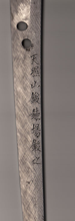

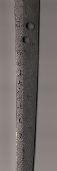

Dr Fox Posted May 26, 2012 Report Posted May 26, 2012 Hi again everyone, Can you help to confirm or correct my findings please. A good friend of mine bought a 'Mantetsu' sword, set up in full naval Kai-Gunto, with a ray saya, clear lacquered. As pretty as a picture, he has shown it to me, and I asked why he called it a Mantetsu blade, it was because he was told that, and it was made out of railway lines. Well I don't think it is! Here's what I think, the anchor stamp on the nakago is not a Naval acceptance stamp. I have seen this stamp before and always on swords made at the Tenshozan Taren-jo forge in Kamakura Japan. The anchor is the workshops trademark stamp, and they produced dress swords exclusively for the Navy. Now I am right or wrong depending on the Tachi-mei translation, can you help please. Best regards Denis. Quote

cabowen Posted May 26, 2012 Report Posted May 26, 2012 Seeing as how the mei reads "Tenshozan Tanren Jo Kitae kore" I would think it was indeed made at the naval shop in Tenshozan and not a Mantetsu blade.... Quote
Dr Fox Posted May 26, 2012 Author Report Posted May 26, 2012 Brian, Thanks no wonder I tried to ages to upload, Tiff versus Jpeg, I should have known better. Regards And to you Chris, just the answer I was hoping for, definite conformation. Cheers both. Denis. Quote
