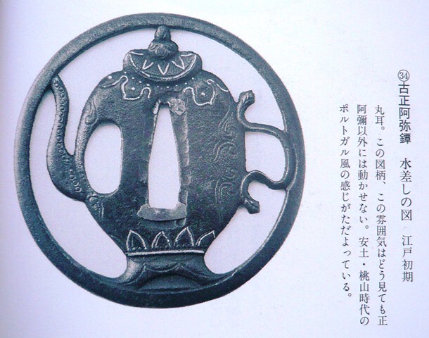

Henry Wilson Posted March 28, 2012 Report Posted March 28, 2012 Hi Mariusz Below is some evidence to support my claim that Peter's tsuba could be from Momoyama period. Actually, I might be incorrect by saying that the teapot is Chinese influenced. These are photos of a screen painting from this book. http://www.joanseeuw.com/blog/2010/6/2/ ... es-er.html It is listed in the catalog as: The Arrival of the Namban "Southern Barbarians" pair of six fold screen colours and ink on gilt paper Momoyama - Edo period 17th century Private collection Important cultural property They depict foreigners arriving with items from their native land and meeting Japanese. Next is a tsuba, from "Tsuba no bi" listed as Ko Shoami, dated to Early Edo. The commentary says it is influenced by Portuguese taste from the Momoyama period. What such a shaped teapot was used for is another matter, but I feel confident assuming that such things have been in Japan since the end of the 1500s. Quote
kusunokimasahige Posted March 28, 2012 Report Posted March 28, 2012 Completely agree with Henry. The teapot looks distinctly European, whatever influence from China it might have. It was important enough for the artist who painted the scrolls to include. KM Quote

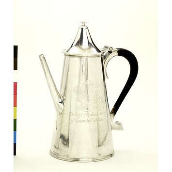

John A Stuart Posted March 28, 2012 Report Posted March 28, 2012 I don't see this tsuba as possibly being Momoyama if it is a European pot. The earliest silver chocolate pots (chocolatiere) were made by French silversmiths in the late 17th century. [from; Chocalate: History, Culture and Heritage, by Louis E. Gravetti and Howard-Yana Shapiro] http://www.coffee-beans-arabica.com/inf ... arts_5.htm For the coffee pot, earliest dated silver pot. 1681 Object Type The coffe pot was one of a series of new vessels developeded by European silversmiths for the imported drinks of tea, coffee and chocolate. A tapered cylindrical form of pot was originally used for both coffee and chocolate, but the earliest known silver teapot, dated to 1670, is also of this shape (museum no. M.399-1921). By the 18th century the spout was often placed at right angles to the handle on coffee and chocolate pots. Historical Associations The engraving on the coffee pot reveals that this was a gift to the East India Company. Founded in 1600, the English East India Company was incorporated by royal charter to develop trade with India and East Asia. The Museum's silver teapot of the same form was also presented to the East India Company, in 1670. Quote

John A Stuart Posted March 29, 2012 Report Posted March 29, 2012 I shall add the given. I don't see this tsuba as possibly being Momoyama [period] if it is a [depiction of a] European [tea]pot. The reference to the East India Co. was not the point. It is that coffee, chocolate and tea pots did not have this shape in that period to be European. It must be an Indian or Chinese pot brought as a trade good perhaps from Goa shown in the scroll. If it really matters, the logical conclusion, that is. No, Henry, not a pissing contest, but, being sure of the likeliest theory. John Quote
Marius Posted March 29, 2012 Report Posted March 29, 2012 Hi Mariusz Below is some evidence to support my claim that Peter's tsuba could be from Momoyama period. Next is a tsuba, from "Tsuba no bi" listed as Ko Shoami, dated to Early Edo. The commentary says it is influenced by Portuguese taste from the Momoyama period. What such a shaped teapot was used for is another matter, but I feel confident assuming that such things have been in Japan since the end of the 1500s. Henry, excellent examples, thank you :-) I rest my case. It could be well Momoyama/early Edo. Quote
