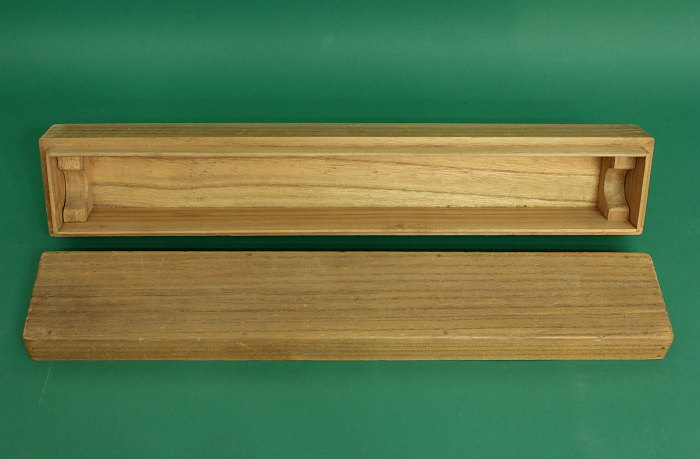

Marius Posted May 16, 2012 Author Report Posted May 16, 2012 Gents, do you think one could store urushi koshirae in a paulownia box? Quote

Marius Posted May 21, 2012 Author Report Posted May 21, 2012 Sorry Gents, I miss a conclusion regarding storage of urushi coated items in paulownia boxes... Forgive me if I am too insistent, but I have a beautiful tanto koshirae and a paulownia box (scroll box) and the two fit ideally. Quote
