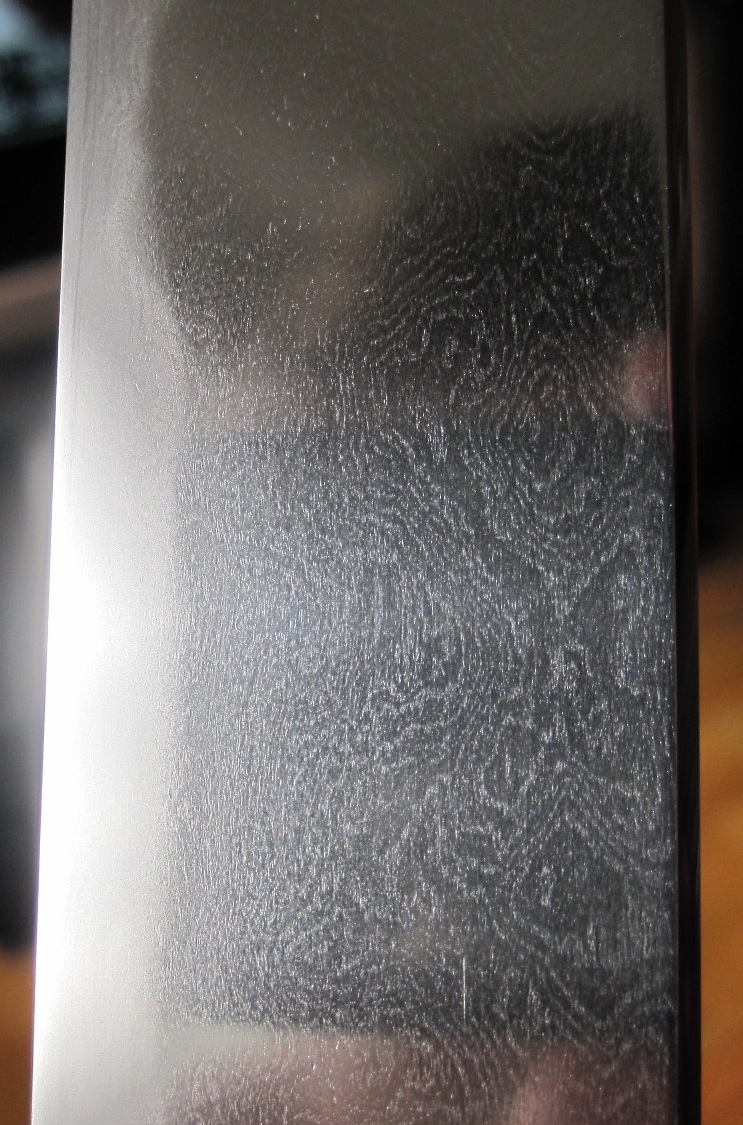

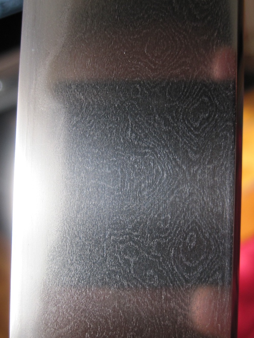

Viper6924 Posted August 24, 2011 Report Posted August 24, 2011 Hi! This surface grain comes from a shin-shinto tanto. How would You described it? As always, all answers are highly appreciated! Jan Quote
sanjuro Posted August 24, 2011 Report Posted August 24, 2011 Jan. Just for the hell of it, first of all how would you describe it? Quote
Viper6924 Posted August 24, 2011 Author Report Posted August 24, 2011 :D Ok, you asked for it: Perhaps Mokume mixed with Itame. The reason I ask is because I not seen this "wild mix" in any of my other swords. And then I saw a jihada called Yakumo-hada, which I think also could be a correct answer. The sword is a shin-shinto. But perhaps I´m barking up the wrong tree. Now let me have it... /Jan Quote
paulb Posted August 24, 2011 Report Posted August 24, 2011 Jan, describing hada is not an exact science. Even between the texts we use as startnig points they often define hada differently. Your itame/mokume view is, I think, perfectly acceptable and a reasonable one. I have never come across "Yakumo-hada," so perhaps someone who has can enlighted us both as to what it means. Quote
cabowen Posted August 24, 2011 Report Posted August 24, 2011 Looks like o-itame to me....... yakumo hada is the name given to the rather unique forging used by shinshinto smith Mito Nariaki (Rekko), who was the 9th head of the Mito clan. He didn't sign his work with a mei but with a chrysanthemum and clock. Quote
paulb Posted August 24, 2011 Report Posted August 24, 2011 thanks Chris, I had not come across it before. How would you describe it? Quote
cabowen Posted August 24, 2011 Report Posted August 24, 2011 said to be "wavy, large grain that is visible, composed of dark, shiny steel" Quote
Jacques Posted August 24, 2011 Report Posted August 24, 2011 I would say it has a look of matsukawa hada. Quote
Jacques Posted August 24, 2011 Report Posted August 24, 2011 Hi, Paulb, I speak about the hada shown above, not about Yakumo hada. Quote
Louie Skebo Posted August 24, 2011 Report Posted August 24, 2011 I'm with Jacques, looks like the bark of the pine tree. Louis Quote

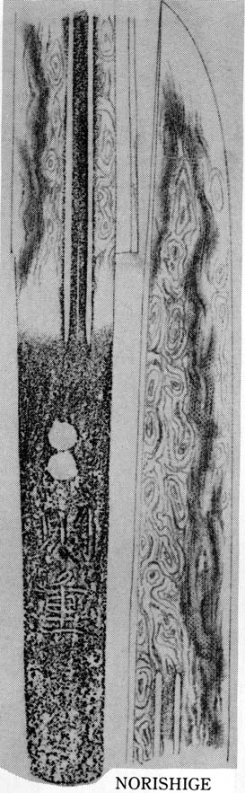

runagmc Posted August 24, 2011 Report Posted August 24, 2011 Here's a good example of matsukawa hada to compare with. http://www.nihonto.ca/norishige-2/ The sword in question looks to have a similar pattern but I'm not sure it has that very bold look of matsukawa hada that they say comes from the mixture of two different steels. That being said this sword has pretty bold hada for shinshinto. I would probably call this itame/mokume w/ masame in yakiba. Now if I can just find some ayasugi in there... :lol: Quote
cabowen Posted August 24, 2011 Report Posted August 24, 2011 Quite different from matsukawa hada as seen in blades by Norishige....This is more an o-itame with mokume that has been packed at the edge. Irregardless it is a very well made blade.... Matsukawa hada stands out more- it is more burly with flowing light and dark steels. See below... Quote

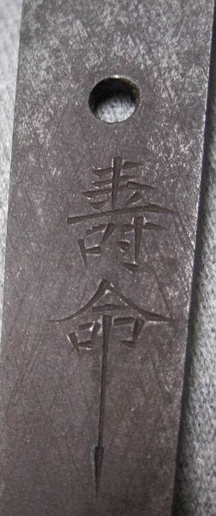

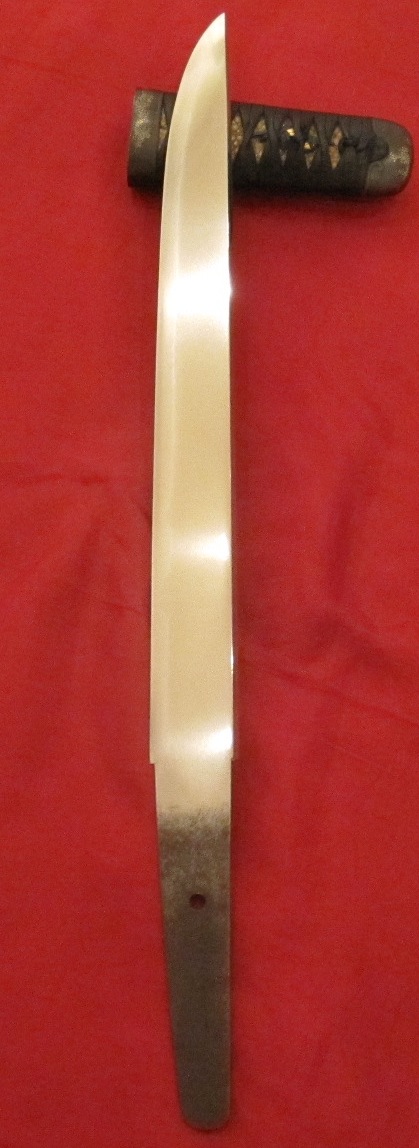

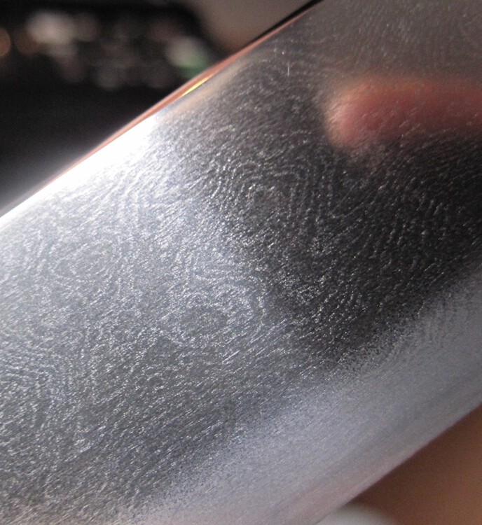

Viper6924 Posted August 25, 2011 Author Report Posted August 25, 2011 First I must thank You all for an highly intresting conversation I´m soaking everything up like water. Second I feel this is another shinsa-projekt. I include some more pictures (it´s hard to take good pictures of the hada). One picture of the overall shape and one of the "long life" mei. Any idee´of the maker? P.S I really like the picture 0725. Looks like a an almost perfect set of evil looking eyes Thanks again! Jan Quote
paulb Posted August 25, 2011 Report Posted August 25, 2011 Jan, I think you can see from the coments above that my original point regarding describing hada not being an exact science is confirmed. When looking at the finer points of the structure there is as with many other characterisitcs an element of subjectivity. Whatever your hada is it looks to be awell made blade and worth some effort to try and pin it down. Good luck Paul Quote
David Flynn Posted August 25, 2011 Report Posted August 25, 2011 Jumyo (long life) is the smith. Looks like shinshinto/ shinto . Long list of Jumyo, began in Koto, right through to WW2. Quote
Jacques Posted August 25, 2011 Report Posted August 25, 2011 Hi, It is signed JUMYO 壽命 Quite different from matsukawa hada as seen in blades by Norishige Of course yes, i just said it had a look, an air, a little resemblance with matsukawa hada. Quote

Viper6924 Posted August 25, 2011 Author Report Posted August 25, 2011 Thanks Jacques and David. I thought "JUMYO" only was a mei the smith wrote on blades that were being given away as gifts to persons or temples. So this is acctually the name. Mmm, intresting. Thanks again, guys! Jan Quote
cabowen Posted August 25, 2011 Report Posted August 25, 2011 Thanks Jacques and David. I thought "JUMYO" only was a mei the smith wrote on blades that were being given away as gifts to persons or temples. So this is acctually the name. Mmm, intresting. Thanks again, guys! Jan It is an actual mei with no connection to gifts.....As has been said, there is a long line of smiths using this mei in Mino which continued right up into the early 20th century.... Quote

Brian Posted August 25, 2011 Report Posted August 25, 2011 Jan,I think you can see from the coments above that my original point regarding describing hada not being an exact science is confirmed. When looking at the finer points of the structure there is as with many other characterisitcs an element of subjectivity. Whatever your hada is it looks to be awell made blade and worth some effort to try and pin it down. Good luck Paul Yep..I think Paul has the crux of the matter. There are no hard and fast rules, and swords seldom look like those picture perfect illustrations in the books. One man's itame is another man's mokume/itame mix etc. It is sometimes more of a gut feel than an exact science.I definitely see some mokume, but there is really no such thing as pure mokume..so I would go with o-itame/mokume. But the matsukawa hint is there. It isn't..but has some of that feel to it too. Brina Quote

Ted Tenold Posted August 26, 2011 Report Posted August 26, 2011 Interesting blade indeed. Jumyo works do seem to run a wide gammut, but on average tend to look stereotypical Mino. I had one paper a couple years ago that was an early Jumyo (Muromachi period) and at first glance looked very yamashiro and even had elements of Ayasugi with utsuri. Very unusual and kind of majiwari, but in line with works from that period when I further researched it. As far as the definitions and terminologies of hada, many special terms are generally associated with groups or smiths that most used them. Additionally, there's elements such uniformity, jinie, chikei, etc., that support their appearance in ways that are fairly specific. Ayasugi = Gassan and Naminohira Matsukawa = Norishige (Etchu province) Chirimen = Aoi Groups (Bitchu province) Konuka = Hizen Tadayoshi Uzumaki = Naotane Nenren = Sa school As for the subject sword, I would not call it Matsukawa, but mokume with itame. The oshigata provided illustrates what classic matsukawa hada should resemble. Just my two cents. Quote
