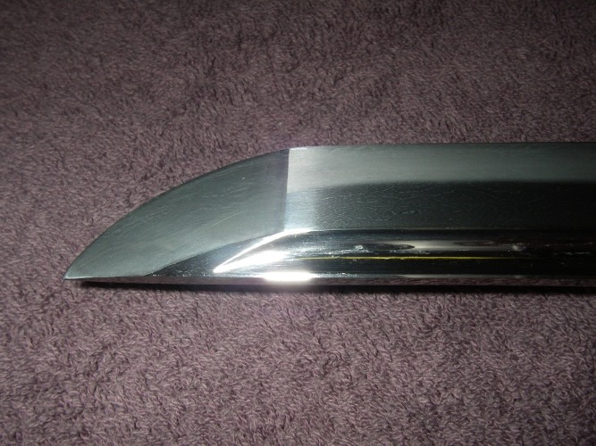

If I can give an example: One of my favourite swords is wakazashi made out of the top end of a kamakura period Enju blade. In pure commercial terms it runs close to the least desireable of configurations in that it is O-suriage, mumei and a wakazashi. In its favour it has been beautifully polished and is in healthy condition.
The real plus to it is that it is absolutely beautiful (total subjectivity on my part) The quality of the jigane is breath taking and the suguha hamon subtle but intricate. The hada compares favourably to examples of Rai and Awataguchi pieces I have seen, in fact were it not papered to Enju and with an O-maru boshi I thik it would pass as a Kunitoshi piece.
I bought this sword about 3 years ago from Japan. It was not hugely expensive and I think were I to attempt to sell it I would struggle but it is probably amongst the 3 or 4 best examples of forging I have ever seen (Yes I know I havent spent a lot of time in Japan looking at top quality blades but I have spent time looking at top rated swords at International auction houses in London). So it is staying with me. It moves me in a way that I would fail to explain but it is something I put geat personal value on.

Geez Paul, it seems to me you are following the idea of always buying the best you can afford and improving your collection. Just because a piece isn't expensive or "important" doesn't meen it isn't good. That wak looks great. It's kamakura and in great condition and as you said "beautifully polished and is in healthy condition" and "probably amongst the 3 or 4 best examples of forging I have ever seen". I have always been of the opinion that you buy what you like and appeals to you. If you do, you are going to keep it. If you buy it just because it is important or expensive or the best piece you can afford, you may keep it but you won't necessarily be happy with it.
Paul.
It would seem to me that you have upheld the requirements you have stated concerning quality in this piece. The price is of no moment, and desirablity by other collectors is a fickle and transitory thing. You arent selling it so value, monetary or otherwise, lies in the eye of its owner.
A Kamakura blade is still very desirable among those collectors who prefer koto pieces, and Kamakura Period blades are not common. The Osuriage is acceptable in so old a blade and whilst to some it is regrettable, this blade has lost none of its quality. It would seem to be well worth your esteem. A very elegant blade.

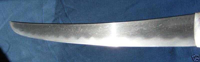

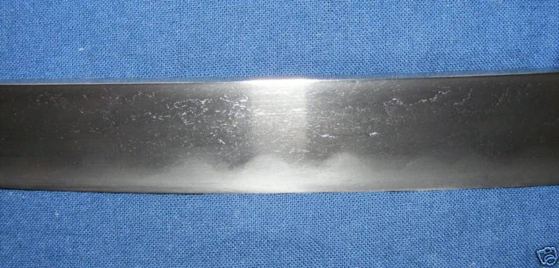

I picked up this little wakizashi in shirasaya and the inscription is bitchu matsuyama (toshimasa.)
It is only 14.5" nagasa. 1' wide but the shape is really appealing unobi zukuri and the hamon bright and clear. The blade was given to A ... Kunihiro and it is so small compared to some of my katana that it just sort of makes you want to hold it.
Kind of thing I would like to keep hidden "in case needed? - :badgrin:
Hi Brian,
That is an interesting looking piece. Incredibly deep nioi guchi and its interesting the way the hamon simplifies into almost suguha as it approaches the kissaki. Is that a normal characterisitc for this smiths work? I am not at all familiar with him.
good looking thing which will keep you occupied for hours just looking at the hamon.

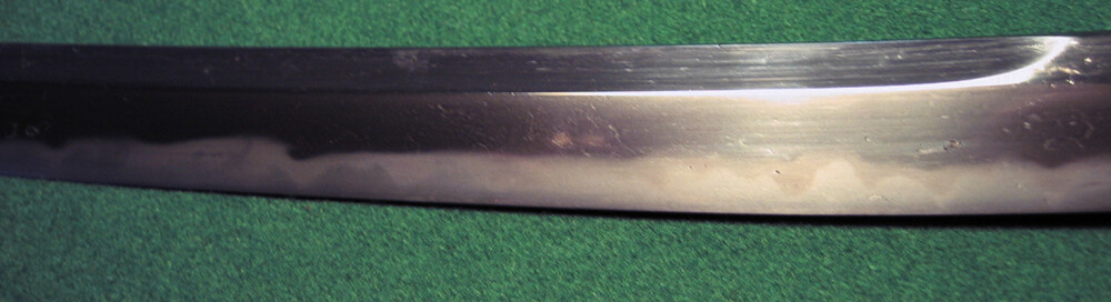

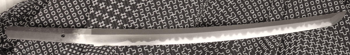

Well, here's my favourite low-cost blade with very little value to other collectors: a shinto, O-suriage wakizashi :oops: : yet I love that poor little blade: it was once forged by a skilled smith, who produced konuka hada and bright suguha hamon in nie. Quite flawless apart from being suriage. Not difficult to see which Shinto school it seems to belong...

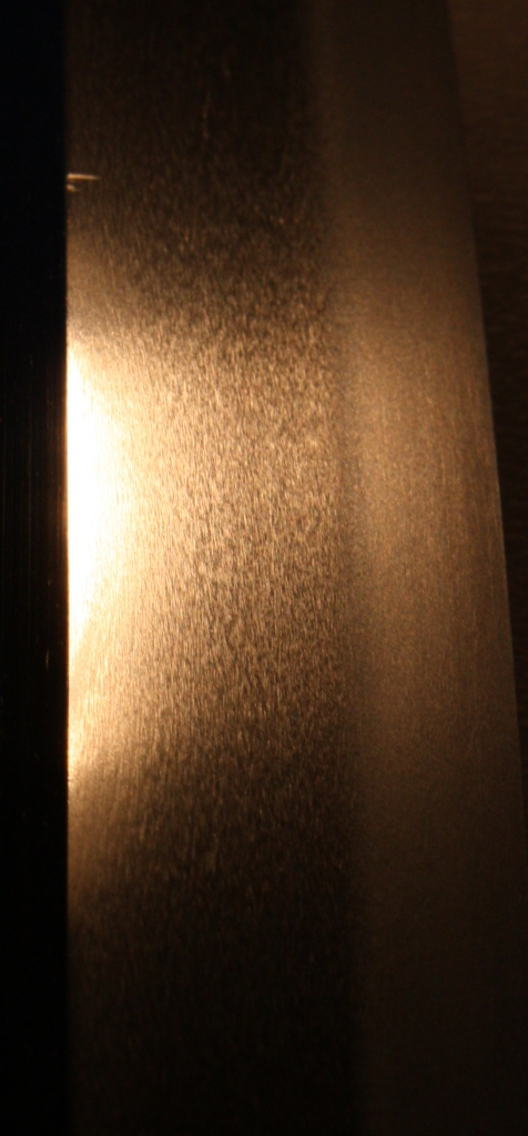

Paul, how does the hada of your yondai Tadayoshi compare to the pictures I posted? My blade has very, very tight, but also a bit featureless as well as very uniform hada. It is not too different from the hada of the nice yondai Tadayoshi katana on the Nihontocraft web pages.
BR, Veli
Hi Veli,
Mine is not so tight, there are areas of fine running itame combining with ko-itame. It is not what I would describe as the pure konuka hada which really starts to be a consistent Hizen trait from the second generation and in to the later members of the school. When this blade was repolished the characteristics became a lot clearer. The hada, the amount of nie and the brushed appearance of the boshi all suggest an earlier work, possibly the shodai, but equally it could be something else altogether such as Enju or ko-mihara.

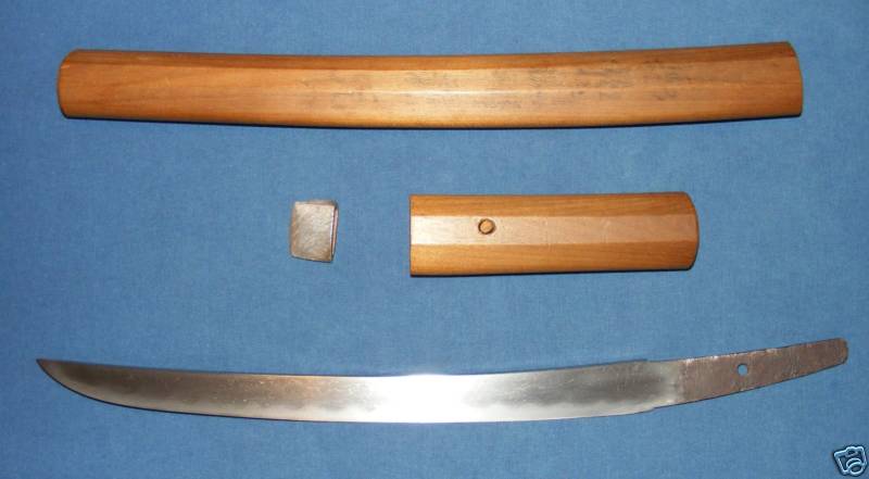

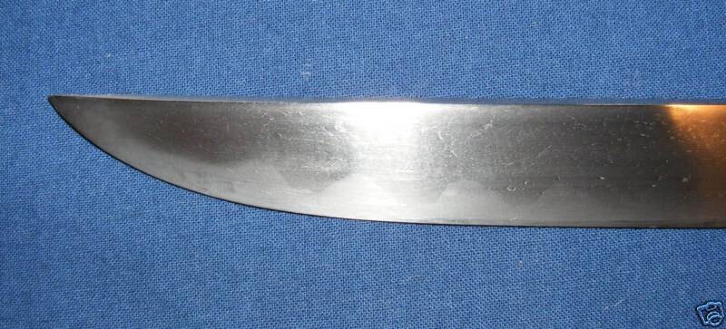

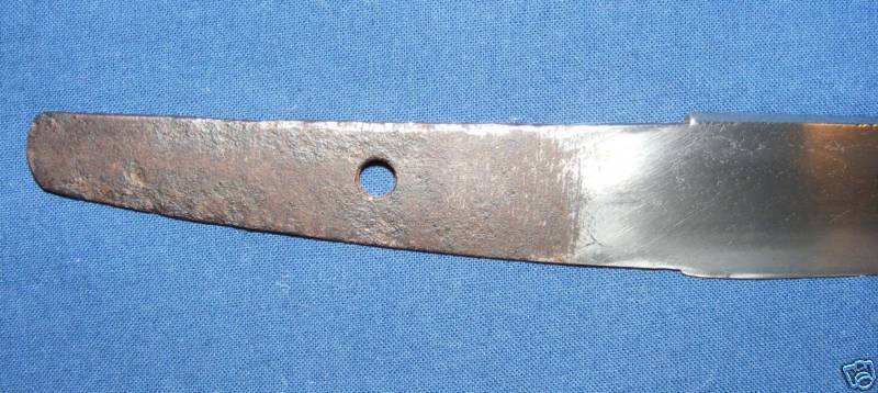

Since we are dealing with dark secrets then here is mine. Not perhaps the quality thus far displayed but none the less a blade I would not part with.
I purchased this blade in 2002. I have not researched it and I know little about it. ( a terrible thing to admit). It simply spoke to me and I paid what was asked. The steel is dark and the hada is active. In truth I have never made an estimation of this blade's origins with which I feel entirely comfortable. There is a faded sayagaki, the characters of which are indistinct. The first says bishu the last is mitsu. It is I think a collectors sayagaki rather than an attributive one done by an expert.
All I know is contained in the description that came with it.

Hi Chris
I think you are correct. I cant see this blade as early as a 15th century piece. I have at times thought it was a Sagami blade and no earlier than late 1500. The truth is, I cant actually place it accurately at all. I still love to look at it though. There is just something about it... perhaps the mystery itself. The steel is quite dark and has a koto-ish look about it, although the hamon says perhaps later than koto. Speculation only....... :)
My problem really starts with this period (actually I think I have problems with most truth be told) But when we get in to Sue-Seki, Soden Bizen, Sue-Tegai etc many of the features which differentiate the Gokaden seem to blur and merge. It is an interesting point whether this is really Soshu influence or more directly Mino as the Mino smiths started exporting their technology around the land.
Keith you refer to darkness in the steel which would immediately throw up northern province work. Again this could be the case where the Mino influence has been picked up in Echizen, Chikuzen etc. If I had to date this I would go 1450-1550 and struggle to bring it tighter.
On a more personal note you mentioned that it spoke to you, can you remember why and what about it triggered your enthusiasm?
Paul.
Oh yes, I can remember and I am reminded each time I look at this blade. Firstly the steel.... A lot of what appeals to me in many swords is the steel. For me it is usually about the steel, the hada and the softer look of the koto type. The way it has been worked and the traces of the forging in the surface of the metal. Secondly, the sugata and the sheer presence of this blade. It is not a small tanto by any means, and yet it has an elegance to it.
To top it all off, it is ubu and mumei and therefore not capable of any deception, nor is it attempting to live up to an expectation of the perception of any smith's typical work.
This blade in fact is the first ubu mumei blade I bought just because it was ubu and mumei, (along with the above characteristics). It is also the blade which first made me aware of my preference for such blades.
I realise of course that perhaps others may not view it in quite the same light. :D
Actually Keith my Koto blades are mumei although all but one are suriage. So I have no problem with that. I am less clear and have never really found a satisfactory answer as to why Ubu blades remain unsigned, especially those which exhibit real quality. There are many theories around but I am guessing it is something that can never be proven.
