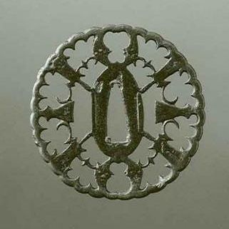

raaay Posted February 13, 2007 Report Posted February 13, 2007 this tsuba again i have owned for a long time ,but i have lost the information that came with it . it was in a well knowing private collection in the UK some years ago and i purchased through a contact from a collector friend of mine. and i must admit this one , is one off my favourite tsuba . i think it is - sakashi ? circa 1700. any opinions please , date , school , etc Bit late i know ! / but tsuda - dia 80mm x 3 to 4mm thick thank's again . ray. Quote
Ford Hallam Posted February 13, 2007 Report Posted February 13, 2007 hmmm, the little birds make me think Ko-Owari. What are the measurements? Quite elegant too. Ford Quote
Rich T Posted February 13, 2007 Report Posted February 13, 2007 Owari, but I would not think Ko, Edo more likely. Also, the geese in the older Owari ( Muromachi and the likes ) were generally bigger and rounder, though I know not always. Another point here is that older Owari are quite heavy in design, large, bold, bigger than life where this is pretty fine. This could also be Kyo because of that. Is there anything in the mimi ?, tekkotsu or masame hada ? I think probably mid Edo by the looks of the iron ( late 1600's to early 1700's ) And yes, it is definitely sukashi :-) Rich Quote
Ford Hallam Posted February 13, 2007 Report Posted February 13, 2007 Hi Rich, you're probably right on the age, now that I think about it. I also wondered if it might be Kyo-sukashi first, but the birds swung it for me, then I simply went to Early Owari because it was more delicate . regards, Ford Quote
Curran Posted February 14, 2007 Report Posted February 14, 2007 Kyo-sukashi. 1725 to 1800 is my call. Rich is da king. Not much to add. If the plate is (probably) thinner, I'd probably put it later (1750 to 1800). Ps. Your Umetada plate patina is entirely consistent with that of other Umetada tsuba I have seen from that period. A few years ago I owned a similar style Umetada by Yoshitsugu. Distinct patina. Gray black, and somewhat slick as if it had somehow been burnished. Curran Quote

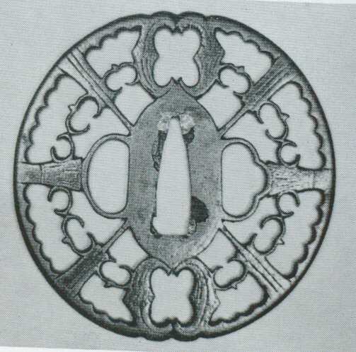

Ford Hallam Posted February 14, 2007 Report Posted February 14, 2007 I just came across this Kyo-sukashi tsuba, in a book by Kazuo Iida, which appears to share some similarities with the one we're discussing. Although I must admit that the slightly more squarish seppa dai on Ray's piece still makes me think Owari. Quote
Rich T Posted February 14, 2007 Report Posted February 14, 2007 It is a common theme amongst Owari, Kyo, Akasaka and Higo among others. Being Ryohitsu Shitate makes me appreciate the Kyo Sukashi call This is papered NBTHK Ko Akasaka Rich Quote
Ford Hallam Posted February 14, 2007 Report Posted February 14, 2007 Hi Rich, I can see that as Ko-Akasaka, particularly the more pointed seppa-dai. Would'nt have been handy if they could have simply marked them all with their date and place of manufacture . I suppose this could lead one to have a closer look at the development of Akasaka and how much they imported from Kyoto sukashi work. thanks, Ford Quote
