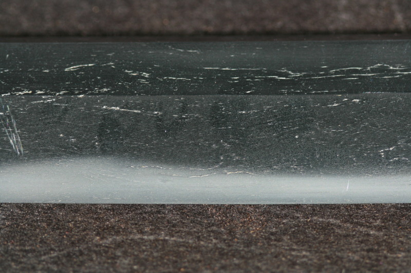

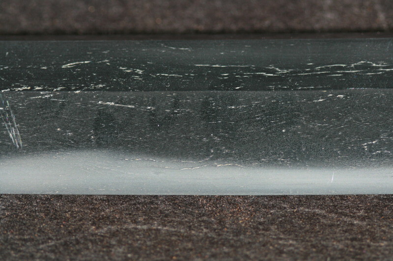

This is just a shot in the dark but what if they "polished" it to remove the real mei? It's common practice by people trying to change mint marks on US coins. There is a very shallow line coming down on the right side from the highest horizontal slash, there's the wide spot in the long vertical stroke and it would go a long way to explaining the extra horizontal stroke at the bottom that Grey talked about. Is there any evidence this has been done before?
HI Steve,
Interesting looking sword.
There were more like dozens of guys that signed Sa. It was a very big school.
Your sword has a nice organic look to it. Some spots of nice looking hada.
I wonder what is going on with these dark areas in the ji. Surly not utsuri.
Is it just dark spots in the steel?
When you get your sword, take some good close shots I would love to see what is going on here.
Rest assured that it is a old sword.
Mark G :)
Could you explain on this, please?
Surly not utsuri.
Telling from the pictures, it looks like perfect utsuri to me. What makes you think so?
reinhard
Surly not utsuri.
reinhard
All the other swords I have ever seen signed Sa, had this same look. Mind you, it has not been that many. By 'organic look'. I'm just using non Nihonto terms that I have formed in my own mind. Very natural looking, with all kinds of stuff going on. Sorry if I confused you reinhard.
From the pics, it sure looks like utsuri to me too. I was joking, geeze :? Did anyone else miss the joke?
Mark G :)
*chuckle* I got it Mark. When I read that I wanted to celebrate! I think Organic is a great way to describe the grain of the metal. In many ways it resembles fine grain on wood.
