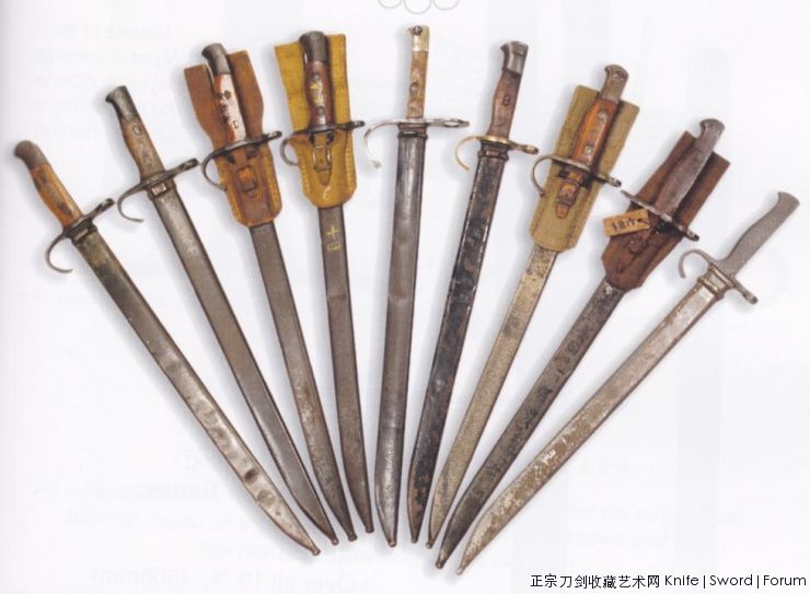

888jojoli Posted June 13, 2010 Report Posted June 13, 2010 for the bayonet That's the Japanese Type 30 Bayonet, and it looks like the 2nd type which has been made by the early or middle of the WWII. Joe Quote
