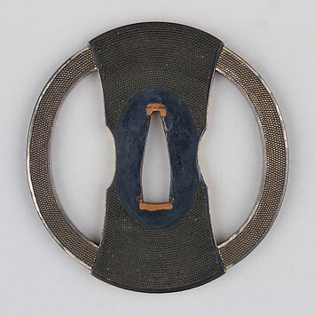

I was also wondering about the design of the tsuba itself. The shape is also unusual.
Posted (edited)
The shape is very similar to a "Fundo" design with the side rings removed - it makes sense to remove them from a small tanto size guard but this is larger and shows no sign any rings have been deleted..

Posted (edited)
2 hours ago, Jesta said:
Thanks Florian. Very interesting, and your suggestion makes a lot of sense.
Some Efu Tachi Koshirae use similar Tsuba.
Edited by Teimei
Depending on the dimensions, I beleive this TSUBA was intended as, or functioning like a HAMIDASHI one.
The decoration is certainly as Piers states above.
An interesting and unusual TSUBA!
