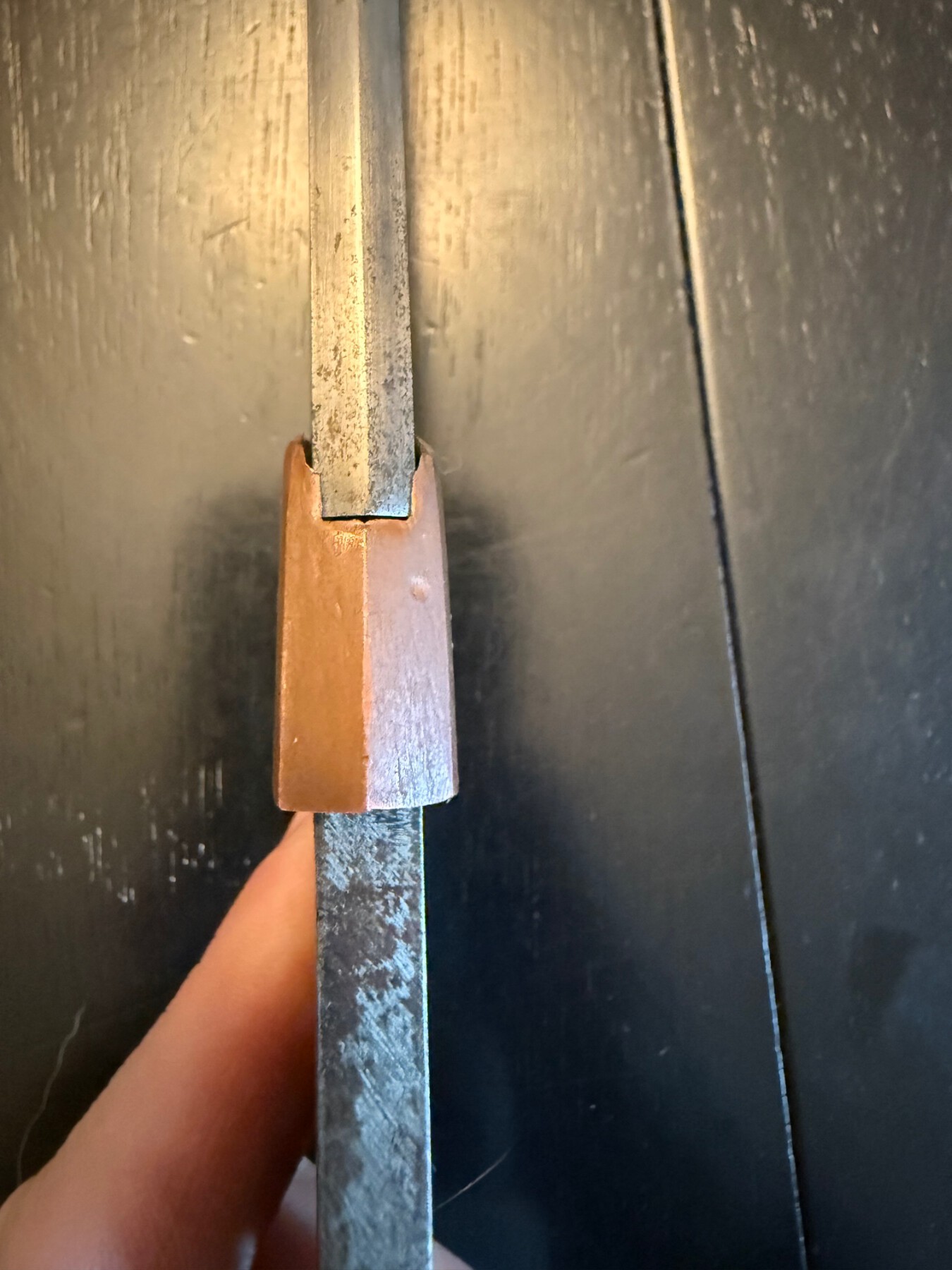

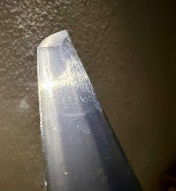

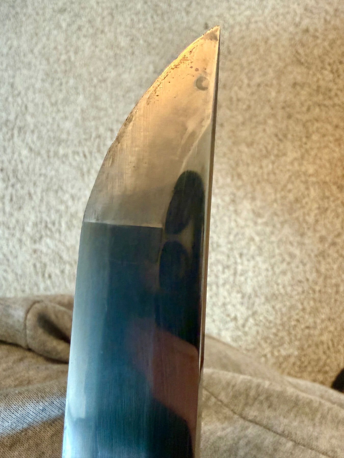

It’s actually in better condition than the eBay photos make it look. Still has a distinct yokote, hamon and boshi visible throughout. Can’t find any big chips, it’s totally straight, and nothing fatal as far as I can tell. That said, it’s far from perfect, and is scratched up and clearly neglected. Missing the tsuka and seppa. Some isopropyl and light oiling removed the fingerprints and made the blade look a little better.

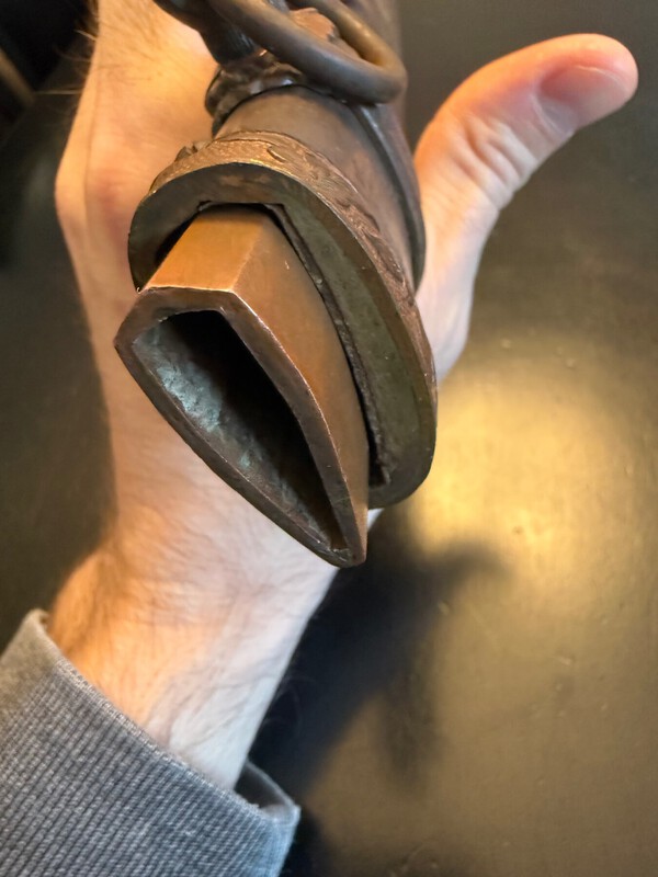

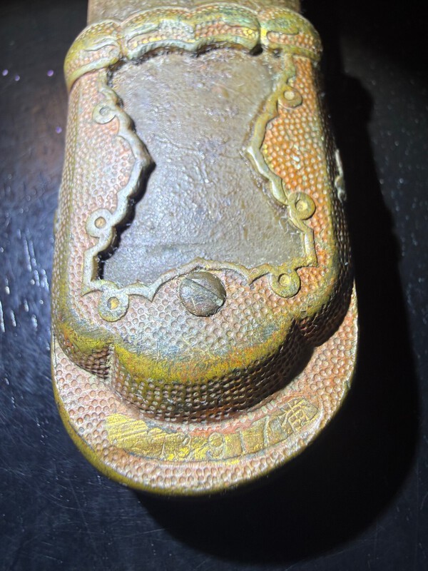

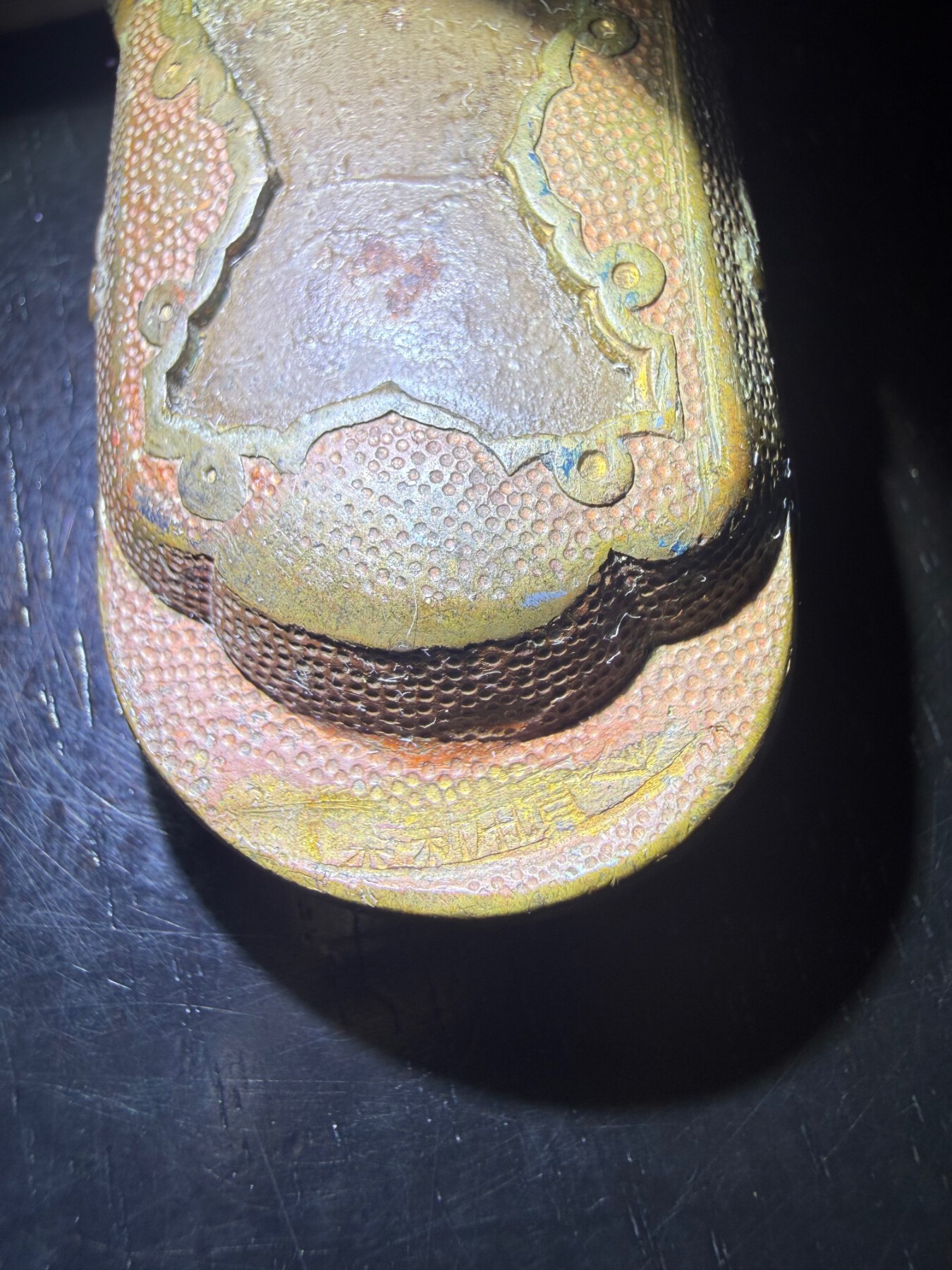

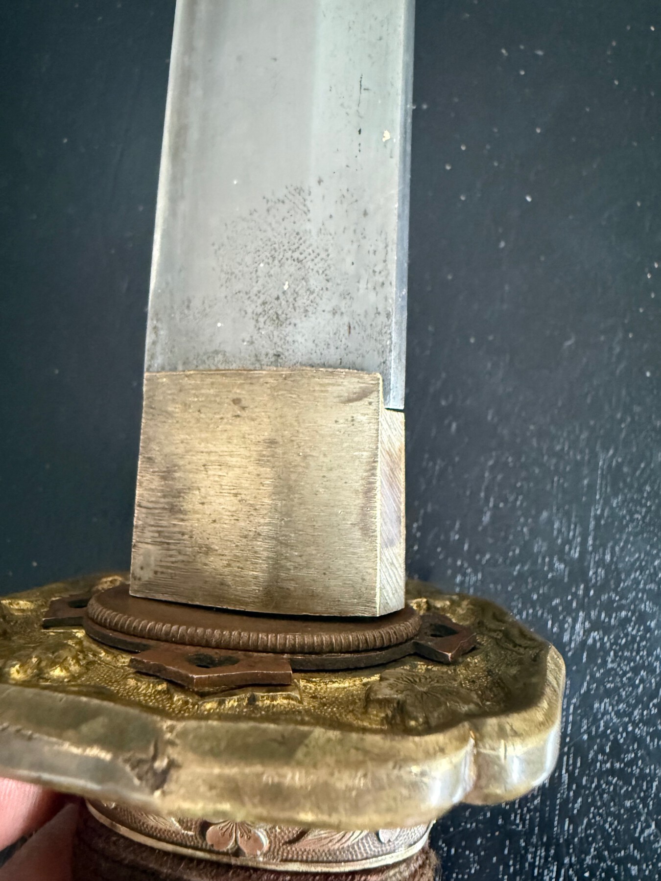

As many of you know, I have an interest in the militaria side of things. I was intrigued by the ishizuke with patent numbers and stamps, which is an unusual but not unheard of feature. That said, it’s clear that this scabbard, or the habaki, and blade are not an original pairing (habaki is chunky copper and does not fit into the opening of the saya).

Apologies on my amateur photography. I’m not the best at it, and the sword is not in a great state of polish. An ugly palm print remains near the machi.
Here’s the ishizuke that caught my attention. And some photos that demonstrates why I believe the habaki and/or saya not an original pairing with the blade:

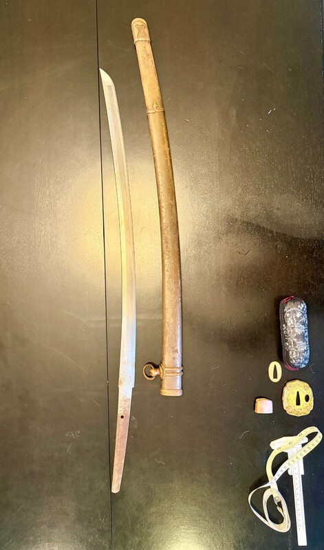

Nagasa: 645mm
Sori: 24mm
Nakago: 210mm
Kissaki: 38mm
motohaba: 33mm
sakihaba: 24mm
motokasane: 7mm
sakikasane: 5mm
Thank you for that Sam. We have certainly all seen much, much worse blades than this one, so again, well done.  On page 30 of Military Swords of Japan 1868-1945, by Fuller & Gregory, it mentions this type of ishizuki, and says that they are quite rare .
I wonder of something like jewellers rouge might possibly take some of the palm print off, while not damaging the surface of the blade. I have also heard that Duraglit works quite well, though have never tried it.
As regards the habaki / saya question, well my money would on the habaki being a replacement, it doesn't seem to fit the blade either.
I agree that it’s likely the habaki that does not fit.

A few too big seppa + a slightly too big tsuka core + an almost just right habaki = something reminiscent of a type 98 :laughing:. The ito is just wrapped around the core for now; no samegawa or menuki.
It all “fits”, with only a little rattle. At least this way I can handle it with a little more familiarity and the habaki sets nicely into the saya.

Guys, tsuba should have marks too. I saw some repro of wakase ishizuki already. Number 4 at ohmura
http://ohmura-study.net/906.html
also seppa and chuso should be numbered but I don’t know if numbers were always obligatory.
I would put my money of saya being legit yet not original with this blade.

Not all gunto fittings were marked or stamped, as far as I know.
But anyway, this only came with the blade, tsuba, habaki, and saya. I added the seppa from a lot of seppa I bought years ago. There is no chuso. I also added the tsuka core from a different lot of parts I once purchased.
It’s my belief that’s this sword was a hodgepodge of mixed up parts when I found it, and it remains that way. The tsuba could be a repro; I’ve seen several late war Tsuba look this way. Ohmura’s website is really awesome, but it’s not entirely comprehensive.
There’s no way any of these parts are originally matching. The saya and blade are genuine, everything else is “put  together”.

I had saved as favourite 2 separate auctions consisting of parts from one wakase set. Same seller, 2 auctions at once with same number.
Sadly catawiki cleared all observed at once :/
That’s why I’m sure that tsuba from omura was offered with matching set of seppa and chuso.
Please have it in mind. When I find another one I will drop it as I always do.

Remember the saying “with World War II Japanese swords, never say never or always.“ I agree that we have seen some sets where the stamps are found on the drag, as well as the tsuba.  But we have also seen plenty where it is just found on the drag. Now I will admit that maybe not all cases show both parts. You would have to run a search and a survey to collect data and find out.
14 hours ago, Bruce Pennington said:
Marcin,
As long as I  remember I will dig out sufficient examples. Wakase as sword shop owned patents so as it wasn't cheap they stamped probbly whatever they could.

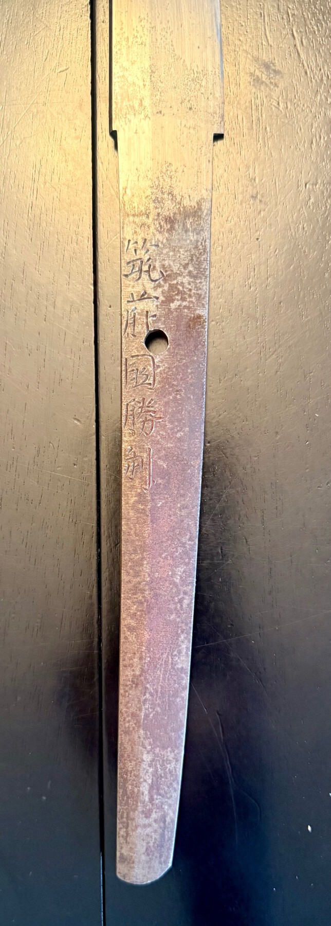

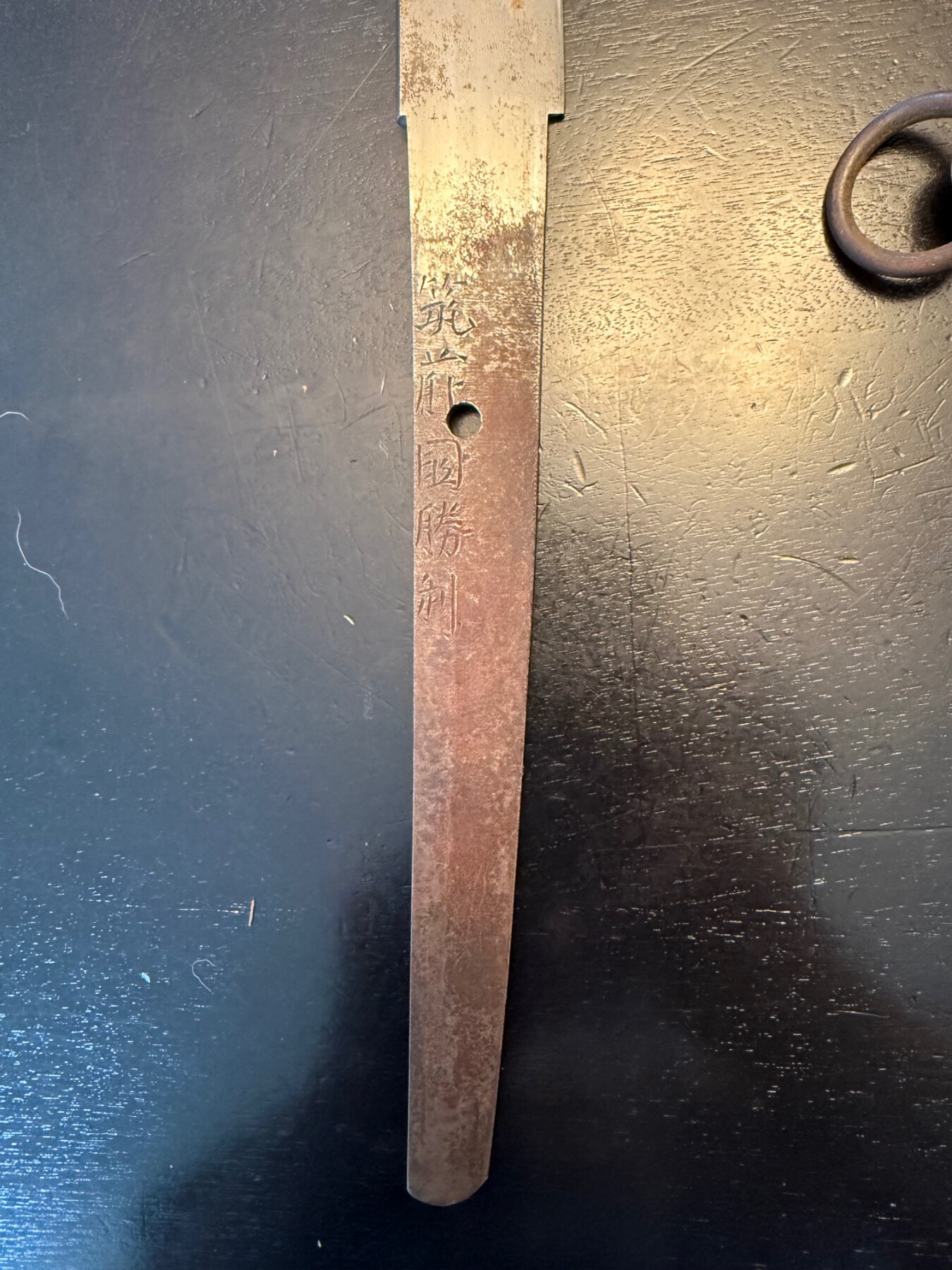

I have struggled to identify this smith. He does not appear in my Sesko swordsmith books, or on any of my Fuller/gregory/slough oshigata publications.
The TOSHI is signed different than the one above, on the nakago, TOSHI is signed like this:
