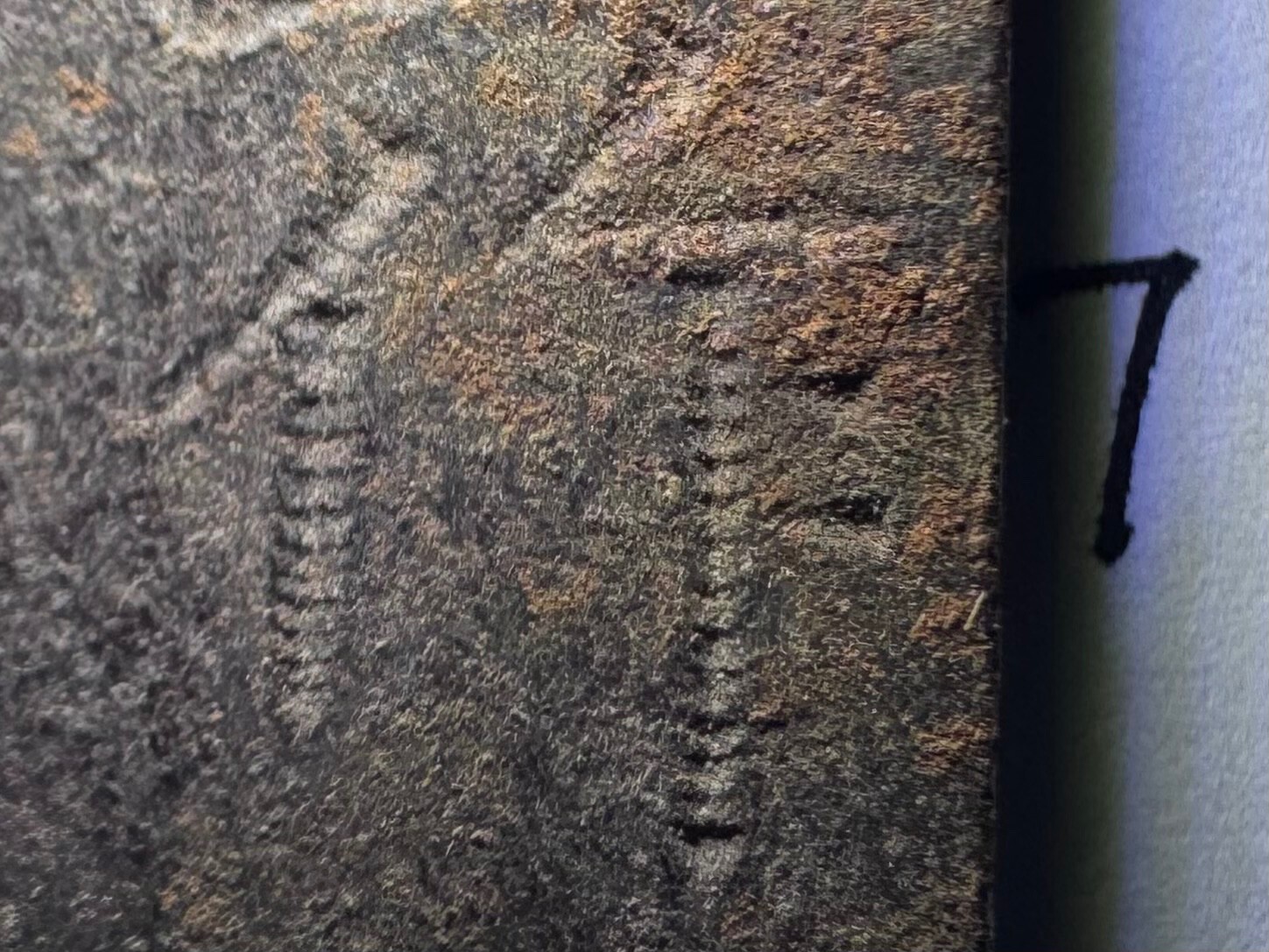

I am new to this forum and know very little about Japanese swords. I am hoping the knowledgeable members here can help me better understand what I may have in my possession.
I recently came into possession of two antique Japanese swords. After doing some preliminary research and getting AI-assisted photo analysis(sketchy at best ) the inscriptions appear to be significant — but I want real expert opinions before I do anything further with these swords. Two of the pictures didn't upload , ill try to get them uploaded in second post
IMPORTANT: I have not cleaned, polished, or altered either sword in any way. Both are in their original unmodified condition

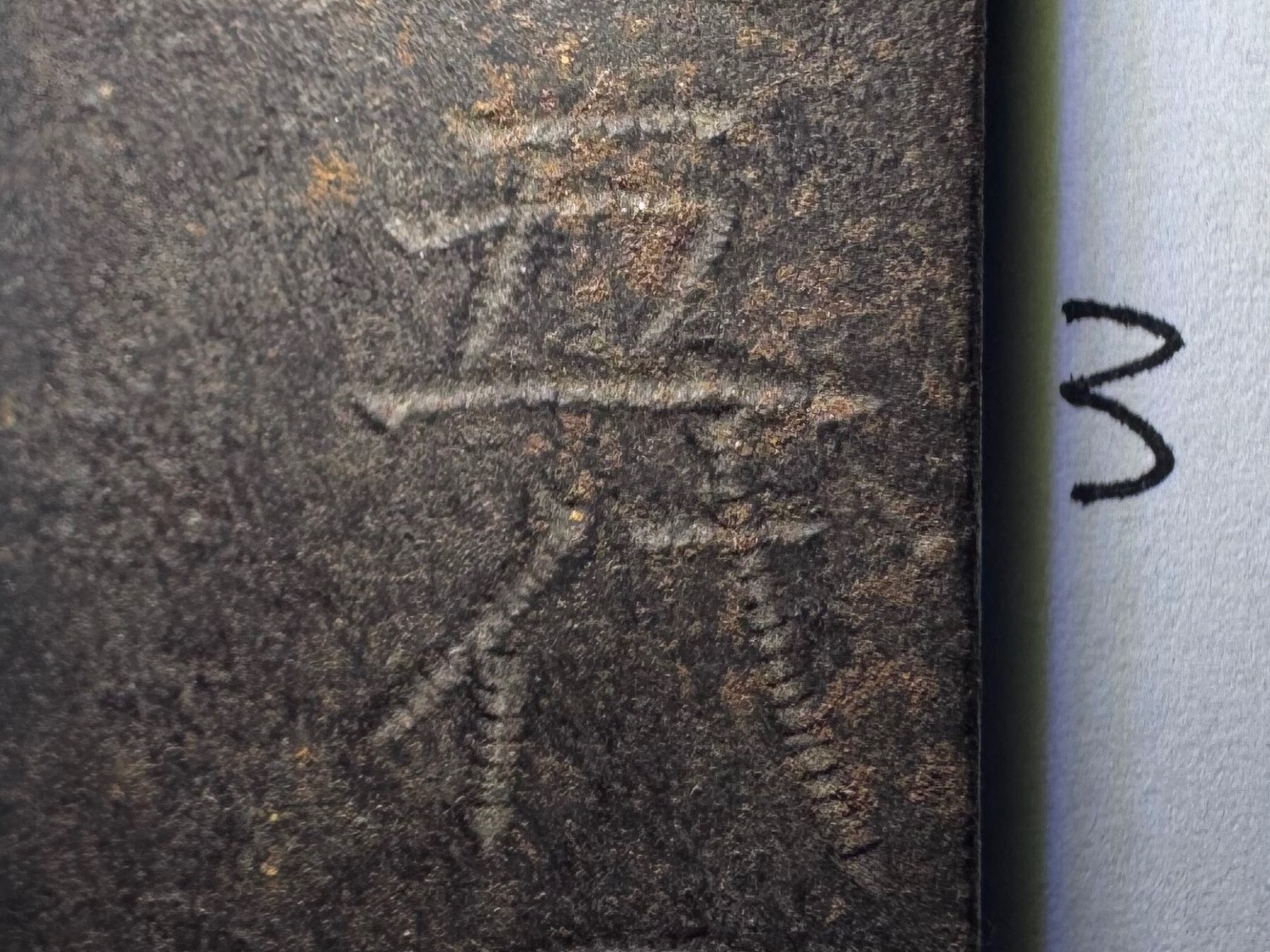

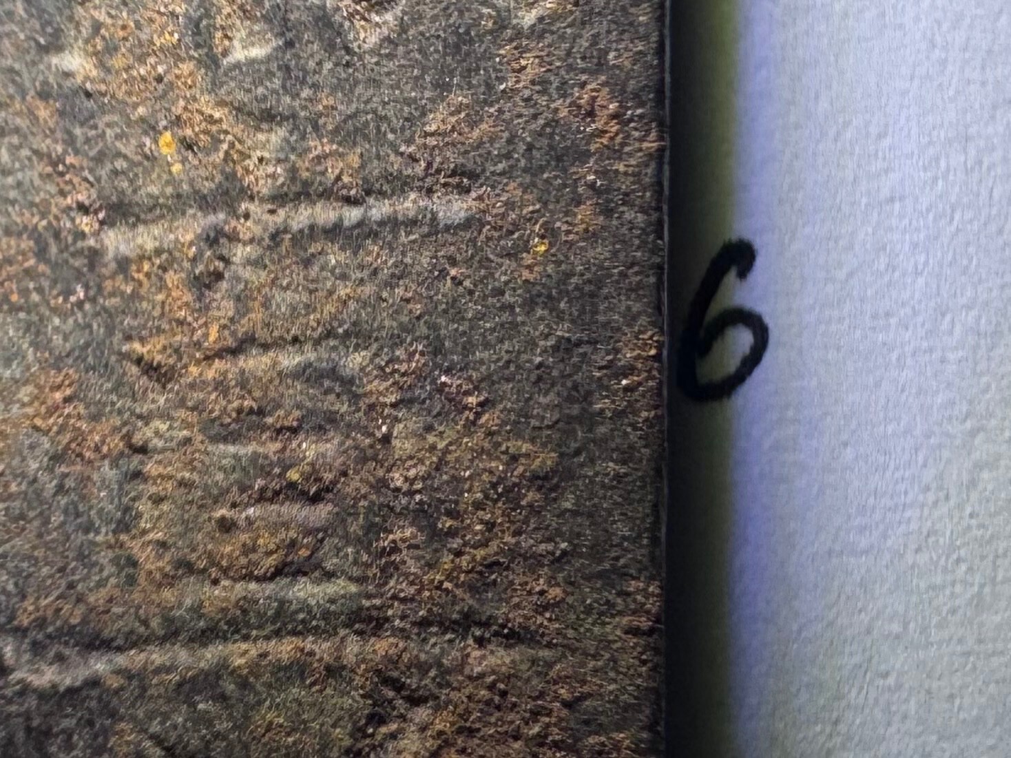

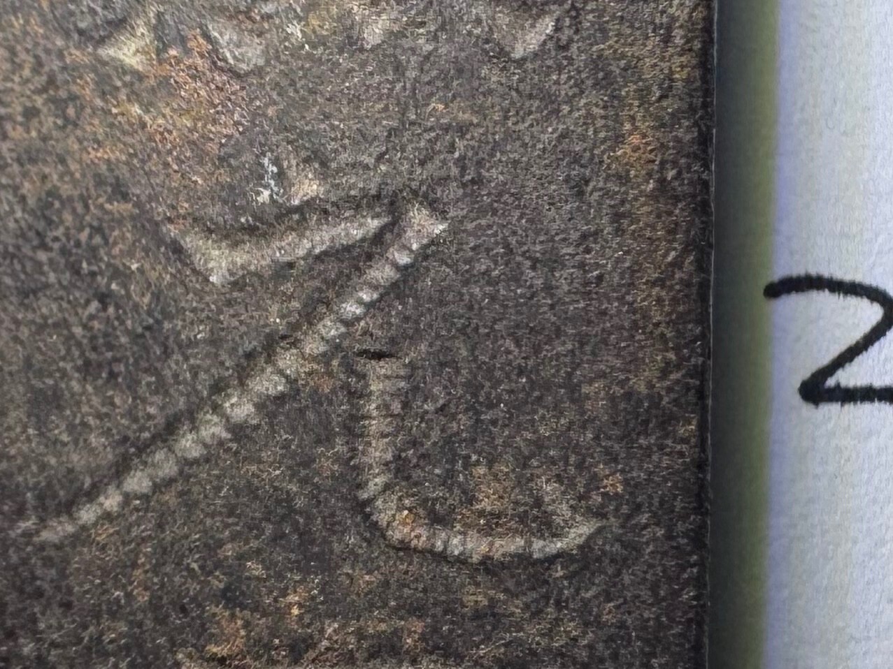

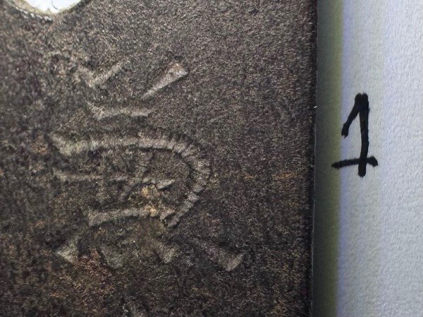

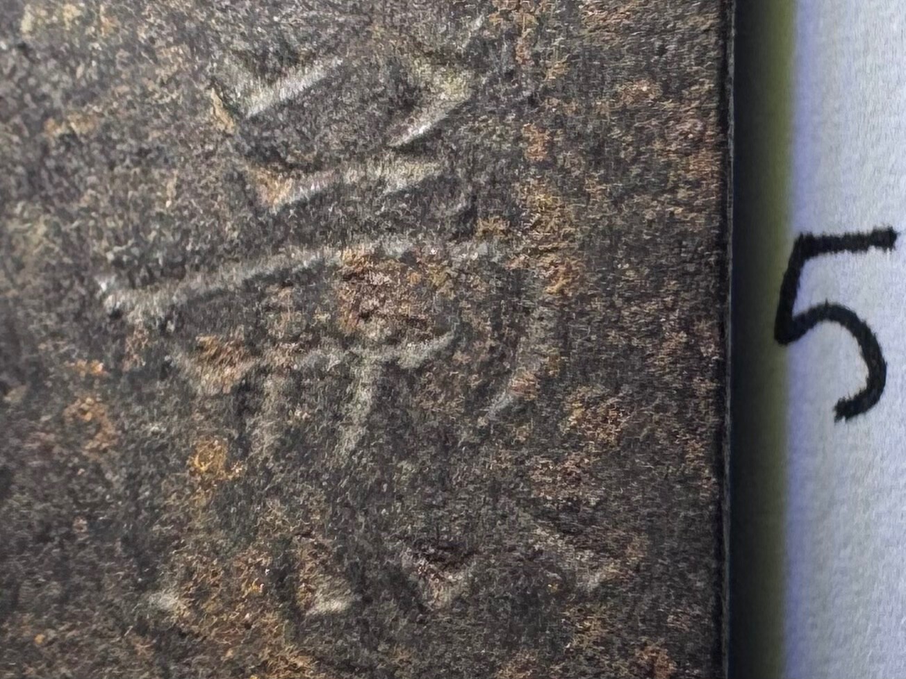

In the same way that you would not give someone a paragraph to read by providing separate images showing one letter at a time, it is much better for individuals trying to provide you with a translation to see the entire and full inscription clearly. From what I can see this may be:
- Kanemoto godai (fifth generation Kanemoto)
- Kanenao saku
However I would much prefer to see the entire inscription of these two swords, with clear vertical images of the entire mei for each.

Hi Ray,
Thank you for your feed back, point taken on the photography process. Im sure ill get better at this as I get to understand how this process  works ,
Please see the vertical image attached. it's incredibly hard to photograph due to the condition of the nakago. thank you for your willing ness to assist a newcomer.
Many thanks
Arno
This is a swordsmith who worked around Kanbun period (1661). He claimed to be a 5th generation descendant in the lineage of Mino Kanemoto.
兼元五代目兼直作 - Kanemoto godai-me Kanenao saku

Thank you Ray,

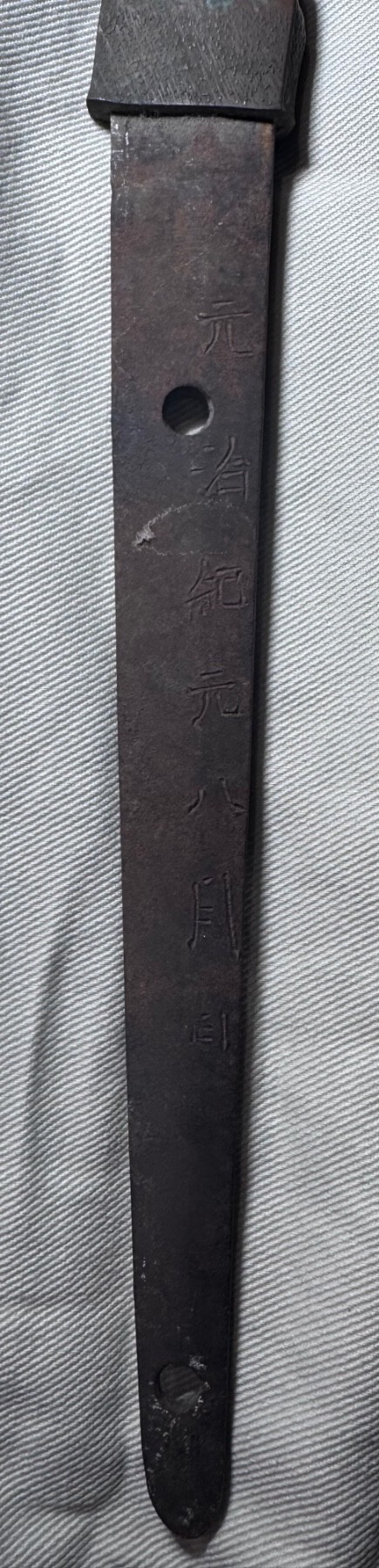

I also posted the two sides of the nakago form the second sword and have detailed pictures of the characters too if that will help .
Arno

As for the second sword,
手柄山勝重精鍛作 – Tegarayama Katsushige forged.
元治紀元八月日 – The first year of Genji (1864), 8th month
I could not find a smith in the era with the name.
