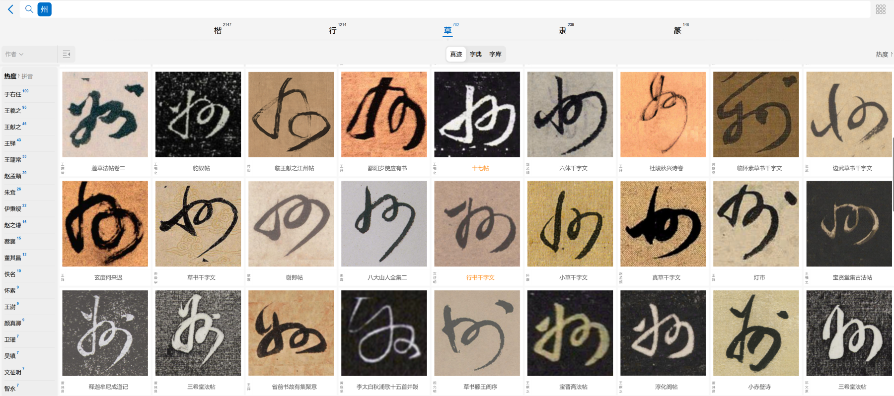

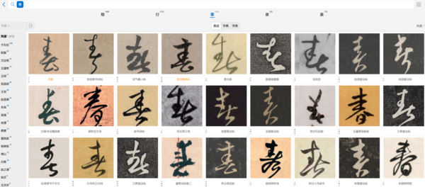

Hi, this sword looks great even just by its Mei! And all the translation looks good, too!
春 and 州 are two of the hardest in here, I think (because 寛政五年 is sort of a given), so here are some of their iteration for anyone interested.

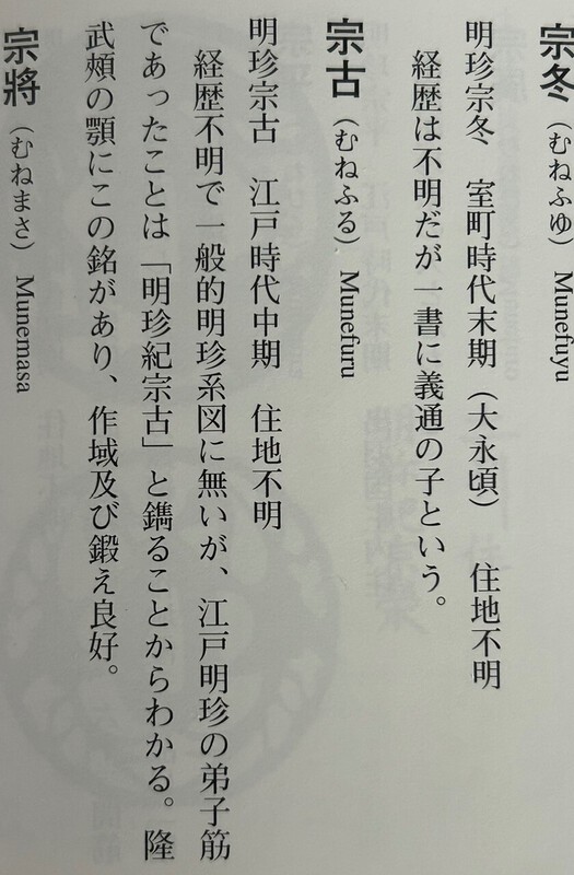

Fantastic cooperative effort, and thanks indeed to Moriyama San, but you should also be aware that some sources pronounce the two rather rare kanji 宗古 as 'Munefuru'.
1. The Kokin Kinko Zenshu lists 宗古 Munefuru (五鉄錬) as an artisan of the Tosa Myochin branch. (It also suggests he used the name 宗定 Munesada.)
2. The Shin Kacchushi Meikan on p.262 gives more detail about Munefuru, commenting inter alia that his work was good and that this name has also been found on (a) ryubu-men.
These two do not list the name as Soko, but it would not be 'wrong' to read it that way, and I would not be surprised to find a 'Soko' reading elsewhere.
See photo of entry 2 above for example:
