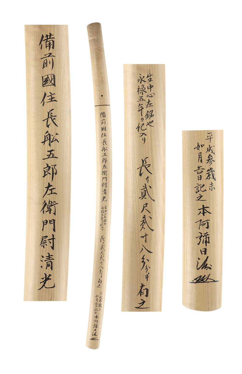

It has NBTHK Tokubetsu Hozon papers. The blade length is noted as 2 shaku 2 sun 8 bu han, approximately 69.2 cm.
There is also an oshigata / sayagaki by Hon’ami Nisshu, dated a lucky day in February 1991, Heisei 3.
The sayagaki describes the smith as:
Bizen Kuni jū Osafune Gorōzaemon no Jō Kiyomitsu.

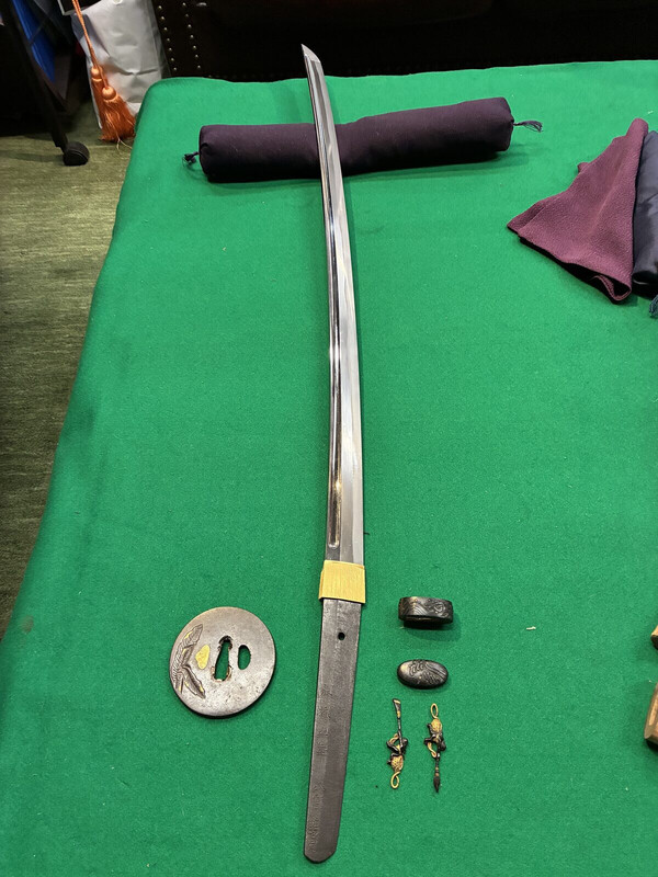

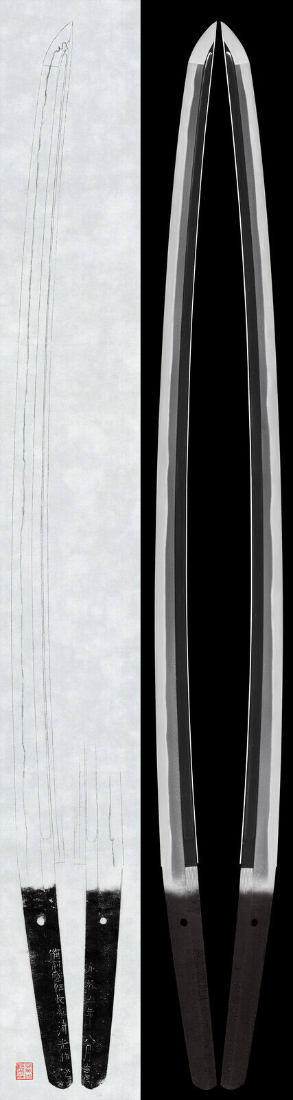

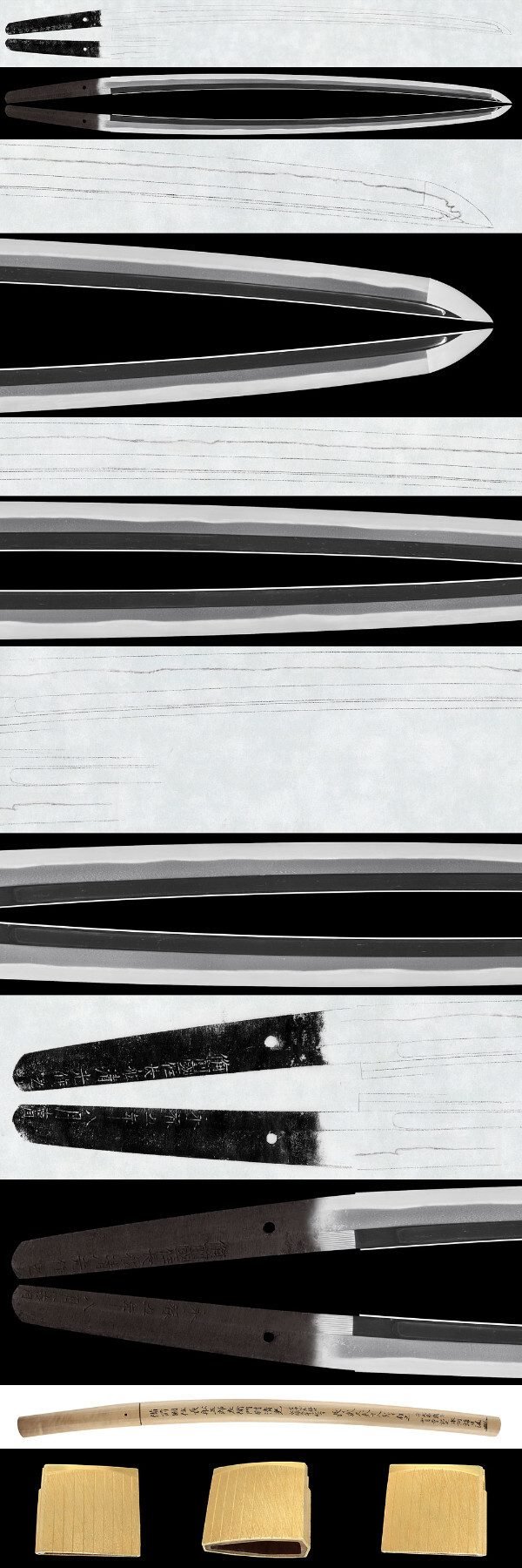

Posted (edited)
measures and description:
Blade Length: 69.2 cm (27.24 in)
Curvature: 1.7 cm (0.67 in)
Mekugi Hole: 1
Width at Base (Motohaba): 3.14 cm (1.24 in)
Width at Tip (Sakihaba): 2.00 cm (0.79 in)
Thickness of Rim (Kasane): 0.74 cm (0.29 in)
Sword Weight: 780 g
Shape:This sword has a robust width, with a bo-hi (groove) carved on both sides.The
kissaki (tip) is slightly extended, presenting a solid and well-balanced appearance.
Jigane (Steel Surface):Well-forged ko-itame hada, showing a faint utsuri (shadow-like
pattern).
Hamon (Temper Pattern):Confirmed by Hon’ami Nisshu.
The jigane is beautiful, and the hamon complements it elegantly.
It begins with a straight temper line (suguha) transitioning into a mild notare, then a gentle
gunome-midare with small ashi included—rich in variety.
Something I really like is the bo-hi not going below/inside the habaki
Edited by RobDam

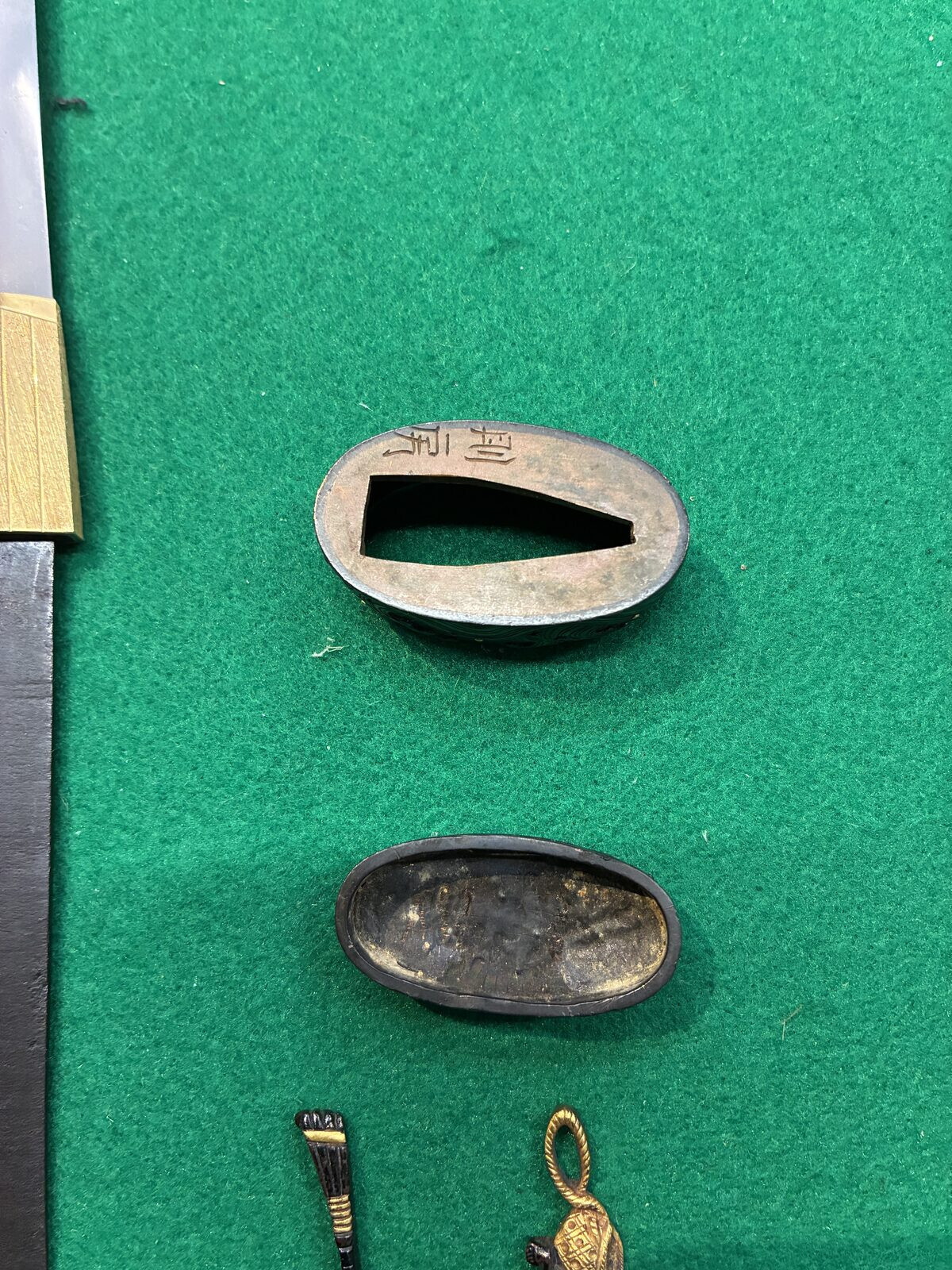

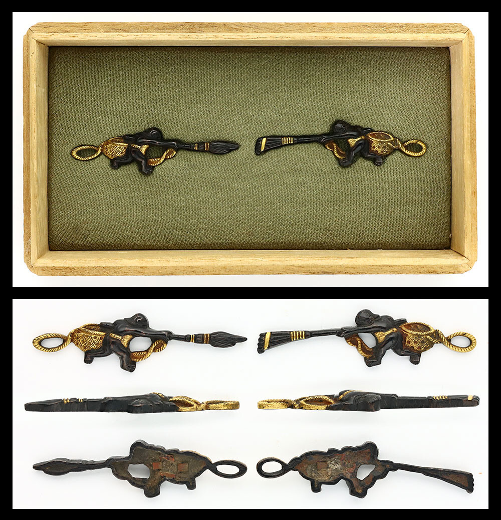

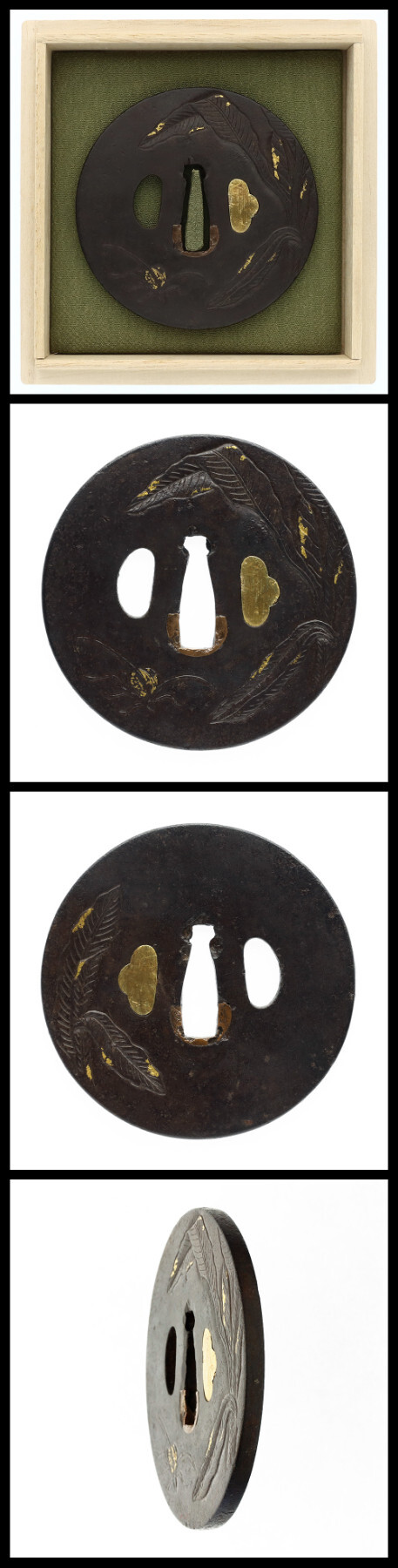

I want to post some details of the fittings.
Originally I wanted this fuchikashira: https://www.aoijapan.com/fuchikashira-bushu-ju-harima-taisei-kouchinnbthk-hozon-tosogu/
But the lab told me it was not fitting well and the lab proposed the one in the picture below "found in their treasure box" - however this one is not papered (the others are all papered)
I would be interested to hear any thoughts on whether this seems like a good decision aesthetically and historically.
This is a very special project for me. I spent around a year saving before being able to afford the blade, and now I am waiting more than six months for the koshirae to be completed. I still have not seen the blade in person, so I am trying to use this waiting time to study and understand the sword and fittings as much as possible.
Thank you again for any comments or guidance.
Dear Rob,
I can chime in.
  1. How should I understand this blade within late Muromachi / Sue-Bizen production?
It is a blade of the late Osafune school, in its fourth phase of activity, the so-called "Sue-Bizen" phase that last until the flood of the river Yoshii. Bizen was the largest production center of swords, and produced both domestic and foreign exports to the mainland. If you want to really take a deep dive into the school to contextualize the work within the broader school period, check here: https://nihontowatch.com/lineages/osafune (note that it is a very early project, and will contains errors).
  1. I understand that many Sue-Bizen blades were made during a period of heavy demand, but this example is signed, dated, Tokubetsu Hozon, and appears to have been considered worthy of a Hon’ami Nisshu oshigata. Does this place it above ordinary wartime production, or is that still too broad an assumption?
Because it is a finely crafted blade, in a period where quality varied dramatically based on the client demands. Contrary to an old belief, even in blades without the full artisan name spelled out, there are some high-quality pieces intended as top of the line products. Note that Hon'ami Nisshu was not a exceedingly good at kantei, some of his sayagaki call for enhanced scrutiny (i.e. are inflated or simply off), and one should have ideally the kiwame (appraisal) confirmed by Tanobe sensei.
  1. Why does the sayagaki use the fuller attribution “Gorōzaemon no Jō Kiyomitsu”, while the mei itself reads “Bizen Kuni jū Osafune Kiyomitsu saku kore”?
The traits indicative of master Gorōzaemon's hand are apparent in the blade to the eyes of Hon'ami Nisshu, allowing for the narrowing of the attribution. Alternatively, In certain cases, it is a statement on the quality rather than a narrowing of the attribution range, a way to praise the sword above those bearing this signature type.
You can learn about “Gorōzaemon no Jō Kiyomitsu” here: https://nihontowatch.com/artists/kiyomitsu-KIY173
  1. Am I correct in thinking that the sayagaki is identifying the specific Kiyomitsu generation/title, rather than contradicting the mei?
It is narrowing down to the author, there is no contradiction. Kiyomitsu is a lineage within Sue-Bizen, and many smiths operated under this name. Similar with the Sukesada line.
  1. I am also commissioning a new koshirae in Japan using selected antique fittings. The planned fittings include an Aizu Shōami iron tsuba, shakudō fuchi-kashira, antique menuki, black samegawa, dark brown silk tsuka-ito, black lacquer saya, and a custom satin silver habaki. I will attach some pictures below. As a general sanity check, does this seem like a coherent project for this type of blade? I am aiming for something understated, historically respectful, and not overly decorative.
I think this is the right approach and you don't need the usual warning of avoiding the "koshirae americana" style. In my experience, it is useful to study books on Koshirae with historical photos, check Markus's Sesko website - there is, as I recall, a lovely illustrated book on Koshirae that he has translated. Do keep in mind that you are unlikely to recoup your investment, it is a labor of love and a to leave behind a testament of care to the sword for the next owner. Also, be aware that Tosogu are not 'modular' in their ability to fit blades, there is no standard rail measurements. Fuchi, Kashira, Tsuba, all need to be appropriately sized to the blade's proportion, and reworked in some cases. Avoiding excessive rework on precious tosogu is important, as it may lead to the proportions being off on top of it. For instance, Fuchi and Tsuba Seppa Dai need to be close in measurements, and the overall pieces need to be appropriate for the motohaba and kasane of the blade.

I understand that this will not be an NBTHK competition-level koshirae, the quote for the habaki+koshirae with AOI is 310k jpy. I see it more as a long-term labour of care around the sword.
Regarding the cost, the blade itself was a significant investment, and the remaining amount is for the selected fittings, new koshirae work, custom habaki, import and transport. The work is being handled through AOI in Japan. I realise that a full art-patron approach with a top craftsman and competition-level ambition would be a different category altogether, perhaps something for a future project if I ever reach that level of collecting.
Your point about tosogu not being modular is also very useful. In fact, one of the fuchi-kashira sets I originally selected was rejected by the workshop because it did not fit the project well, and they proposed another one from their own stock. That now makes much more sense to me.

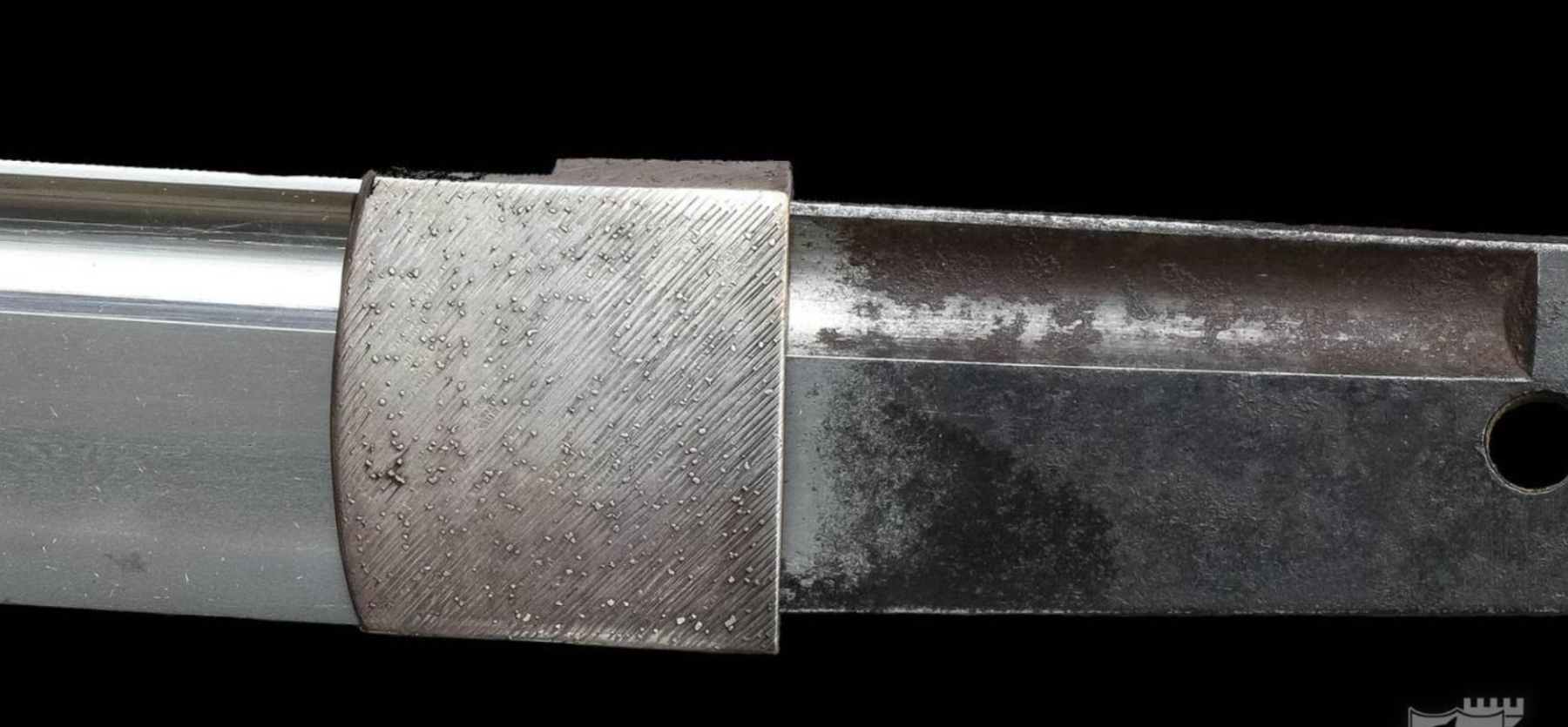

About the bo-hi: I understand it is a matter of personal taste, but in my case I actually really like it. One feature I especially liked is that the hi appears to stop above the habaki rather than running down into the nakago. I have not seen many Kiyomitsu examples with this exact appearance, so it was one of the details that attracted me to the blade. Can you confirm it's not common?

Hi @RobDam
You are most welcome. Always love seeing fine Kiyomitsu blades come around.

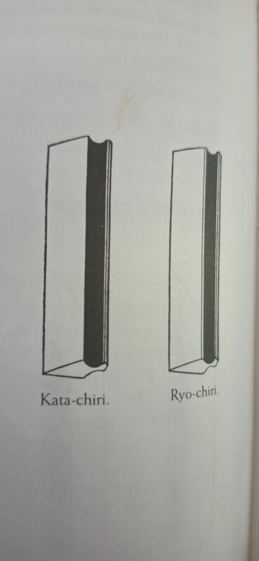

It is generally difficult to evaluate bo hi due to many variables. Yes they are somewhat time period / school /smith associated but there were always exceptions. And more importantly, they were often added later ( ato bi ). Meaning yours may have started without a bo hi but was added later. It s often hard to tell
Your s ends in Maru-dome at the bottom which is a common feature of muromachi Bizen but it is also ryo chiri which could be considered an outlier. Again it is often difficult to evaluate bo hi so I wouldnt really worry about it.
Thank you, that makes sense.
I liked the bo-hi mostly for aesthetic reasons, especially the maru-dome ending above the habaki, but I understand now that it should not be overinterpreted for attribution, especially if ato-bi is possible.
The ryō-chiri point is very interesting, I didn't know that distinction before Thanks again, this is very helpful!!

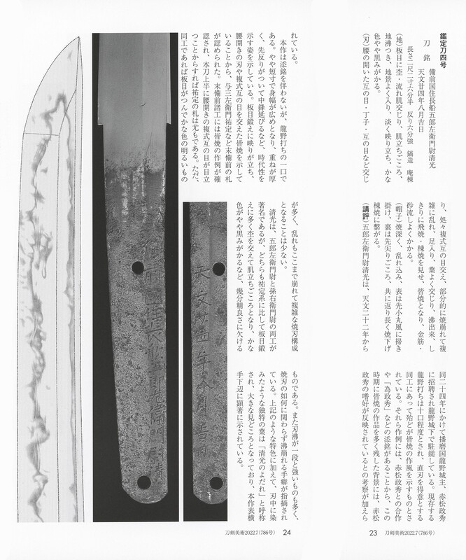

Posted (edited)
44 minutes ago, CSM101 said:
Token Bijutsu  786 Gorozaemon Kiyomitsu
Ok - this is actually interesting:
Eiroku 5 nen 8 gatsu kichijitsu
August 1562
If I understand correctly this invalidates the assumption Eiroku 5 is “too late” for Gorōzaemon.
Edited by RobDam
Posted (edited)
Of course, the difference is that the Token Bijutsu example has the full Gorōzaemon no Jō name in the mei, while my blade has the more general Bizen Kuni jū Osafune Kiyomitsu saku kore signature. So perhaps the real question is not only chronology, but whether workmanship and mei style are enough to narrow a general Kiyomitsu signature to Gorōzaemon, or whether Magōemon remains more likely.
(And if a consequence I potentially overvalued the blade)
Edited by RobDam
@RobDam
I believe that token bijutsu blade reads Tenbun if im not mistaken.
And no I think what you paid for is very resonable for what you have. A very fine sue bizen work with a nisshu sayagaki.
While he doesnt carry the reputation of Tanobe sensei. He was still recognized as a living national treasure and his calligraphy is most beautiful of all in my opinion. His sayagaki certainly adds value
  • Love 1

Hey George,
Super appreciated, thank you!
YES! First time (newbie here)
I actually went through the thread you pinned about oversized tsuba a few hours ago, so now I have an additional concern, lol.
That said, I assume AOI is quite serious when it comes to commissioned koshirae.
I need more time to fully digest your comment, but meanwhile let me explain the rationale behind this project.
1. The idea is to take a “war period” blade and dress it in a calmer, more restrained Edo-period style, using authenticated antique tosogu where possible. I am not trying to recreate a battlefield mounting.
2. I want something respectful, austere and historically plausible for a blade that has survived into a later peaceful context.
3. A calm, nature-based theme. Austere rather than flashy or over-coloured.
4. The koshirae cost should remain reasonably below the cost of the blade.
5. The overall feeling should be quiet, strong and understated.
This is what I literally requested from AOI:
Quote
For the koshirae, I would prefer a simple and austere style in the 150,000–200,000 yen range, similar to sample 23517. (23517koshirae.jpg
Tsuka:
Full wrap / maru-gise black samegawa.
Dark brown silk tsuka-ito in hineri-maki style.
Saya:
Plain black lacquer.
I trust your judgment regarding the fitting and overall harmony of the koshirae.
Habaki:
I would like to change the habaki to a custom silver one with a satin finish, not highly polished, as I feel this may better match the overall character of the blade and fittings. As per picture attached:
Your point about tsuka size is very useful. I definitely do not want a modern oversized martial-arts style tsuka.
I didn't know this should be specified to them, I was assuming they will be respectful of the traditions.
Regarding kozuka/kogai, I had not planned to add them.
The tsunagi point is also very helpful. I had not thought enough about that, and I will ask whether one is included or recommended.
BTW I also have a name for the Koshirae: Kage-Aki Koshirae :) and blade = Kagemasa
Finally AOI art acknowledge everything and the work started 31st of March with an ETA of 7 months.
MAybe too late to ask for changes?
Thanks again. This is exactly the kind of practical advice I need before the work is finalised.
