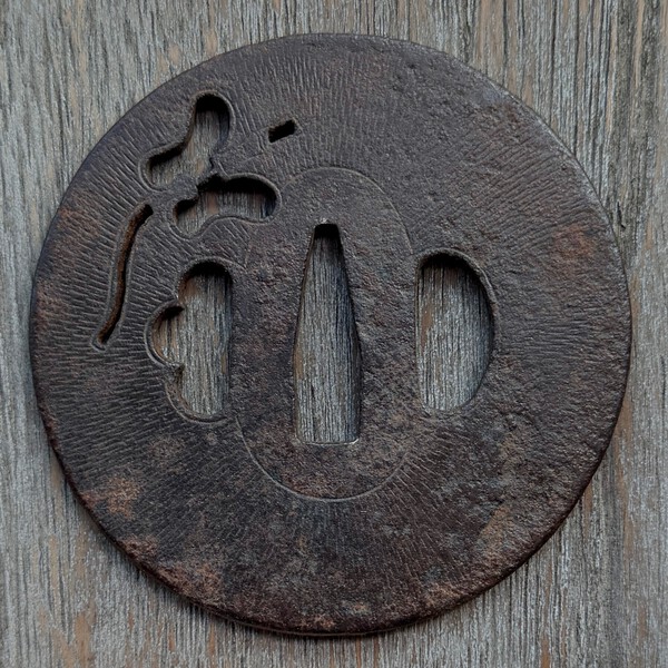

Hello Nihonto Fans,
Yes, me again 😁
My second purchase this weekend!
117 gram - iron
7,8 x 7,8 x 0,40 cm
All info and comments are welcome (as always 😉)
Posted (edited)
I think this is a type with "crepe ishime" - there is a proper term in Japanese but I don't have it handy. These seem to be from a school that specialized in this decoration, designs vary a lot but there are many examples where the piercing shifts position around the plate. I have been collecting images of these for some time and note there are two main styles - one with the seppa-dai and hitsu outlined and the other where the ishime is not "contained" Here are three with the same "gumbai" piercing design. If you can find another they make a great daisho! [My "daisho" with a different pierced design.]
