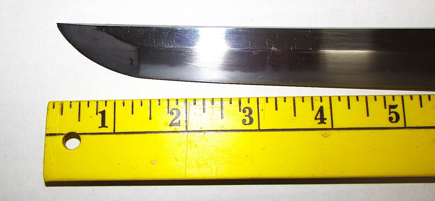

Metal saya? Close up on kissaki
Is nagasa really below 60,6cm/23,858 in.?

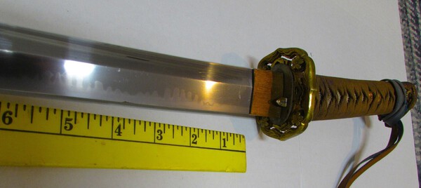

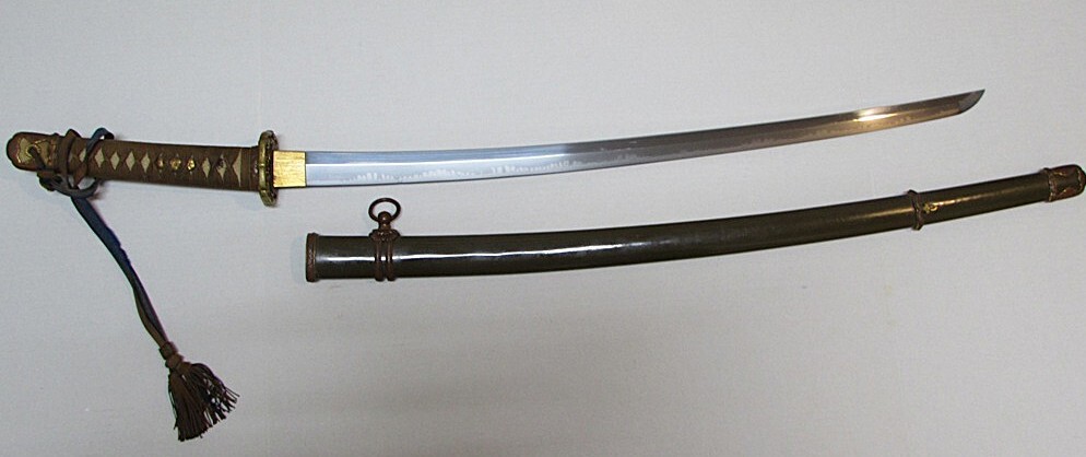

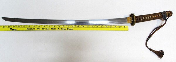

Attached are more photos of the Emura.  You were correct the nagasa is over Katana Length closer to 26 1/2 inches.  Hope these pictures are what you were looking for.  In any event,
pleae give me your overall opinion on the sword.  I have been somewhat overwelmed the past few days as I aquired this sword along with 5 others as a group and got confuesed on the
length of the blade.   If I might ask, please share with me your value thoughts on this particular sword.  Mounts are excellent original condition with a Lt grade tassel and pierced Tsuba.
See Attached
Edward G

Blade that I linked You at the end is cuurently in the process of getting NBTHK Hozon.
You can check for any marks at nakago-jiri but looking at yours habaki I have no hope.

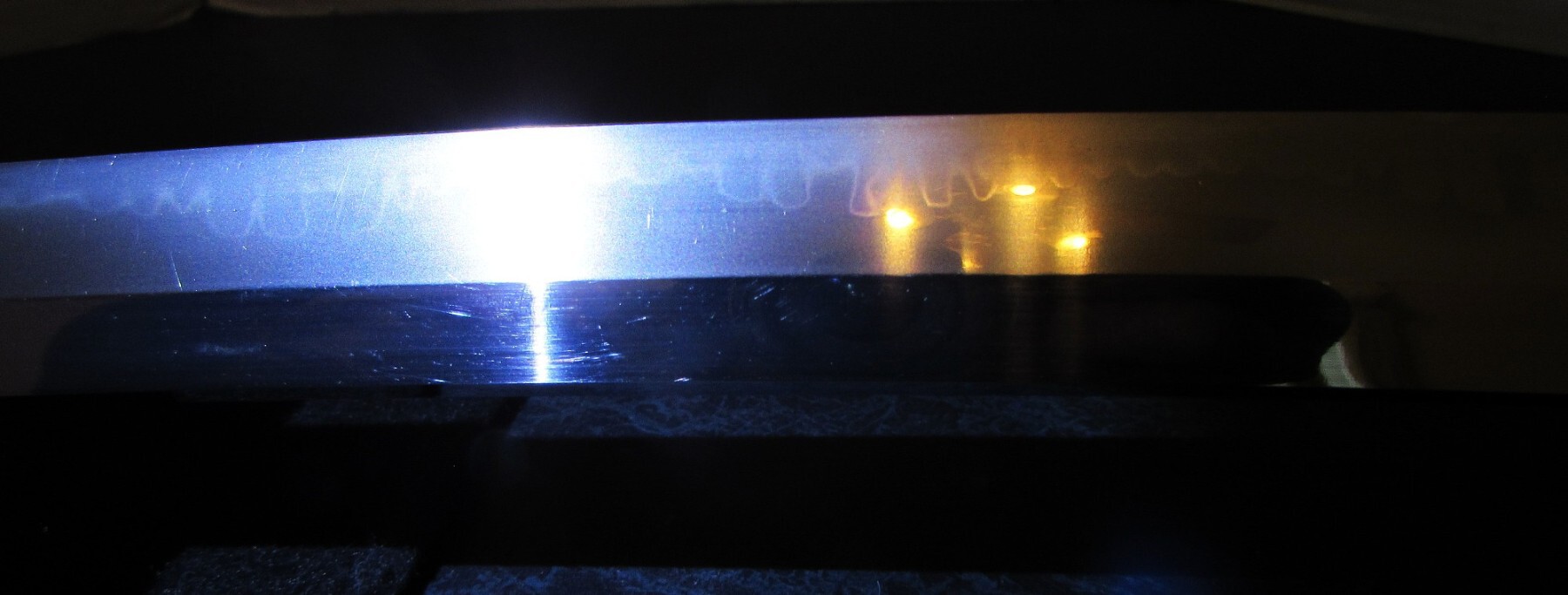

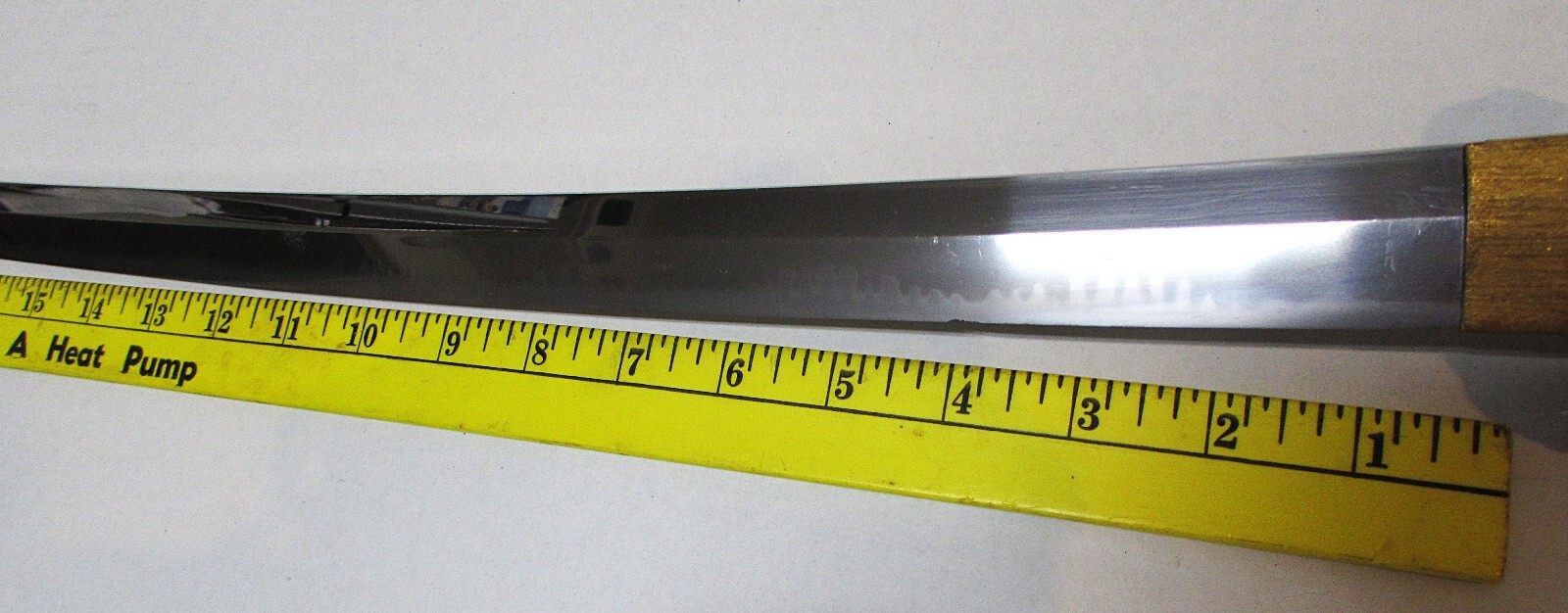

Please add close up of hamon.
Guys here are more experienced but it looks like Gunome mixed with choji.
As waves are regular I dropped - midare.
(yeah I know every hamon other then suguha is midareba, just it dsn’t look like typical chaotic choji)

I’m not going for value. Emura with longer full mei sold for 1550$
https://www.liveauctioneers.com/item/228312469_wwii-Japanese-katana-w-military-mounts-signed-ww2-willoughby-oh
But how can You compare both swords? Suguha is rare amongst emura-to but Your line also looks original. Almost like made with prefabricated shape.
Sane price up to 2500$ and yet You buying blade not mei.
3 years of hard work. 50 at forging alone, I would go for 20k blades made at prison. They were using autohammers and have unlimited coal and iron way before pearl harbour.
Take care of this black rust spot at ha before You start thinking about selling ;) If it’s at surface only baking soda with choji will make it grey. Show it to someone before etc.
Edited by Rawa
Rawa:
II will admit I am not the best photographer.  However, I think the attached pictures are more detailed than the last ones.  Let me know your thoughts.  Thank you again for the information
Edward G
