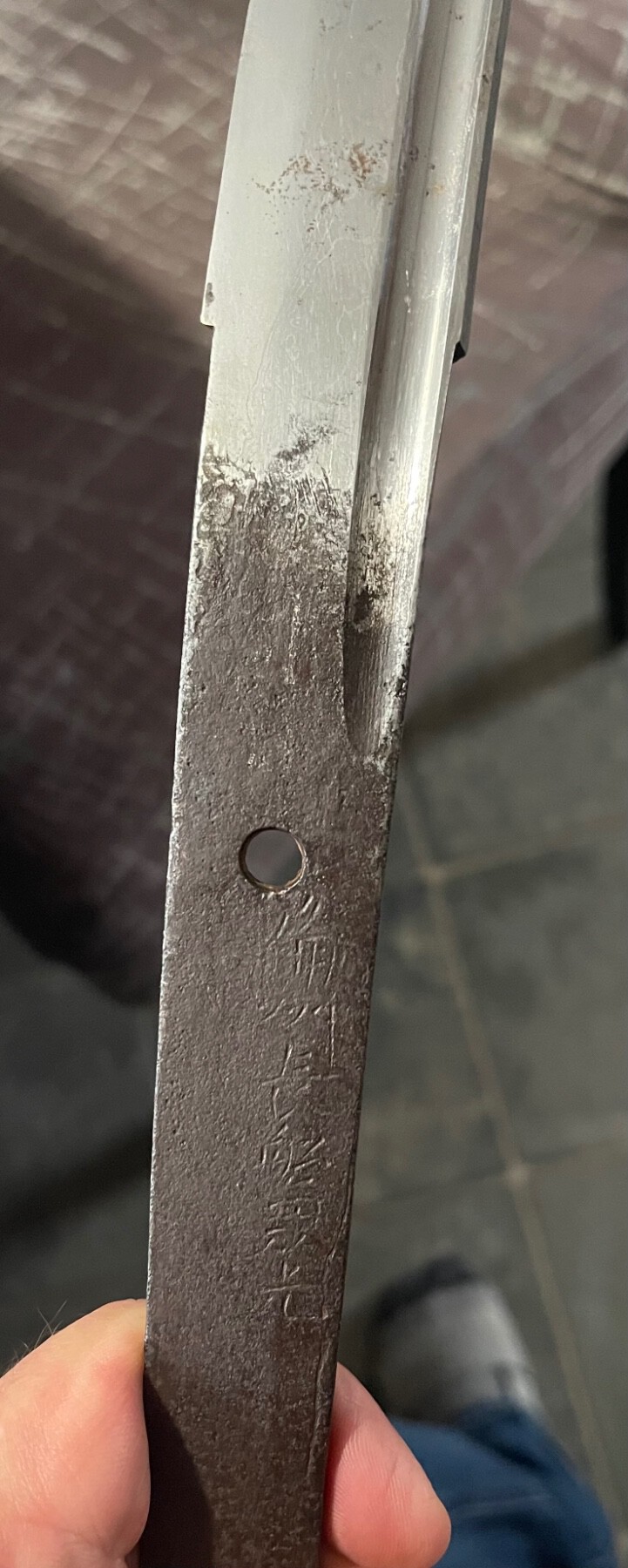

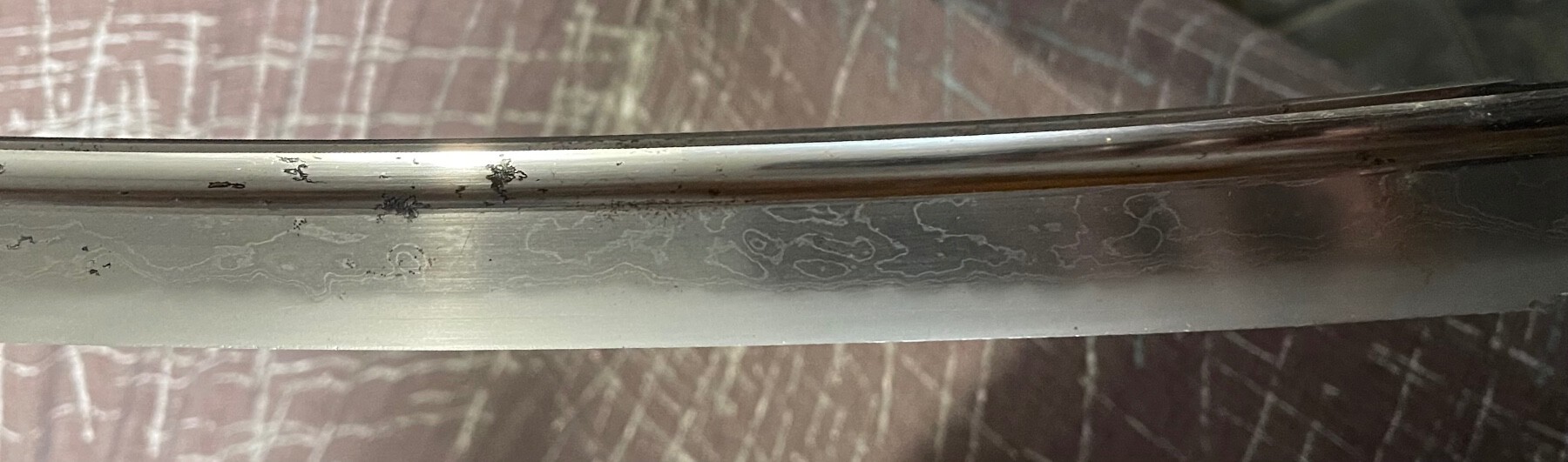

I would be most grateful for thoughts and input on this katana. I posted a note some time ago when I first bought it but have since then had a heck of a time receiving it. Without being too boring about the subject , the auctioneers was first hacked and I nearly paid $3500us to scammers, finally it was sorted out and sent only to be stuck in customs in Canada where it was nearly seized. The shipper put in the customs documents “ not a sale “ and customs used this to fine me $2000 and threaten to seize it. A lawyer later no fine no seizure and surprisingly no taxes or duties ?!
anyway I now have it
A katana signed Bizen Osafune Kanemitsu
machi okuri by about 1 inch
kissaki bit shortened
no fatal flaws
nagasa 27 1/4 inches
Sori 1 inch
rest in cm:
Mihaba 3.4 cm
yokote 2.2 cm
kasane 0.9 cm thick
yokote thickness 0.5 cm
Large burl wood grain and hamon mostly wider and straight with some areas of slight sanbonsugi
I tried to get pics but my pics are crap my apologies
Francis
Any ideas on age etc ?
thank you

Hi @Francis Wick

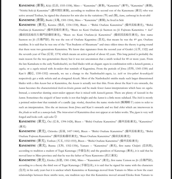

Bizen Kanemitsu worked in the Bunmei
Does the sword have papers ?

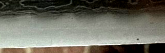

Bizen smiths tend to have good, even, consistent mei strokes but this one seems a bit off based on the pic.
The hada also looks extremely pronounced in that pic. Might have been acid etched at some point and/or improperly cleaned/polished

Thank you Klee
my pics are pretty terrible my apologies. That already gives me an idea of where to start looking for other examples. No papers I just bought it from Estateofmind auctions in New York a month ago . It was a WWII bring back the days has the name of the Japanese officer and his unit and the GI that brought it back

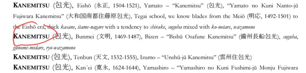

I might have made an error and it might be a different "kane" kanji on the blade. I ll see what I can find in Sesko
I believe it’s the Nagamitsu line of Kanemitsu smiths that this Mei is purporting to be.
I agree that the hada looks like it’s been “enhanced” and not in a good way. There were many generations of smiths signing Kanemitsu and many signed Bishu Osafune Kanemitsu.
Thank you so much. The hada just looks weird because of my crappy pics in good light it’s ok not etched fortunately. I think the Mei is original and contemporary to the sword. Obviously a later Kanemitsu as it is signed on the Omote , not tachi mei but katana mei . If it was kamakura or nambokucho it would have been tachi mei

Hello,
Sorry to hear about your misadventures.
It is indeed a "cursed" sword.
The inscription is not genuine.
Regarding age, difficult to tell. The hada has been acid etched and deviates completely from what you would expect from the Bizen Osafune school. It could be anything  - Given the sugata and the hada, my guess is probably Shinshinto during the phase where they experimented with rather unseemly forms of O-hada, but it is not a high confidence call. Most likely, this is a shinshinto blade made to deceive, or later. You see these types of swords frequently, appearing without papers, on sites such as YJP. The gamblers that are fooled by of these swords on YJP, or elsewhere, often then seek out auction houses to flush away their mistakes to the next person.
For "Big name" smiths, it's best to work with reputable dealers. Sometimes they'll appear on the NA market.
You win a few, you lose a few, such is life.
Good luck in your pursuits,
Hoshi

3 hours ago, Hoshi said:
Hello,

Wow, what an epic!  As a fellow Canadian, I take this as a major cautionary tale.  When you have to involve lawyers, things have gotten out of control!  So far I've been lucky bringing nihonto in from Japan and the USA, but fingers crossed.  I always ensure that the seller lists the full sales price on the paperwork, to ensure that no confusion occurs.  I'd sooner pay the tax than hire a lawyer!
Hoshi has far far more expertise than I.  I do, however, ahem, have some experience with acid etched hamon :-(.  Hoshi may well be right about this, but it a completely different effect than the acid etch on the sword that I have - with mine the edge of the etched area is extremely sharp, too sharp, actually, where-as with this one the edge of the hamon is distinctly blurry.  It could be that it was an acid etch on a dampened sword, but it almost makes me wonder if the hamon was done in the traditional way, but by someone with little experience and in a hurry, such that they didn't carefully define the edge.  The almost harsh reveal of the jihada also suggests possible poor quality polishing - the jihada should be visible, but this is a bit extreme.  If it is Shinshinto, this degree of harshness in the jihada is not a great sign.

I personally don’t think it’s shinshinto as the nakago is very old and the mei is very deeply naturally rusted and smoothed , it’s not made to look that way. It’s an old sword. It may have been wiped with acid some time I’m not sure through , if you look at it under normal light you don’t see the same effect as in the pics. I didn’t have to pay for a lawyer and all my paperwork was true and accurate so it was one phone call and it was sorted, just a lot of stress. He was happy to do it for no fee, but nevertheless next time I’m not letting the shipper fill anything in !
23 minutes ago, ROKUJURO said:
A 15th century sword blade with a KASANE of 9 mm might be a very rare thing.
Yes indeed pretty thick. The Hoshi I think has been a bit reshaped it looks like it was made shorter by a few mm probably to get rid of a big chip. Machi okuri also means it was refitted later to newer fittings. Not something a shinshinto blade would usually be subjected to ….?

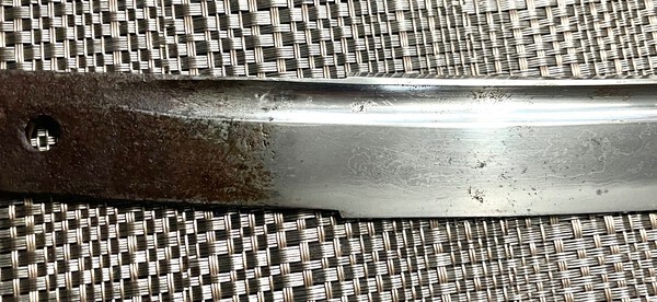

I like this sword.
Nice itame hada and beautiful gunome midare hamon.
This sword needs a good polish to see its beauty.
I belive its late muromachi.
Kissaki was slightly reshaped but nothing to fear off.

6 hours ago, vajo said:
I like this sword.
image.png.c076ec3069c89863c1b702b4d2f65491.pngimage.png.997c75fca1ef70af91e4493beea0c2bd.png
Thank you ,I also think late muromachi possibly the Kanemitsu of Bunmei like Klee pointed out in the chart he so kindly provided. What makes the nakago look a bit weird is a machi okuri of about an inch. Together with purchase cost and a polish it will be pushing $7k ,likely a bit much for it ,but I like the shape and that it is signed so I’ll probably get it fixed up . It has plenty meat for a polish so even if the surface was etched it might polish ok. Thanks for the input 🙏🏽

18 minutes ago, Jacques said:
IMHO this sword is a kazu-uchi mono pretty tired (look at the machi).
Thank you Jacques. It is still very thick with little surface wear. I don’t think it has had a huge amount of polishes. The blade is almost 1cm thick at the machi. No open grain anywhere. Whether it was mass produced I won’t be able to say I guess it depends on smith and period more than anything

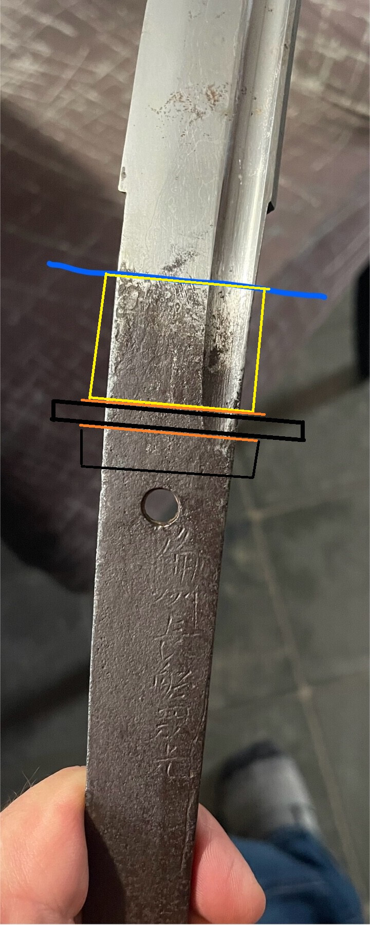

I would agree with the view that Jacques has on this. I would think it would most likely be late Muromachi Bizen sword, wheter actually someone named Kanemitsu that I cannot say. However I would think the sword is in original state. I tried to do quick sketch with paint how I would expect it to look originally in fittings if it would have been machi okuri at your line, of course it is just a rough sketch to give an idea that I have in my mind. To me the hole placement looks perfectly normal now in current state, if it would have been machiokuri then the original hole would have been unusually close to the machi.
Machioku1.thumb.jpeg.9b1e947f187ab8127c4d1bea5f25955c.jpeg.
I do have some amazing resources on Bizen swords, however I have not been able to find a reference signature of any late Muromachi Kanemitsu. I am extremely grateful for this thread as I tried to search them and ended up discovering absolutely massive Nanbokuchō naginata by Kanemitsu that I was not aware of before. Finding items like that in Japan makes me very happy. One "cursed" thing about smith lineages where there are extremely famous ones is that then many later generations can fall into obscurity.
