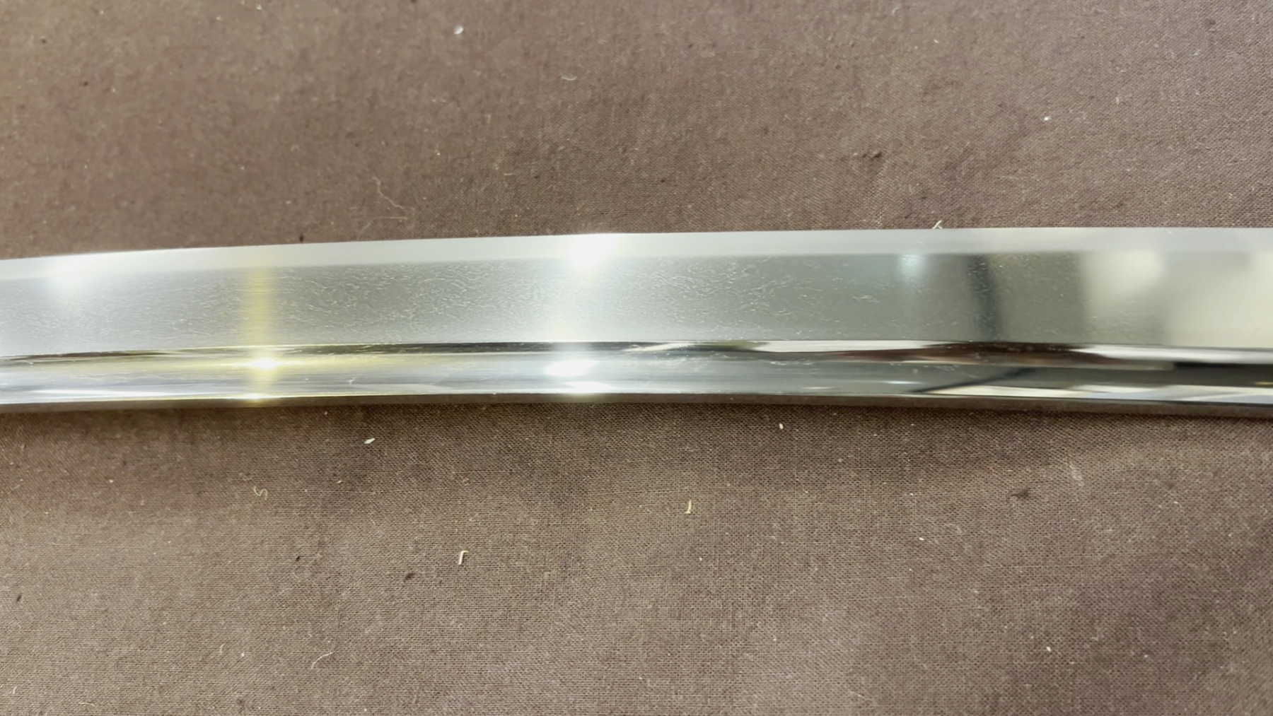

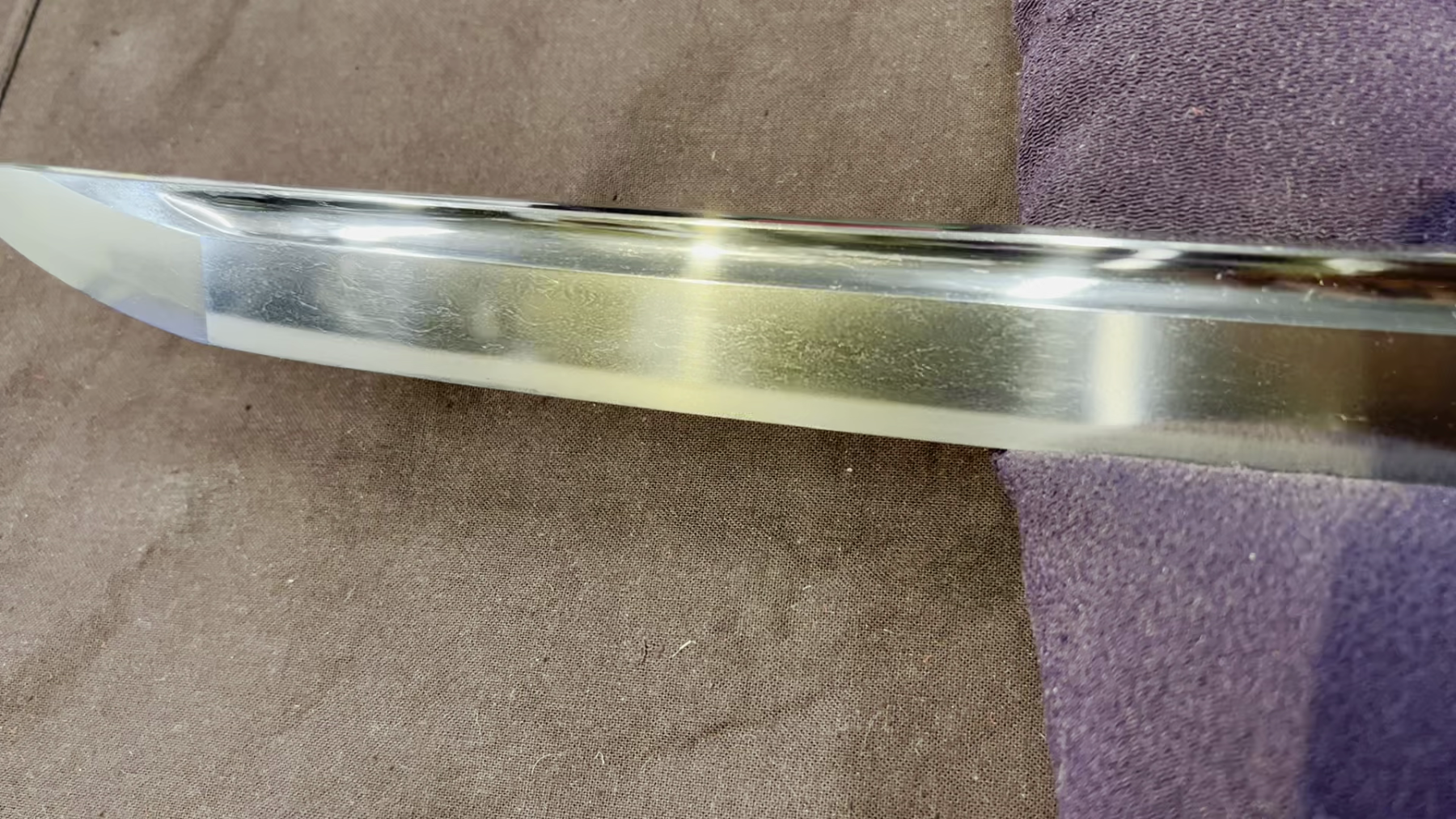

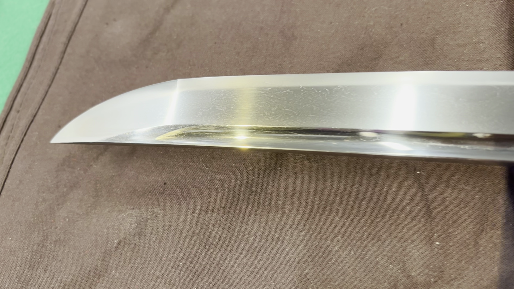

Very interested to see what the more experienced members think, but just on their face they seem quite different pieces, while both gorgeous. A large and wide Enbun-Joji sugata Yamato style katana vs a rather elegant katateuchi-seeming Bizen blade (at least to my beginner eye, given its short length, narrow width, and shorter nakago). I like them both, but would enjoy hearing what draws you to each of them.
Quite right! They both appeal to me in different ways. I would love to own a Yasumitsu as Bizen is probably my favorite tradition overall. The nie utsuri is beautiful and the piece overall is quite elegant as you said. I am a sucker for shorter katanas for some reason. It seems like it might be machiokuri though. On the flip side I also have 2 late Kamakura / early Nanbokucho Yamashiro blades that are quite slender and elegant and I think for the period the size and shape of this Ko-Mihara is, well, quite awesome :laughing:. Not to mention it seems in very good condition.

Hi Sky,
The only thing I would mention re the ko Mihara blade is that Aoi’s oshigata hints at utsuri but I can’t see it mentioned in the setsumei (but I’m on my phone and am prone to errors) so that might be something to look at if it might be significant for you.

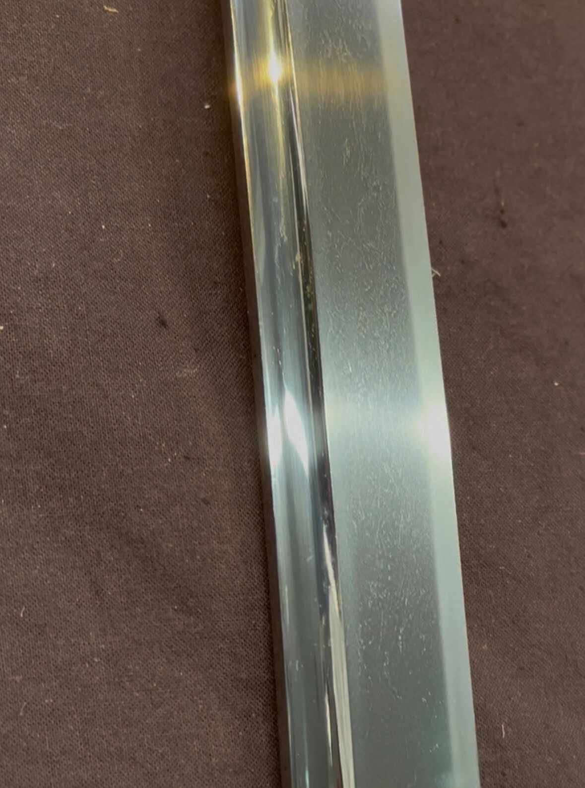

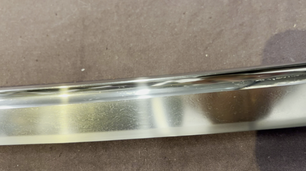

Yeah the description from Aoi and the oshigata both tell/show utsuri. So those images I posted are stills from a video and I do see it in the video. Here is an image I think shows it better, check the area running parallel to the bohi that matches the oshigata. I think the setsumei does actually mention it, near the bottom right side: "僅かに白気映り立つ"
Bo utsuri?

Posted (edited)
54 minutes ago, Lewis B said:
Bo utsuri?
I think so, but looking at the oshigata it is a bit scattered so others might have a better idea or experience with what that means
