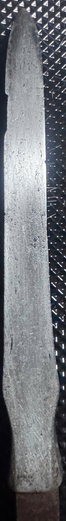

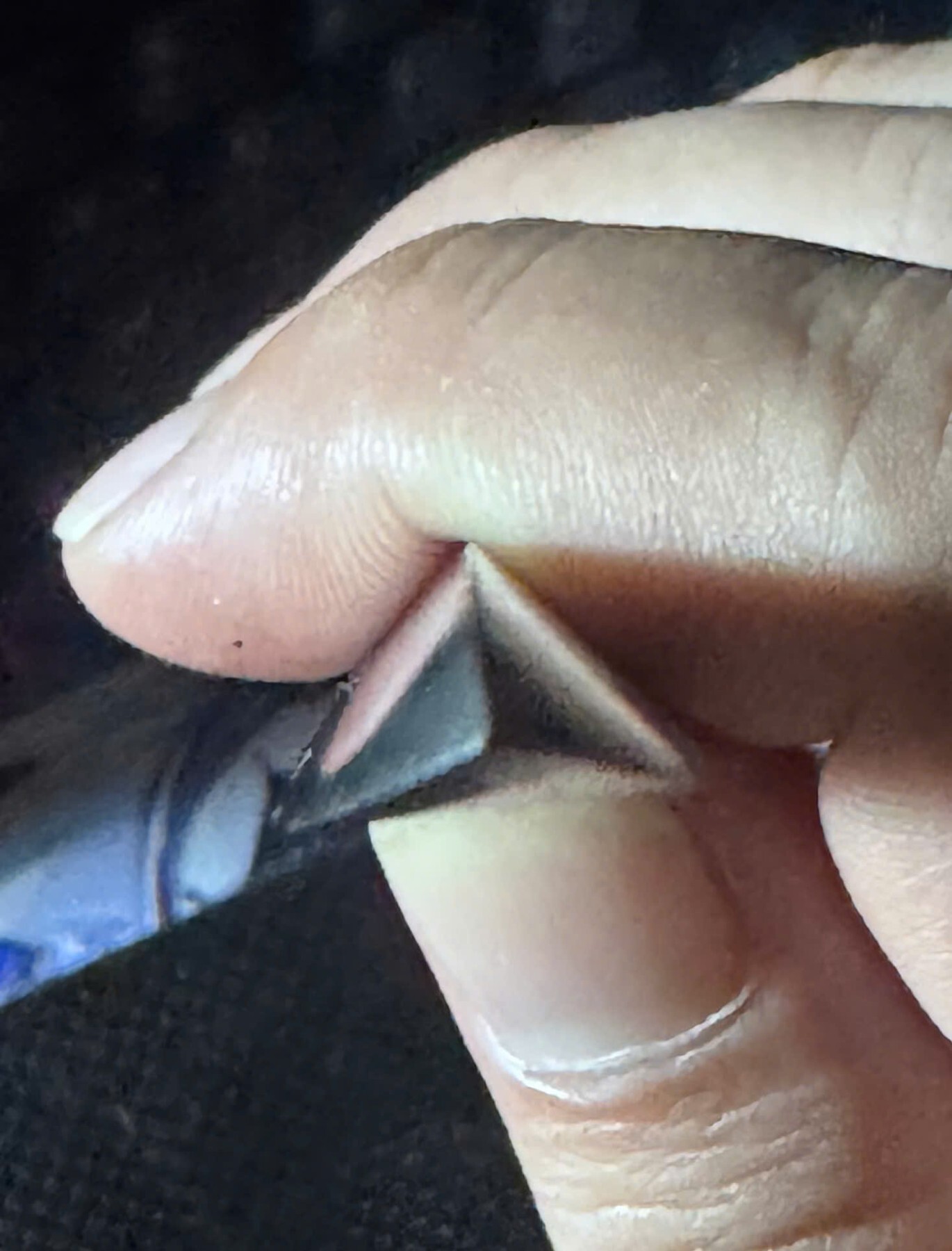

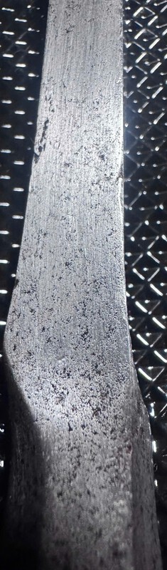

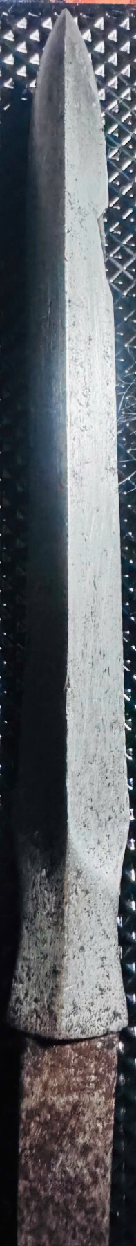

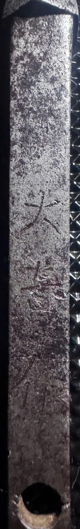

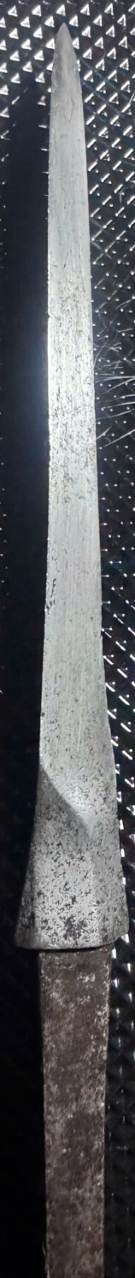

JackDo Posted November 11, 2025 Author Report Posted November 11, 2025 Hello everyone, I recently found another yari with a very interesting shape — it looks like a sankaku (triangular) piercing type, almost like an awl designed to punch through armor. The blade length is about 15 cm, the nakago about 23 cm, and the maximum width only 1.7 cm, which makes it quite slim and compact compared to most standard yari. There are some impact marks and a small chip on one edge, as well as pressure dents along the ridge, suggesting it may have struck. The tang bears a mei, although it has been softened a bit by time. It also seems that the previous owner or seller cleaned off some rust on the blade, leaving a partially bright surface while the nakago retains its old patina. I would really appreciate your thoughts on its possible age, school, and origin. Thank you for your time and expertise! Best regards, Jack! Quote
ROKUJURO Posted November 11, 2025 Report Posted November 11, 2025 (edited) NEVER touch a blade with your bare fingers! It looks like a variant of a (damaged?) SANKAKU YARI. Edited November 11, 2025 by ROKUJURO 1 Quote
Bugyotsuji Posted November 12, 2025 Report Posted November 12, 2025 Fairly common Hira-sankaku Yari indeed, but heavily damaged. I’ve never before seen a gimei Yari, but 大吉 作sounds more like a fortune telling than a real smith’s name. The slightly longer kerakubi could indicate a little more age, possibly early to mid Edo period(?), but I’m just guessing. 1 1 Quote
