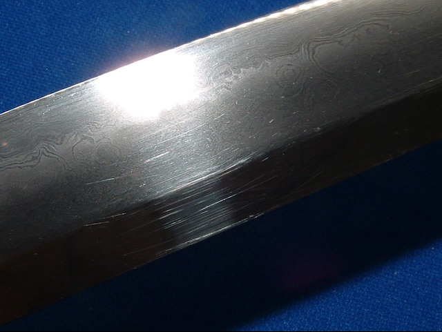

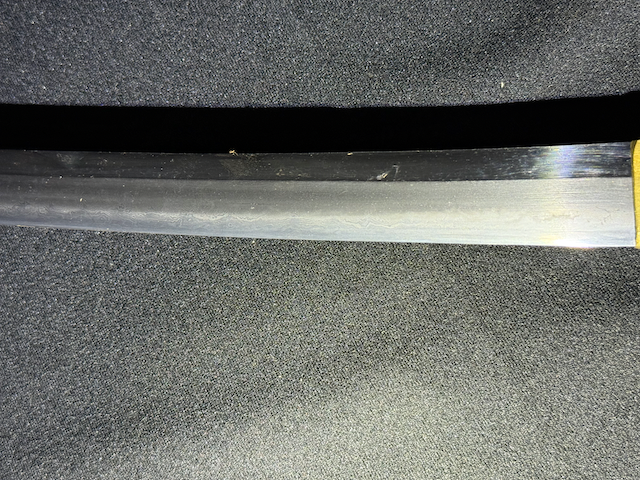

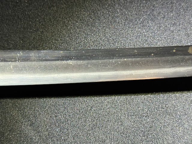

Conway Posted October 6, 2025 Report Posted October 6, 2025 Greetings, Found this example over the weekend coming from Komonjo’s workshop. Unfortunately some unscrupulous individual has added an Amahide mei to presumably increase bids for a well-known smith. This is the third example of a Shigenaga stamped mei I have come across. His name does not appear in Sesko’s Swordsmiths of Japan or other lists I have searched. Has anyone discovered any other details on this smith? From the examples I have seen, there is a nice hada present. I would say it resembles ayasugi hada, but that’s just my novice opinion. Japanese Sword: IJA WW-II Amahide Imperial Army Gunto Con Quote
Rawa Posted October 7, 2025 Report Posted October 7, 2025 (edited) Wasn't acid used here? No sign of nagashi. But "Amahide" can be confusing. Edited October 7, 2025 by Rawa Quote

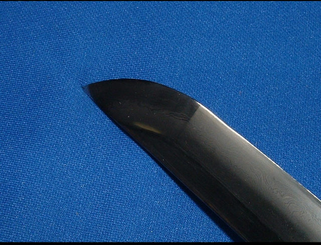

PNSSHOGUN Posted October 7, 2025 Report Posted October 7, 2025 The hada is quite particular to Amahide swords, if Komonjo is adding false Showato mei the situation is becoming rather dire. Quote
Conway Posted October 7, 2025 Author Report Posted October 7, 2025 Something about the mei is off. The characters are poorly executed, even for a showato. The chiseling looks smooth as opposed to chippy. But then again, the patination on the nakago appears natural. Quote
PNSSHOGUN Posted October 7, 2025 Report Posted October 7, 2025 There was a great deal of variance with Amahide Mei, with some examples having various stamps on the Nakago. By comparison the recent fake swords with Gendai Mei have been pretty obvious and unsophisticated. Not defending the seller at all but this looks about right for Amahide in Mei and Deki. 1 2 Quote

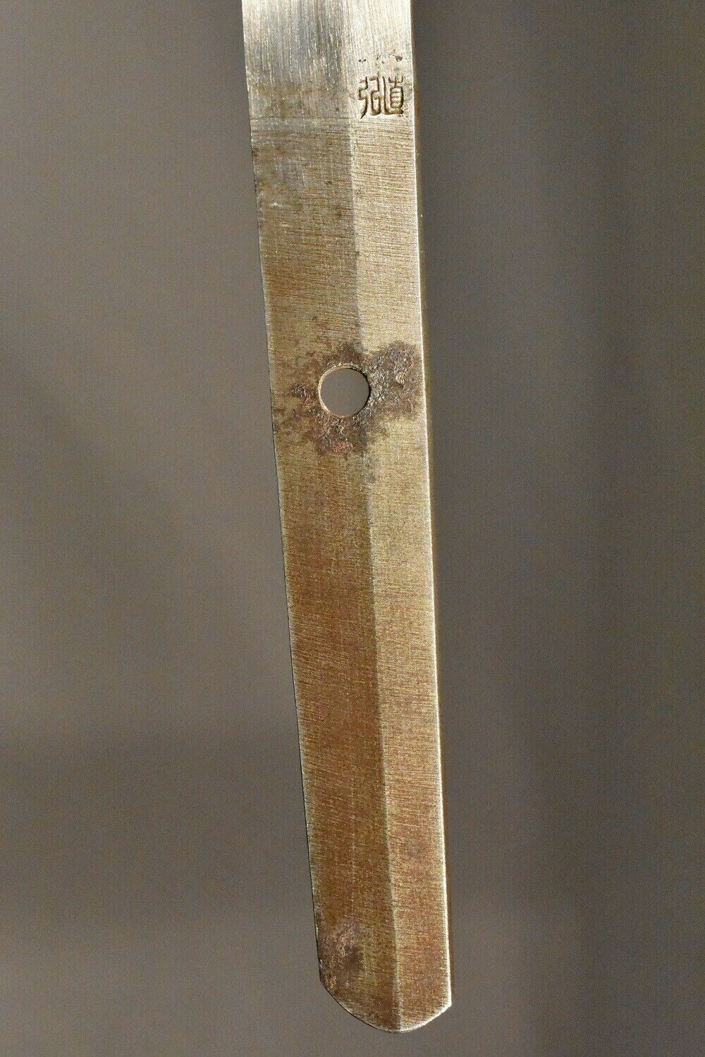

Conway Posted October 7, 2025 Author Report Posted October 7, 2025 Thanks for the second opinion, John. Since this was only the third time I have seen this stamped mei, I was skeptical seeing this one coming from Komonjo. I also found this example of another stamped mei - 金丸(Kanemura) on an Amahide : Maybe these are some of the other smiths working from Amahide’s workshop. Quote
Bruce Pennington Posted October 7, 2025 Report Posted October 7, 2025 From Sesko's list: "KANEMARU (金丸), Shōwa (昭和, 1926-1989), Nagasaki – “Kanemaru” (金丸), family name Ogawa (小川), ryōkō no jōi (Akihide), Fifth Seat at the 6th Shinsaku Nihontō Denrankai (新作日本刀展覧会, 1941)" 1 Quote

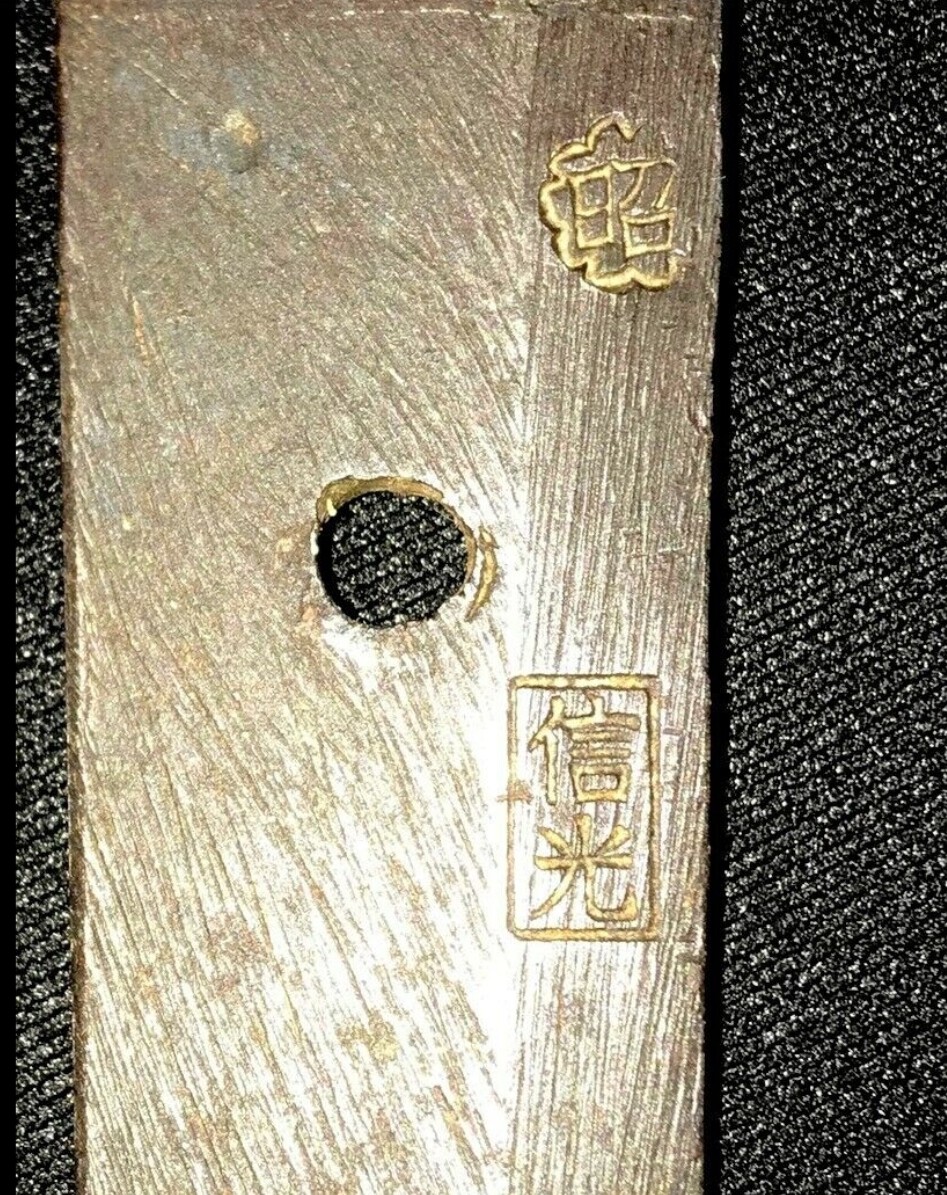

Bruce Pennington Posted October 7, 2025 Report Posted October 7, 2025 The stamped mei were uncommon, but I have a few on file from 4 smiths: Seven blades from Masayuki 9 Naohiro 1 Nobumitsu and now 2 Shigenaga (this one from JSI) We now have 2 Amahide blades with other smith names stamped at the bottom - Shigenaga and Kanemaru. 2 Quote

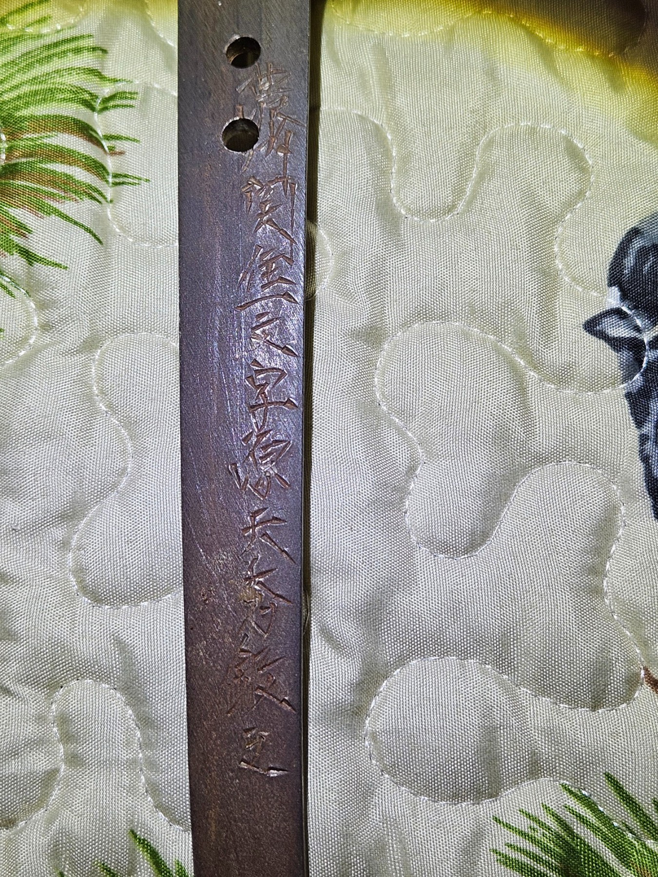

dwmc Posted October 7, 2025 Report Posted October 7, 2025 Is it possible the stamped smith names other than the kanji Mei could possibly a photo added by mistake? I've personally seen this happen on several occasions and when inquiring to the seller they have admitted the erroneous photo was added by mistake. The Mei on the Komonjo workshop ad is identical to my own Daisaku Daimei Amahide sword forged by Ido Hidetoshi. Definitely not gimei. 1 Quote

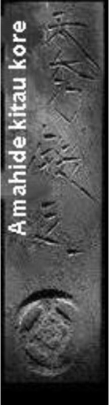

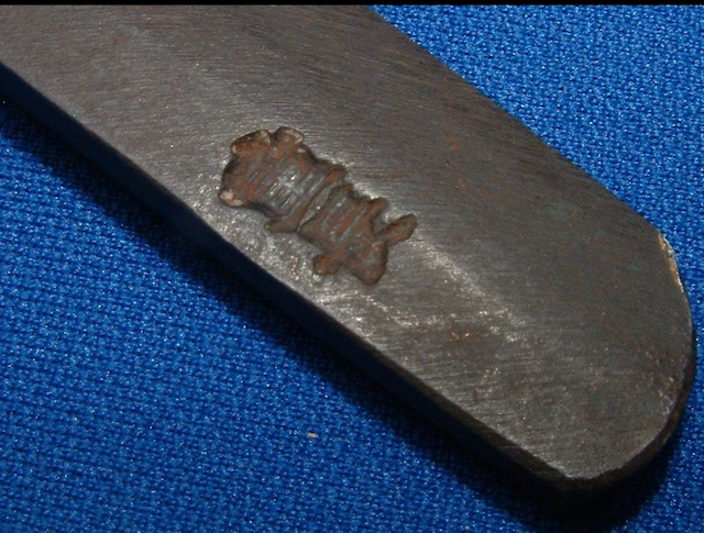

Bruce Pennington Posted October 8, 2025 Report Posted October 8, 2025 2 hours ago, dwmc said: Appears some strange things occurred at the Amahide's sword factory. Yes. He, and/or his forge, had his own kokuin that is seen on his blades, but also on 4 other smiths that must have worked at the forge - Kanemune, Kunimoto, Hidetoshi, and Masafusa And yet, we also have one of his blades with an unknown stamp: And a couple blades with his Retired Servicemen's group, Koa Token Sha, kokuin: All this added to these stamped-mei blades! 2 1 Quote
