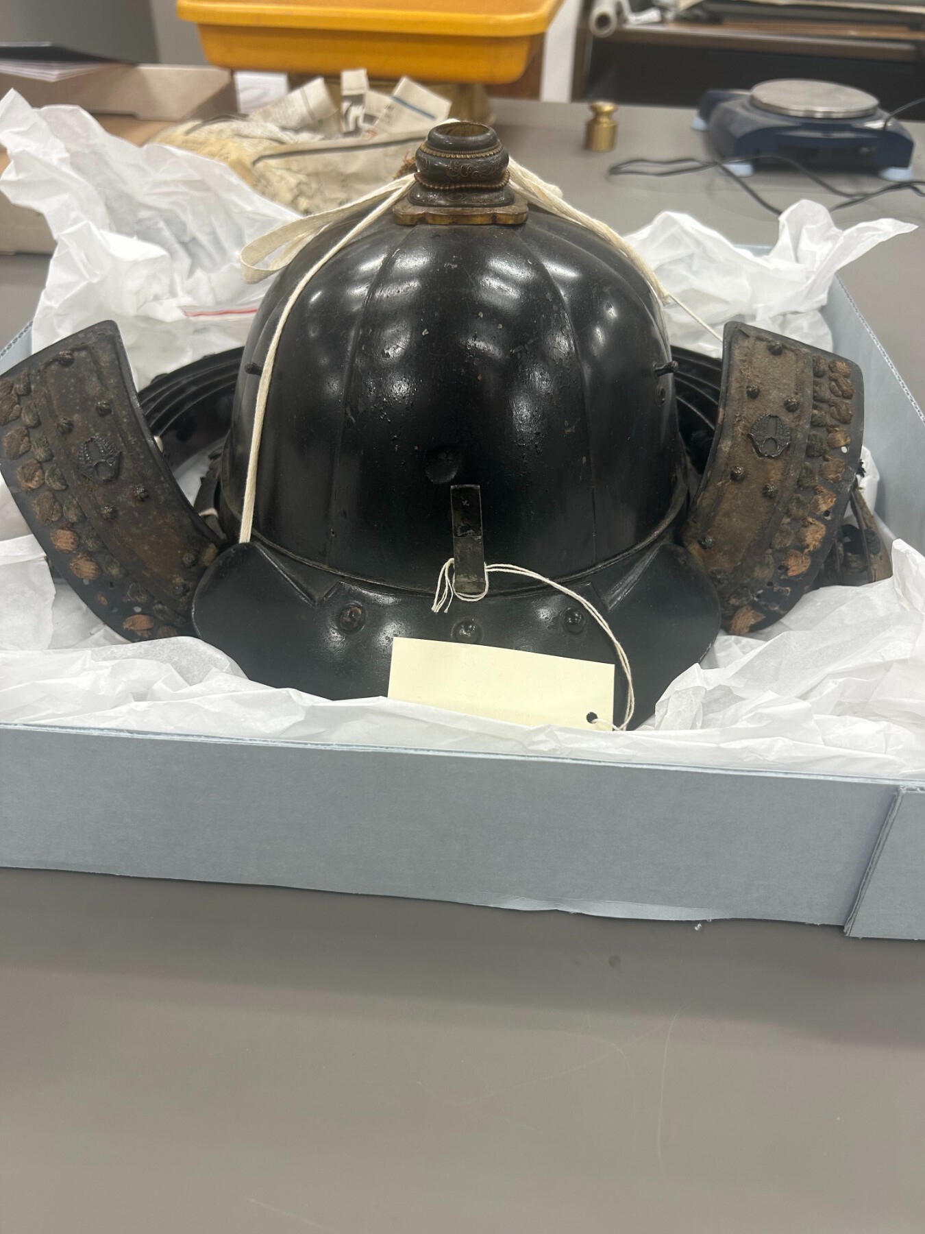

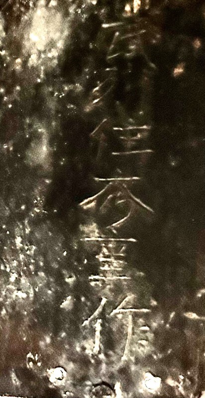

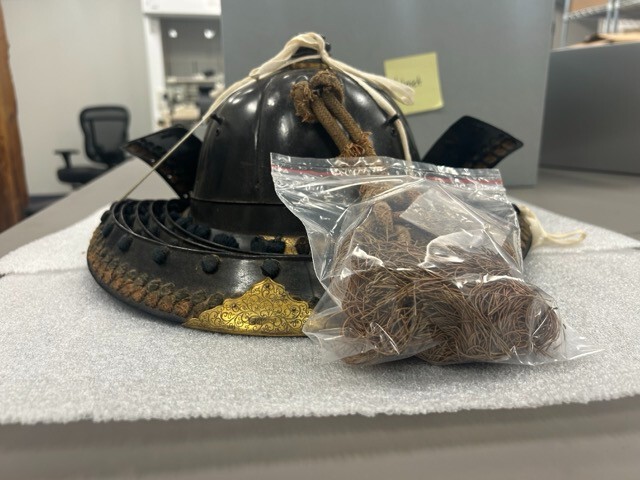

cglog254 Posted September 8, 2025 Report Posted September 8, 2025 Hi all! I am researching on two suits of samurai armor that were acquired by my institution. I have very little familiarity with this field but have put together a decent amount of information. There is a makers mark on the inside of one of the kabuto, and I have only been able to firmly make out the kanji for 作 and 住 (though I am not entirely sure about the second one). I showed two of my Japanese colleagues images (which are low quality, as they had to be taken through a tear in the interior lining of the helmet) and they came to the same conclusions, and told me to seek out someone who may have more familiarity with older Japanese. I am attaching those same images here in hopes that someone can point me in the right direction. We are waiting for some specialized equipment so we can get better images of the makers mark. Thank you in advance for the help! Quote
uwe Posted September 9, 2025 Report Posted September 9, 2025 Welcome Charles, I guess your helmet is signed “武州住秀重作” (Bushū jū Hideshige saku - made by Hideshige of Bushū province). Probably mid Edo!? Pics of the kabuto are welcome 2 Quote
Bugyotsuji Posted September 9, 2025 Report Posted September 9, 2025 中谷要人(秀重) *Nakatani Yōjin (Hideshige) On a hand-drawn map of armourers of Japan, I have just found the name above listed for the Edo/Bushū area. *Alternative but less common reading ‘Nakaya’. http://blog.livedoor.jp/kayoko1227/archives/31862120.html On this page is a reference to a Buddhist bell with an inscription of this name and date of 1630, saying in the Shin Kacchushi Meikan that this refers to the ‘armourer of Buyō’ (Bushū) Nakatani Yojin Hideshige. 4 Quote

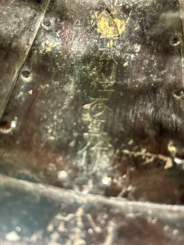

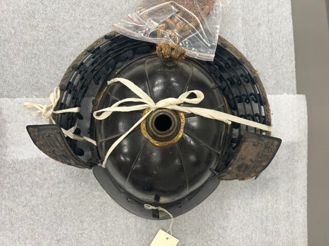

cglog254 Posted September 10, 2025 Author Report Posted September 10, 2025 On 9/9/2025 at 12:27 PM, uwe said: Welcome Charles, I guess your helmet is signed “武州住秀重作” (Bushū jū Hideshige saku - made by Hideshige of Bushū province). Probably mid Edo!? Pics of the kabuto are welcome Thank you! Do you have any idea why the Kanji in the kabuto is so different, particularly 武 and 秀. Is it just practicality in the act of etching, or is it a difference in Japanese language between the Edo period and today? I have attached an image of the kabuto to this message. It is not in the greatest shape. If you can determine anymore information from the picture, please share! Quote
cglog254 Posted September 10, 2025 Author Report Posted September 10, 2025 (edited) On 9/9/2025 at 12:52 PM, Bugyotsuji said: 中谷要人(秀重) *Nakatani Yōjin (Hideshige) On a hand-drawn map of armourers of Japan, I have just found the name above listed for the Edo/Bushū area. *Alternative but less common reading ‘Nakaya’. http://blog.livedoor.jp/kayoko1227/archives/31862120.html On this page is a reference to a Buddhist bell with an inscription of this name and date of 1630, saying in the Shin Kacchushi Meikan that this refers to the ‘armourer of Buyō’ (Bushū) Nakatani Yojin Hideshige. Thank you so much for the reply and the additional information! The reference to the armor smith on the bell is very cool and could potentially be very critical in my research. I was under the impression that the kabuto was much younger than 1630, and I have attached a picture of it to this message. Do you think it could fit the date range that would be provided by the bell? Also, is it possible to share this map of armorers? Thank you! This is very exciting! Edited September 10, 2025 by cglog254 Quote

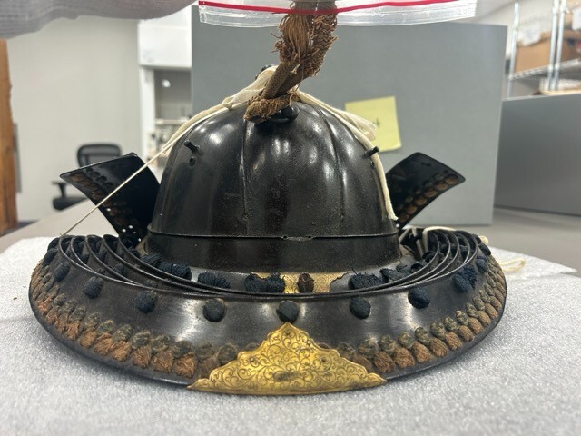

uwe Posted September 10, 2025 Report Posted September 10, 2025 Charles, sometimes you can find remarkably diffrences in the way the kanji were executed in a mei. It depends on the person who carved the characters. You can run into simplifications, abbreviations, sôsho (grass script), or a mixture of all. There is still a lot left to explain.... However, I attached a picture of another example that might help! This single picture is not telling much. Can you provide images from the front, sides, back (all with the same angle), top and bottom? 2 Quote
uwe Posted September 10, 2025 Report Posted September 10, 2025 ...just stumbled over a specimen out of my archive: Guess we can be quite sure! 2 Quote

cglog254 Posted September 11, 2025 Author Report Posted September 11, 2025 5 hours ago, uwe said: Charles, sometimes you can find remarkably diffrences in the way the kanji were executed in a mei. It depends on the person who carved the characters. You can run into simplifications, abbreviations, sôsho (grass script), or a mixture of all. There is still a lot left to explain.... However, I attached a picture of another example that might help! This single picture is not telling much. Can you provide images from the front, sides, back (all with the same angle), top and bottom? Thank you for the information! I am not very well versed in this so I am sorry if my questions seem basic or redundant. Do you have any sources where I may find references to Hideshige of Bushu Province, or more information about him? I do not have pictures from all angles at the moment, so I am attaching what I have on hand. I will photograph from all angles tomorrow and post them to this thread. I am unsure if I will be able to photograph the inside of the helmet tomorrow because the shikoro is very poorly attached due to degradation, and we are trying to avoid causing any unnecessary strain or damage. We are looking at methods to properly document the interior of the kabuto without damaging the shikoro, and I will send pictures when this is achieved. Your help is greatly appreciated! Your information regarding the mei has made my week! 1 1 Quote

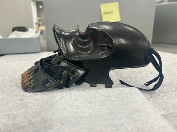

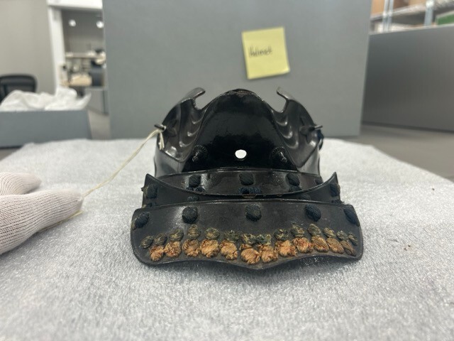

cglog254 Posted September 11, 2025 Author Report Posted September 11, 2025 5 hours ago, uwe said: ...just stumbled over a specimen out of my archive: Guess we can be quite sure! This is another Hideshige? Do you have any more information on this particular example and/or image of the mei? We are trying to compile as much information as possible on our kabuto, and this would be extremely use for comparison! I am also attaching image of the hanbo that was acquired with the helmet. There was no visible mei on first inspection. Do you have any ideas where one would be if it existed on the hanbo? Would mengu/hanbo have traditionally been made by the same craftsmen? Once again, I am sorry for so many questions! There will probably be more as we attempt to document both sets of armor in our possession. Thank you so much for all your help! 1 Quote

cglog254 Posted September 11, 2025 Author Report Posted September 11, 2025 17 hours ago, uwe said: Charles, sometimes you can find remarkably diffrences in the way the kanji were executed in a mei. It depends on the person who carved the characters. You can run into simplifications, abbreviations, sôsho (grass script), or a mixture of all. There is still a lot left to explain.... However, I attached a picture of another example that might help! This single picture is not telling much. Can you provide images from the front, sides, back (all with the same angle), top and bottom? Uwe, I have attached pictures of the helmet from all angles except the bottom. I have also attached images of the mengu which was with the armor from all angles. The kabuto weighs 3.29 kg. Please let me know if there is any other information/images you need. Thank you! 2 Quote

Shogun8 Posted September 11, 2025 Report Posted September 11, 2025 The hanbo seems to have once had a guruwa (additional plates which protect the back of the neck), judging by the remnants of the hinges at the rear of the jaw. This is a rare feature for a hanbo. 2 1 Quote

uwe Posted September 11, 2025 Report Posted September 11, 2025 Hi Charles, thank you for the additional pictures! Here are the signature of my example above: 2 Quote

cglog254 Posted September 15, 2025 Author Report Posted September 15, 2025 On 9/11/2025 at 11:01 AM, Shogun8 said: The hanbo seems to have once had a guruwa (additional plates which protect the back of the neck), judging by the remnants of the hinges at the rear of the jaw. This is a rare feature for a hanbo. That is fascinating. We sadly do not have any guruwa in our collection. Do you know of other examples of hanbo with guruwa/why they were an uncommon feature? Quote
Shogun8 Posted September 17, 2025 Report Posted September 17, 2025 Charles, In general, guruwa and menpo with guruwa were mostly seen in the late Sengoku period, particularly the Momoyama, since protection was paramount. Guruwa on menpo were uncommon probably because they were naturally more difficult - and more expensive - to make. 2 Quote
