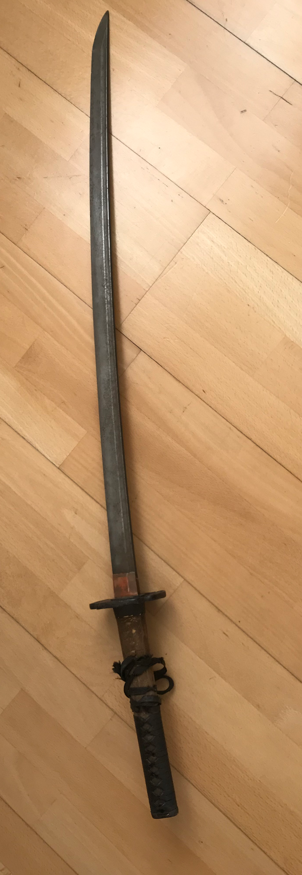

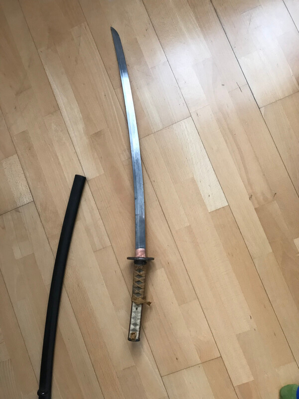

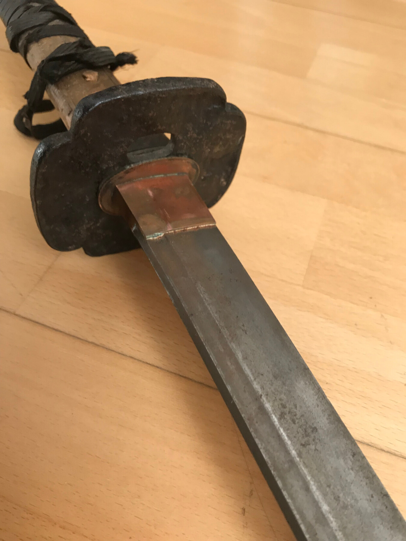

Kubur Posted August 26 Report Posted August 26 Hi everyone, I’d really appreciate your help in identifying two swords I’ve come across. Any insights or guidance would be greatly appreciated. Many thanks in advance! Kubur Quote
ChrisW Posted August 27 Report Posted August 27 Hard to say much other than they appear to be proper antique Japanese swords. Can you give us some measurements? (Blade edge length, etc. ) Pictures of the nakago (tang) would also be very helpful in estimating age/might tell you who made it. Quote
Rivkin Posted August 27 Report Posted August 27 First is koshi zori with a larger chu kissaki. By default Muromachi, less likely later than 1530. Correction: just looked at higher res version, hard to say actually. hope better pictures will tell! Second is shot at weird angle, no comments. Quote

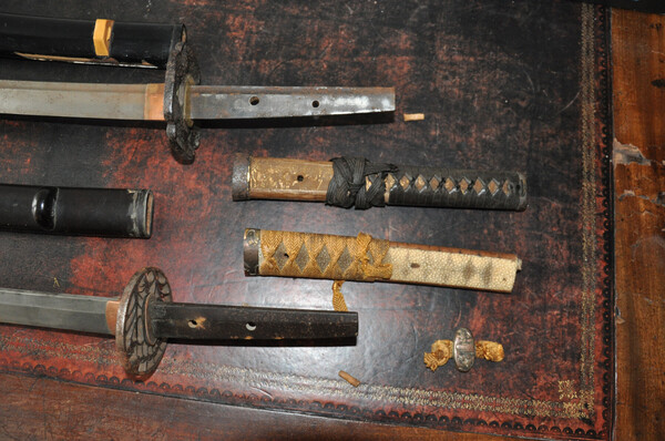

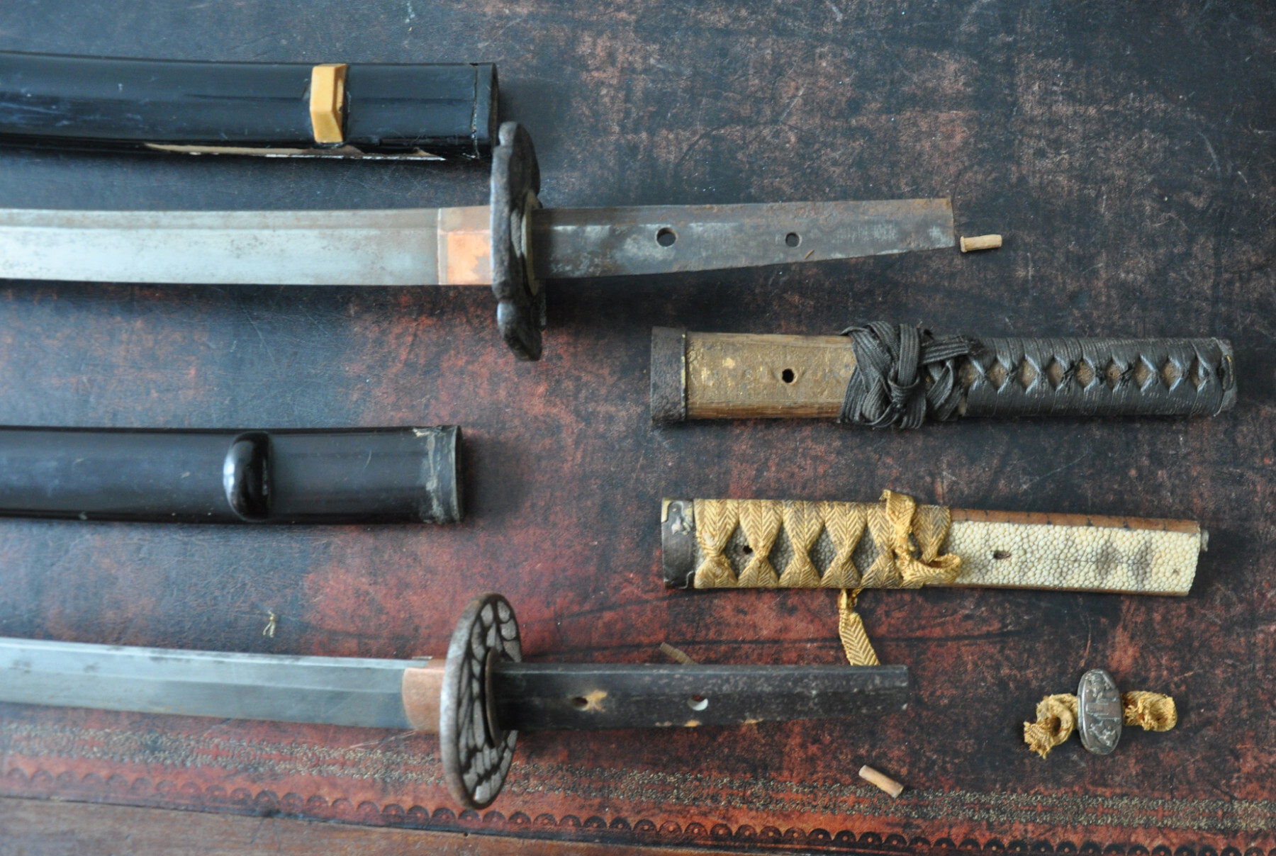

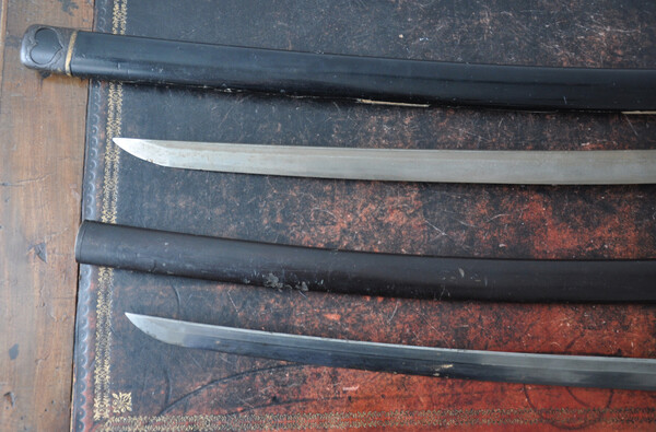

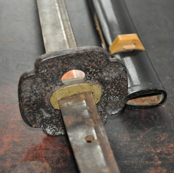

Kubur Posted Tuesday at 05:07 PM Author Report Posted Tuesday at 05:07 PM Hi, I'm sending more photos of the two swords. Thanks for your support and comments Quote

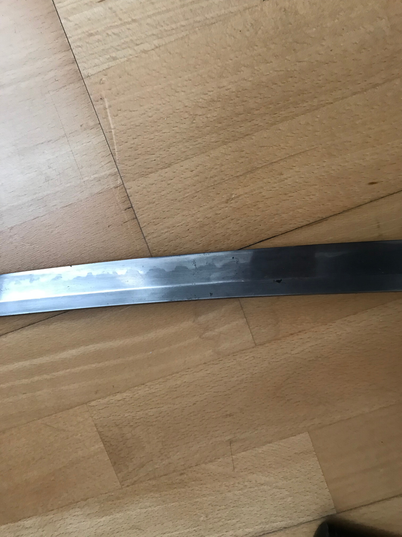

Kubur Posted 8 hours ago Author Report Posted 8 hours ago Hi Guys, More photos as requested, any opinions? Quote
Scogg Posted 7 hours ago Report Posted 7 hours ago Thank you for sharing your blades. Unfortunately, it's difficult to provide meaningful feedback based on the current photos. Because your swords are mumei (unsigned), we must rely entirely on their sugata (overall shape), hamon, hada, and other physical details to offer reliable feedback. I’ve attached a visual guide (see below) outlining how to photograph a nihonto for the most accurate feedback, please: - Photograph the entire blade (sugata) from a straight overhead angle, with the tip pointing north and tang pointing south. - Remove all fittings, including the habaki, to expose the full blade and tang (nakago). Also close-ups of: -The kissaki/boshi (tip) - The hada/hamon (grain/temper line) - The hamachi/munemachi (notches of the edge and spine @ the nakago) - The nakago/mei (tang/signature area, even if unsigned) Against a dark background is best. From what I can see so far, your blades appear to be suriage or osuriage mumei katana with extended kissaki, very likely pre-WW2. However, clearer and more complete images are needed for meaningful feedback. Can you discern a visible hamon in the kissaki area (Boshi)? Cool swords! All the best, -Sam 1 Quote
Scogg Posted 7 hours ago Report Posted 7 hours ago PS... Sorry to ask for so many very specific photos. It’s just the nature of the beast in this hobby Your photos are actually quite well done, but for the more knowledgeable members to give good information: very specific angles and details are necessary. Even then, photographs of nihonto are almost always limited in what they can reveal. Often, the best way to get truly accurate information is to have the sword examined in person by an expert. Best, -Sam 1 Quote
Kubur Posted 5 hours ago Author Report Posted 5 hours ago Thank you very much Sam I tried to follow Jean's tips. However the light is really not great. I will focus on the area that you mentioned. One blade is clean but the other is tarnished. Which kind of products should i sued to clean it and block the rust? Thanks again Quote
Scogg Posted 3 hours ago Report Posted 3 hours ago First and foremost, do not do anything to the tang (nakago). It’s very important that area remains unmolested. Otherwise, just a light cleaning and oiling is what you will want to do. https://www.militaria.co.za/nmb/faq/1-care-and-maintenance/ I would skip any use of uchiko. It ends up causing more harm than good unless you’re very familiar with what you’re doing and have high quality uchiko. Best of luck, -Sam PS. When in doubt, do not hurry. The blades have survived long before we were alive, and they will survive through our lifetime and beyond. So if you are uncomfortable with anything above, don’t feel bad to wait until you can do more research. If Nihonto has taught me anything in life, it’s patience Quote
